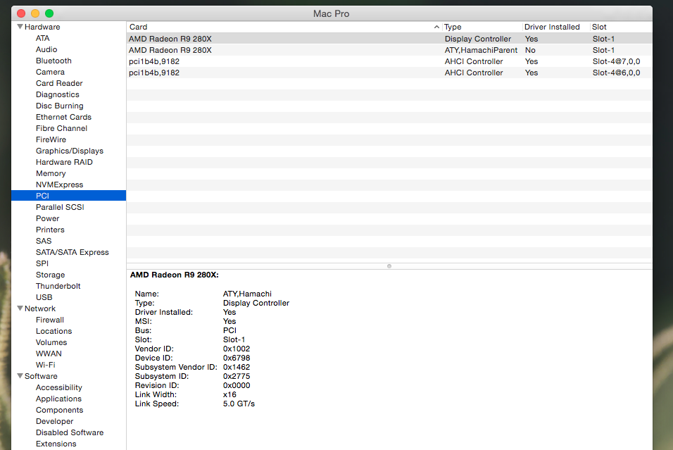

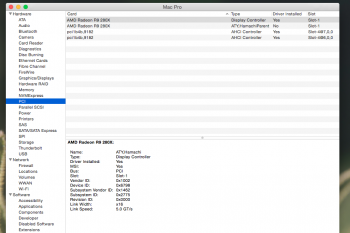

Information on the EBC firmware attached here:
Subsystem ID: 0x2775
Device ID: 0x6798
PC BIOS (stock as shipped): 113-MSITV277MS.350 TAHITI B0 XTL C38650 GDDR5 3GB, BIOS Version 015.041.000.000.003435, ROM Revision 113-C3865001-TU5
Mac EBC EFI: (replaced stock UEFI): ATY,Hamachi, ROM Revision 113-E2080C-101, EFI Driver Version 01.00.624

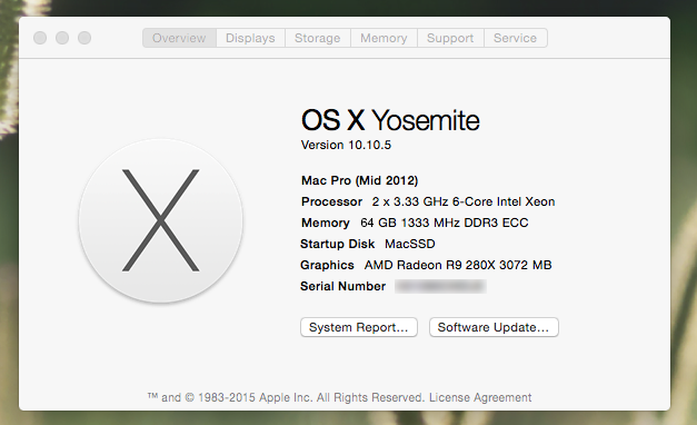

Just wanted to say thanks a million for posting the rom and everyone's hard work that contributed to making this available. I picked up an MSI 280x on Craigslist (exact same card as original poster) for a steal and had the card flashed and running in my 5,1 in minutes. Absolutely painless.
Also, removal of R17 is a breeze...Save for a perfectly timed distraction that caused the accidental removal of R18. Wah, wah, wah was a sound effect heard for miles...Added about a half hour of unnecessary and curse word filled moments under a solder gun. No worries though, all is right with the world as if nothing happened.
