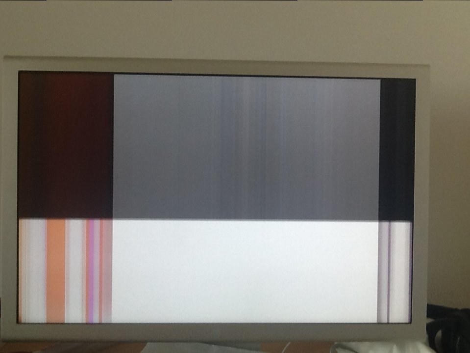

I have the MSI 3G Gaming Version that the OP uses, flashed it using the provided ROM and instructions in this thread, and it has worked great in my 2009 Mac Pro.
Recently however, I have been experiencing heavily corrupted display upon booting. The problem is inconsistent, and I've tried restarting, SMC and PRAM reset, all multiple times, and cannot seem to pin down a pattern.
I'm using one of the older aluminum apple cinema displays (http://www.everymac.com/monitors/apple/studio_cinema/specs/apple_cinema_display_23.html) connected to a monoprice MDP adapter (http://www.monoprice.com/product?c_id=104&cp_id=10428&cs_id=1042802&p_id=12744&seq=1&format=2), and as long as I unplug and replug the MDP cable the problem is fixed.
I tried going directly into the DVI port on the GPU as well, without the adapter, and found the same problem - again inconsistently - so I don't think it's the adapter.
Image of the corrupted graphics is attached. Any ideas? It might have started with the upgrade to Yosemite, but I really can't recall since it is
Thanks in advance!

@stmp, did you perform the resistor removal for PCI 2 speed?
Is there a specific reason you're using that adapter? The card is fully capable of driving the DVI signal your display lusts for.
@rawweb, thanks for your reply-
No removal of the resistor for PCIE 2 speed, only using the adapter for when I want to connect the Display to a Macbook Pro. I tested with and without the adapter and the issue persists, albeit inconsistently.
Any chance you have access to a non Mac desktop to test the card in? Just curious if it's related to something with OS X.
Also, did you save the original rom? You could always revert to that if you suspect something with the flash is botched.

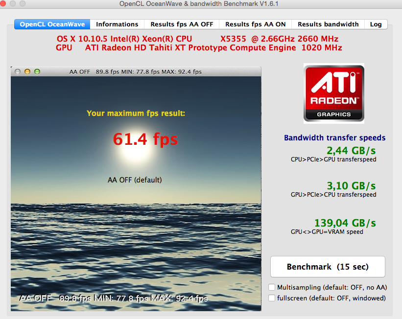

Hi guys, after reading a lot in this forum and netkas i finally decided to buy the MSI R9 280x for my mac pro 1.1.
I´m in yosemite 10.10.5, today the card arrived. Plugged all, power up and it works. "but" .
I run benchmarks from my previous hd5770 and i compared with the x280 and the only improvement has been unigine from 654 to 1300. But in luxmark i have a score of 11 points... Cinebench , same as the 5770, bruce x was 10 seconds less that the previous car,. and in oceanwave i have the same score as the 5770, 60fps.
i think something is wrong, any one can give me a little of advise on this.
I have removed appleintelcpupower and applintelcpupowerclient as i have read in nets. but no luck.
The card is stock
Help please!!!
So, unigine confirms that OpenGL works on your 280X.
BruceX confirms that OpenCL works.
Luxmark obviously is not working, but not just poor performance. Did you face the same problem regardless if you are running V2 or V3? V3 seems not working well at this moment. Also, did you try different scene?
Cinebench is bottlenecked by your CPU's single core performance. There is nothing you can do about it. It never a good benchmark for GPU.
Vsync cap your FPS at 60 in oceanwave. it's not your card's problem.
If you want more GPU benchmark, try GFXBench, they offer both OpenCL and OpenGL benchmarking software.
!!! Nice sir!
Thank you very much for the quick reply!
Now i can understand some things. Right now i´m editing some RED 4k RAW footage, and its working great, rendering times are much much quicker.
I tried Lexmark v2 and it worked great, now it´s showing the same results as everybody.
I have just done the flashing, really easy to do if you have a windows machine, 3 clicks and you are done!
About the r17 thing, i benchmarked before and after and didn´t see any improvement but i have it done as you all!
Thanks all for the support, great forum!
On a Mac Pro 1,1, remove R17 shouldn't make any difference, but it's good to get it down, which may be useful in the future.

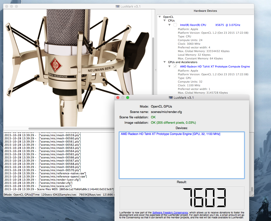

... running [LuxMark] V2 or V3? V3 seems not working well at this moment.
Actually there is progress in LuxMark 3.1, the Neumann mic medium scene is working well now. This is on 10.11.2 beta (note the OpenCL version date) with a Gigabyte 280X
Luxmark 3.1 & 280X : OS X 15C27e.png
BTW don't try this with a Maxwell card.. 😉

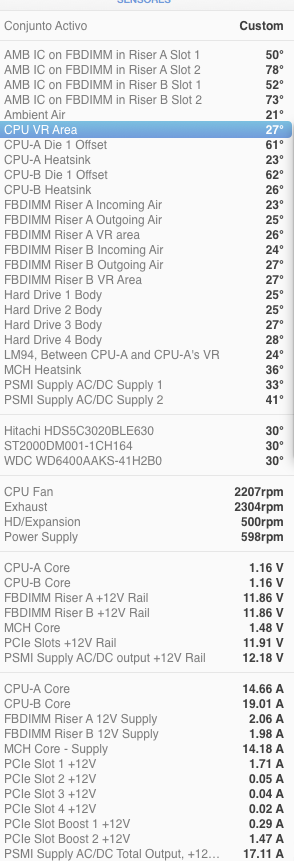

Guys, weird thing here.
Today arrived 32 gb of memory for my mac pro 1.1.
I test them, all well, mac sees it, did some benchmarks all well, i was editing for a while when i read that those ram should have those big heatsink, this haven´t.
So i swapped the heatsinks with the other 16g that i had been using.
Afther that the mac powers up and just in the log in the fans started to rev all the way in. There isn´t any cpu work or anything and with istats i can see that the temperatures are quite low. I opened the side lid and all its cold, even the air that comes out of the exhaust.
I did PRAM reset, and SMC reset, no luck, I swapped to the previous ram sticks, same thing fans revving high.
Any ideas?
