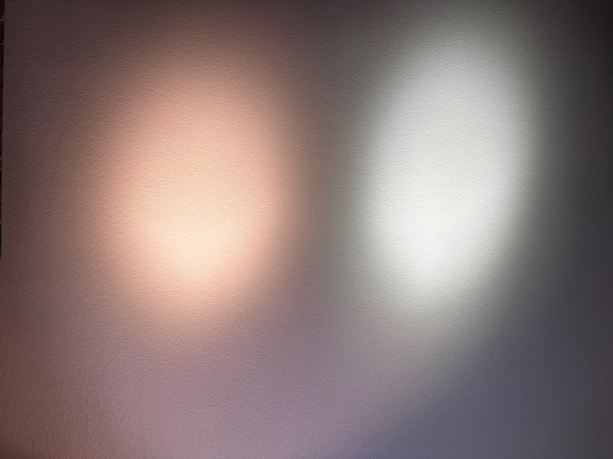

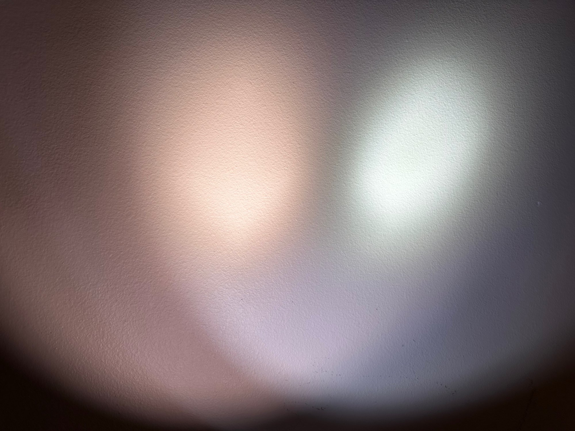

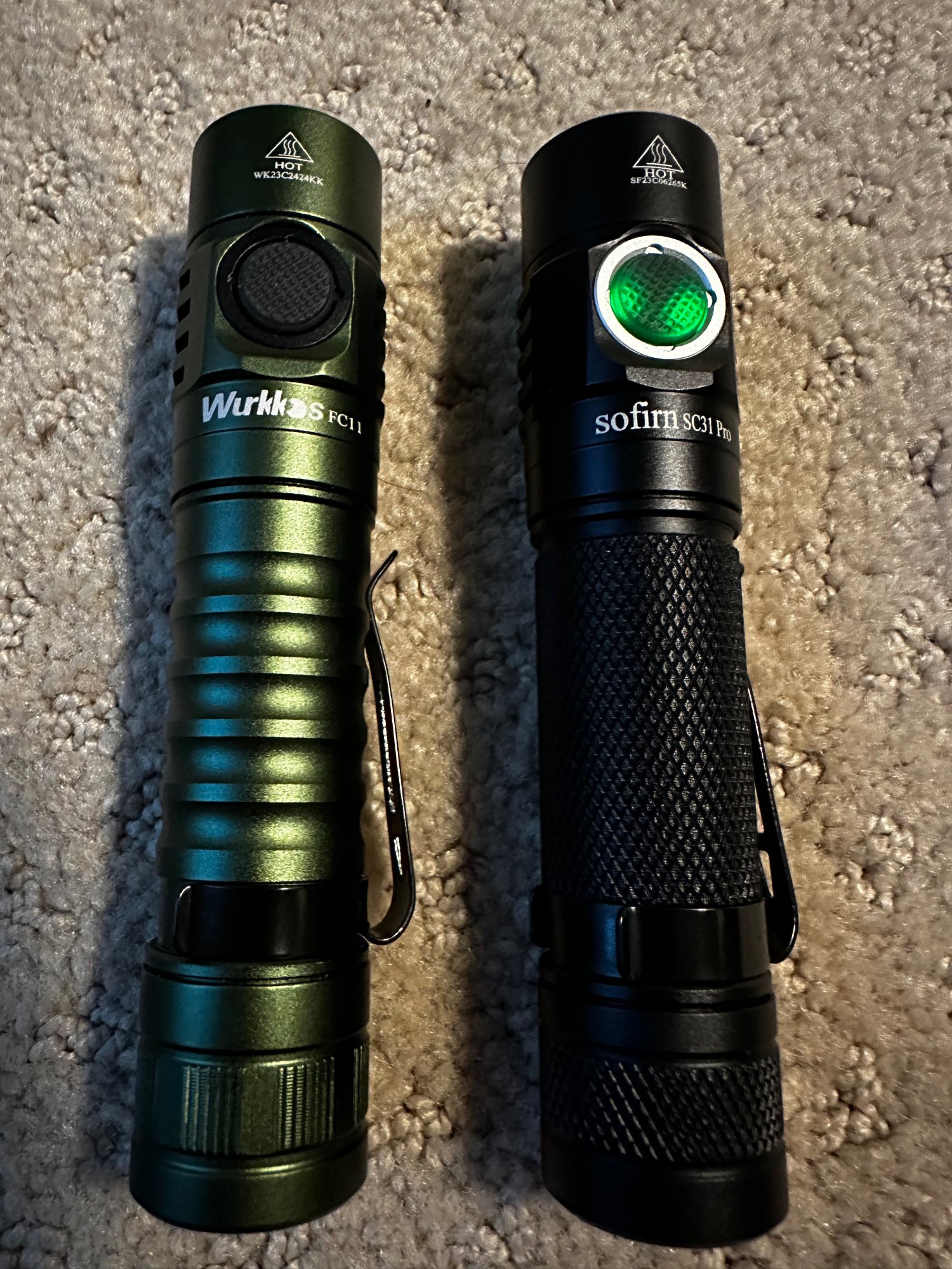

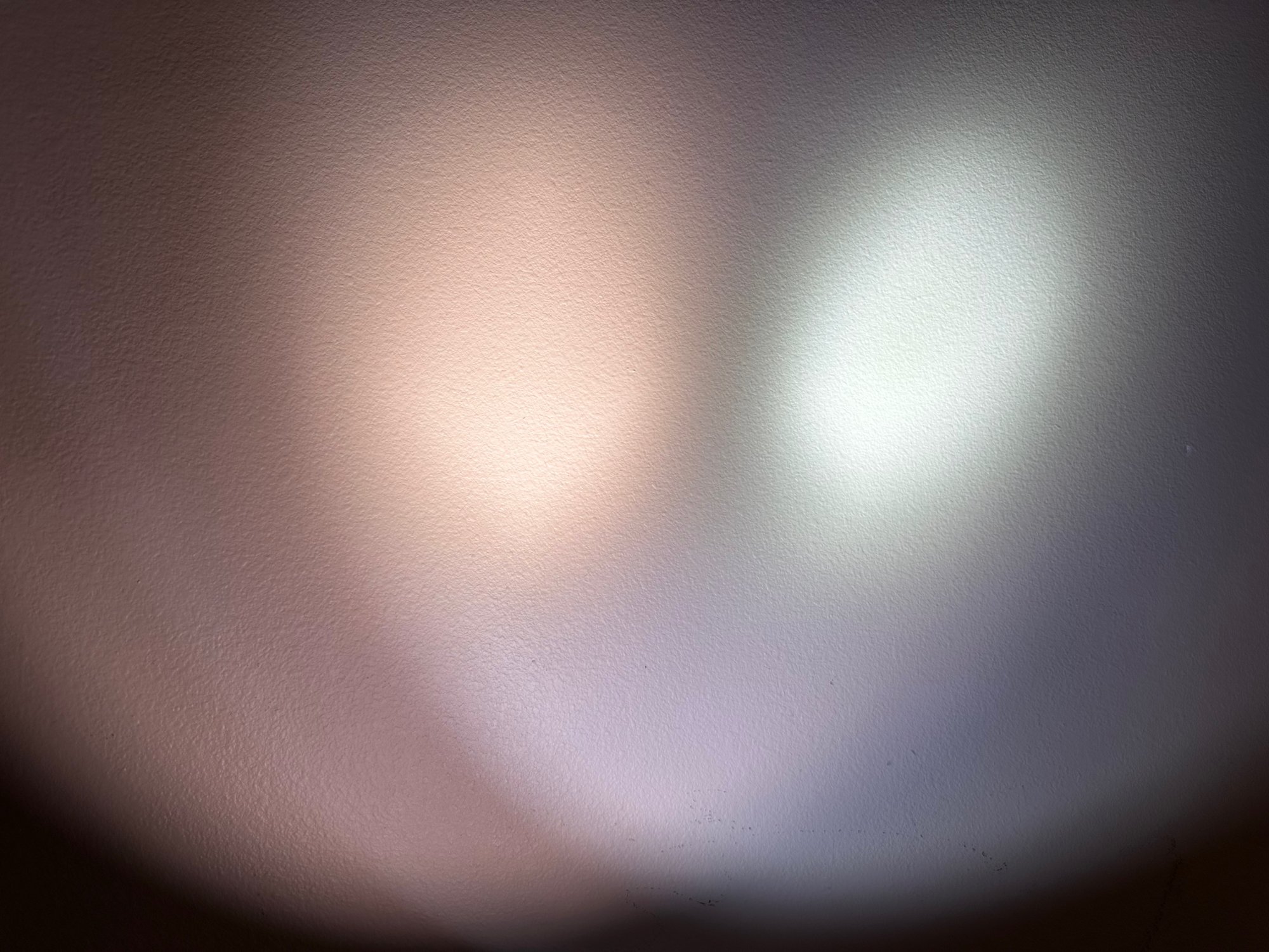

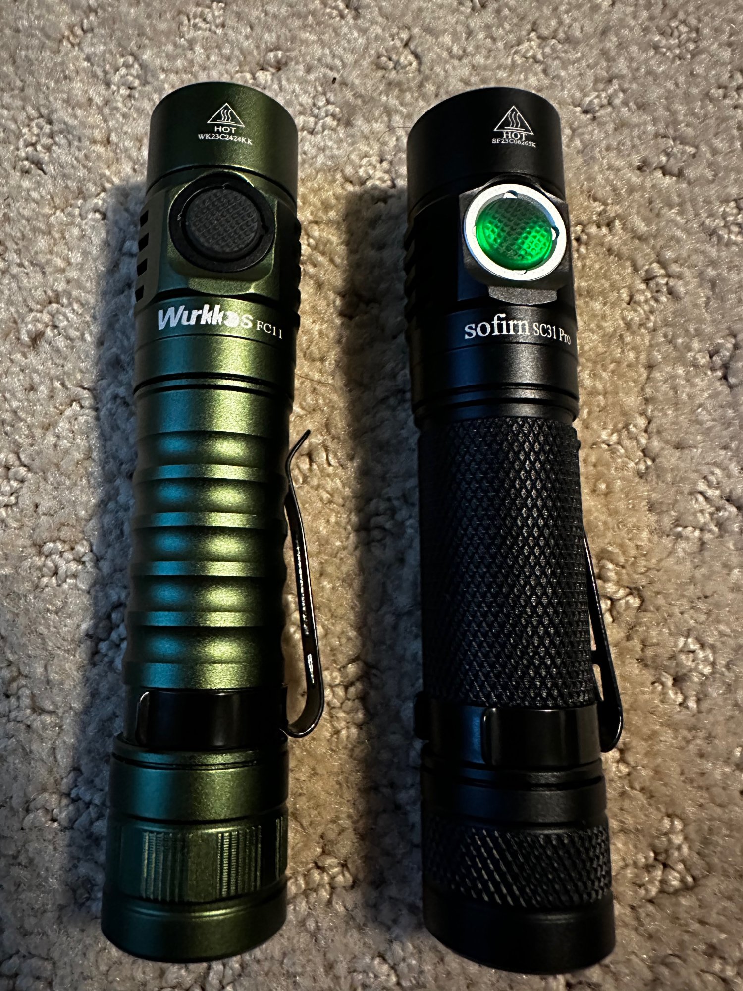

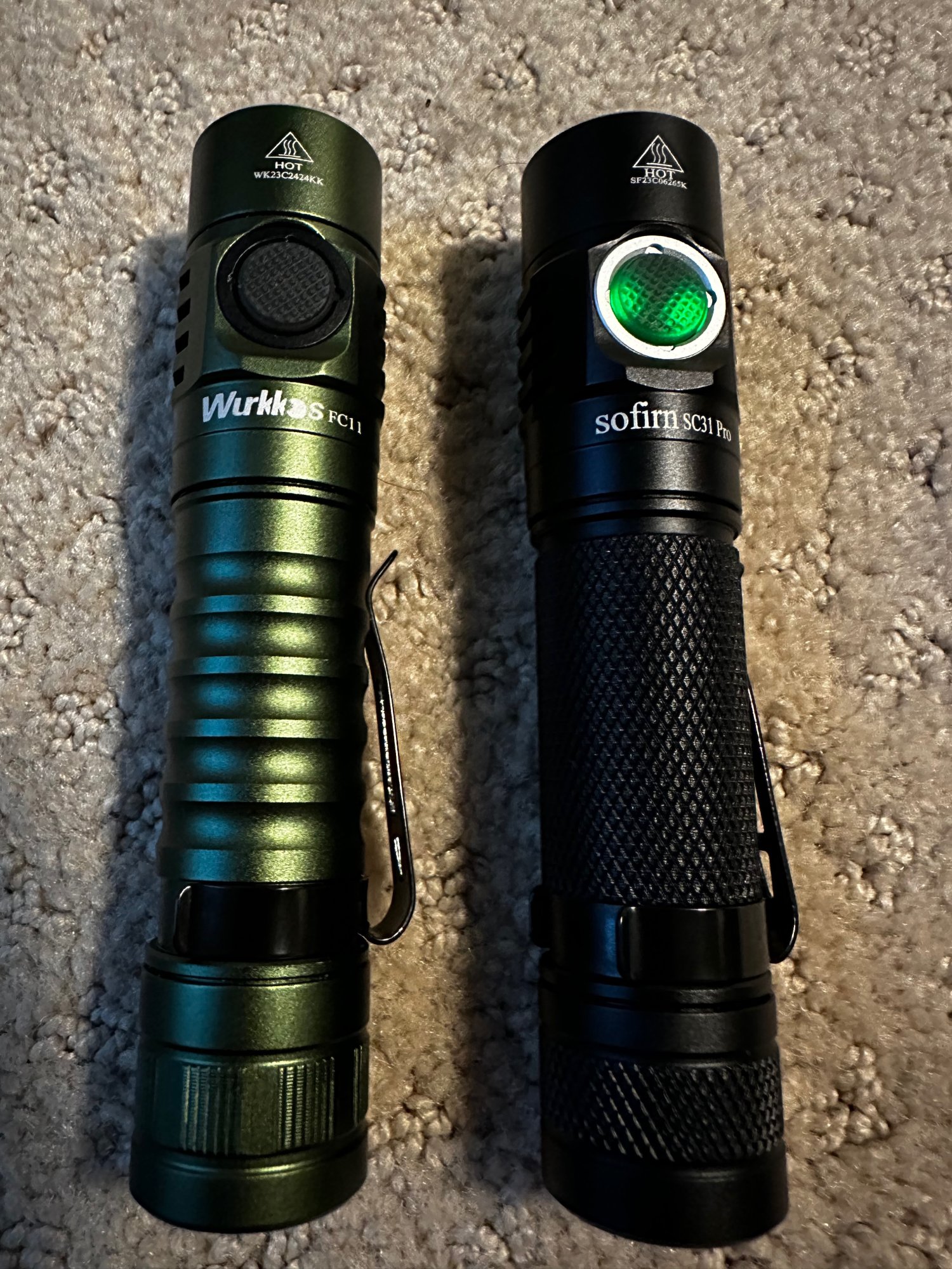

Wurkkos FC11 4000k (left) vs sofirn SC31 Pro 6500k (right)
TLDR: I much prefer the FC11's warmer light (I'd describe it as cream white) but I like the build quality/design on the Sofirn better. Really like the green LED that is always on the SC31. (Not as yellow in real life!)

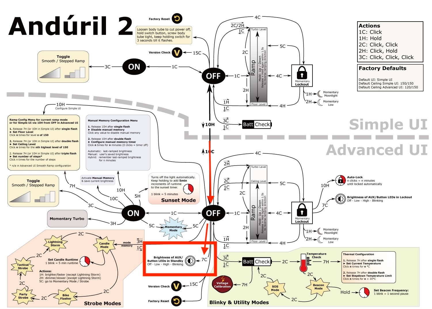

Learning how to use the FC11 took a little bit of getting used to. But once I learned how to use that, using the Sofirn was easy as pie (at least for basic operations). The SC31 can get a lot dimmer than the FC11 at its lowest setting and it is noticeably brighter at its highest setting, but wow does it get really hot really fast - like start a fire hot. (FC11 does too but not as rapidly at highest setting).
Despite the FC11 being 1300 lumens, the SC31 at 2000 lumens is *much* brighter (in real life it is far more noticeable than how the iPhone captured the turbo modes below) - I wouldn't say 2x brighter but 1.5x at least:
I believe the SC31 can charge faster if you have it plugged into a charger that can give it exactly what it wants. But it gets pretty warm while charging at this rate.
Note that both lights can be used while plugged in but you have full usage with the SC31. The FC11 just turns on/off while plugged in (can't do anything else), the SC31 can do everything as if it was unplugged when plugged in (change brightness, high mode, etc).
The manuals (especially the SC31's) need a magnifying glass to read. The SC31 is an entirely different animal vs the FC11. Think of an entire computer in this thing - so many things you can do, modes, settings. So if that interests you, spending a little more for the SC31 is a must.
Both lights came with a USB A to C cable, a lanyard tie for the back, and 2 rubber seals for the waterproofing at the screw-in points. I used my MacBook USB C charger and an Anker 60w USB C charger to charge them successfully. First charge on FC11 took 4+ hours. First charge on the SC31 took 2.x hours - but it got really hot so I moved it to a slower charger (took about 3 hours total).
Spend the time to get to know these lights. Watch some YouTube videos on them - you'll learn some things that not even the manual includes. lol.
One of the reasons why I got the SC31 was that I read it sustains it’s output as the battery drains whereas the FC11 dims as battery gets closer to empty.
Conclusion
The Wurkkos FC11 is my favorite - I'll be using this indoors and in my backpack.
The sofirn SC31 Pro is a close second. Feels more secure in the hand, is much brighter - I'll be using this when I go on walks, need something a bit higher powered, etc.

question about the blue one, the Sofirn SC31Pro if you have that one
it has a cool small soft green LED on the side, like a "locate me" light for the flashlight
Do you keep that on? I'd guess they designed it to draw almost nothing but it's still gotta be using some battery.
I'm sure I could un-screw the end enough to turn off the light.

I set it to dim mode, and physically lock out by loosening the tail cap, since it isn't in daily use and sits inside a drawer much of the time.
Not much difference in idle drain between dim and setting it to be completely off. But both are substantially lower than the "normal" mode, where it has been measured to draw between 1 and 1.5mA, versus 0.09mA on dim.
Physical lock out will cut it down to the cell's own self-discharge rate.
Still a good idea to do periodic voltage checks, and retire any cells that have been mistakenly deep discharged.
