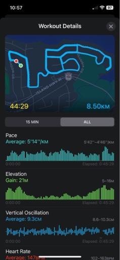

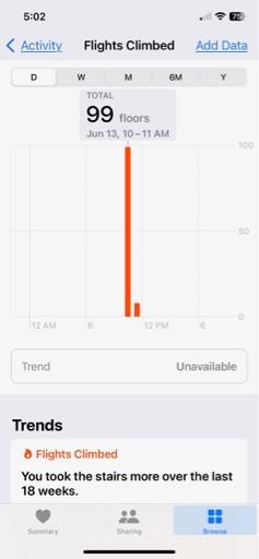

Has anyone else noticed their flights climbed ready has gone up by large increments? I live in a one level house about 10 meters above sea level. I went for a run today on a route I’ve run for the past 5 years. For some reason it shows I climbed the equivalent of 99 flights. When I checked the data records on my phone it showed one section where I gained 29 flights in a 10 minute span. I compared the data input time to where I was on the route and according to the fitness app I went from 3 meters to 9 meters in a gradual rise. I’m not sure where the 29 flights came from but by my math that’s the equivalent of 87 meters. Looking back over my activity summary it appears to have started around March of this year. For reference I’m using a AWU with watchOS 9.5.1.

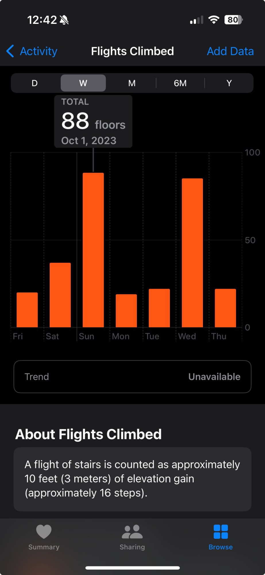

I have this issue on my AWU since I got it. I’ve sent it in for service twice and it’s on its way back again with no resolution. They “could not reproduce”. I’m big mad.
Like you, it happens while on a running workout. I’m registering 50-150 flights a day when my real count was more like 20.

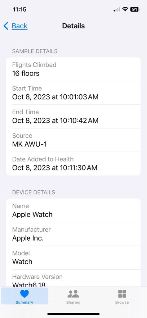

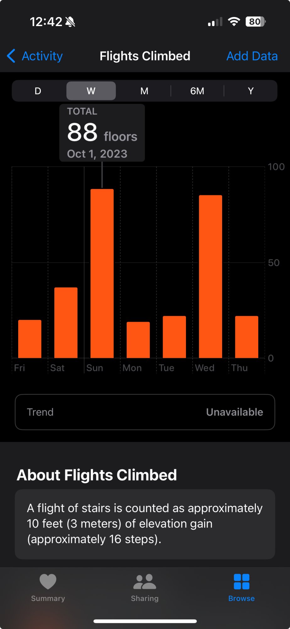

Here’s a screenshot of the flights climbed data from this morning’s run. It shows 16 flights climbed between 10:01 and 10:10. Crazy thing is I started my run at 10:05. The time from 10 to 10:05 was just standing around preparing to hit the road.
The total flights climbed was 60 after the run…..

Yes, but why only during runs? I live pretty much at sea level and the elevation shows the same before and after. Not discounting the theory as sometimes the elevation reading is incorrect. (There’s a thread on that issue as well) Also it doesn’t affect my AW8, runs on that show 3-4 flights climbed.
I'm sure we have the same issue. It only occurs on runs with my AWU1, not my AW series 6. I will let you know what happens when I get my watch back tomorrow (second service attempt).

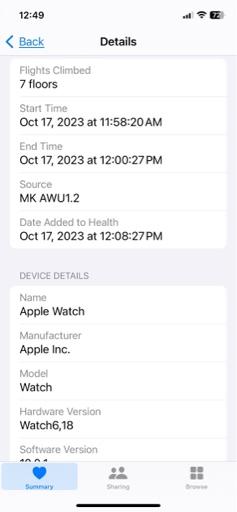

I followed your instructions and went for a run this morning. The good news is it only recorded 21 flights climbed. That’s on track with what the AW8 was recording when I was using it. It’s still out of whack though. It recorded 7 flights climbed in a 2 minute span when I’m absolutely sure I just standing in the kitchen contemplating lunch…..

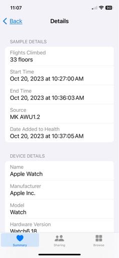

Same result here, 9 km run this am. AWU recorded 85 flights. Again curious data, I started the run at 10:10 and the first flights climbed was recorded at 10:27 to 10:36. This was one of the flattest sections….maybe 5m above sea level.
