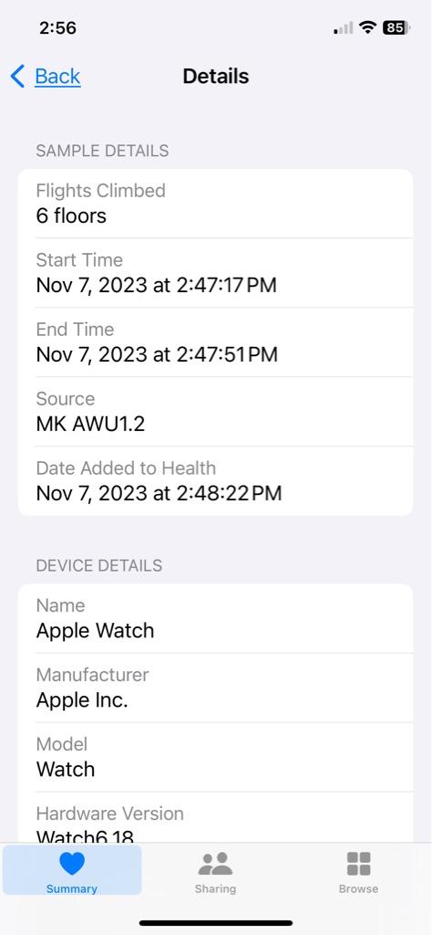

Digging deeper into yesterday’s run. Flights climbed was 60. In the “show all data” section I saw this one recorded.
6 floors in 34 seconds!! That works out to 18 meters or 60 feet. Looking at the run map and times I believe I was running on a fairly flat section of road around 10 meters above sea level at the time the data was recorded.

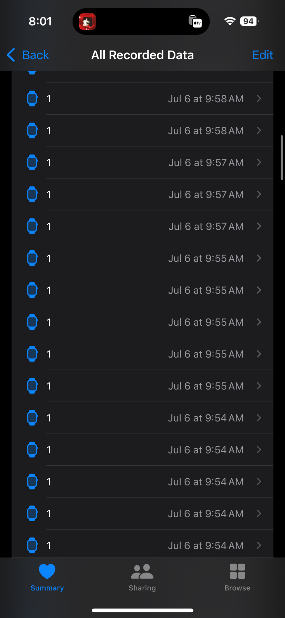

Just updating that even on iOS beta 4, my problem persists. I did a 12 mile run yesterday in a totally new location and logged 322 flights climbed. During some runs, it will log many batches of 10-40 flights, and other runs it logs each flight one at a time. The latter makes deleting them impractical.

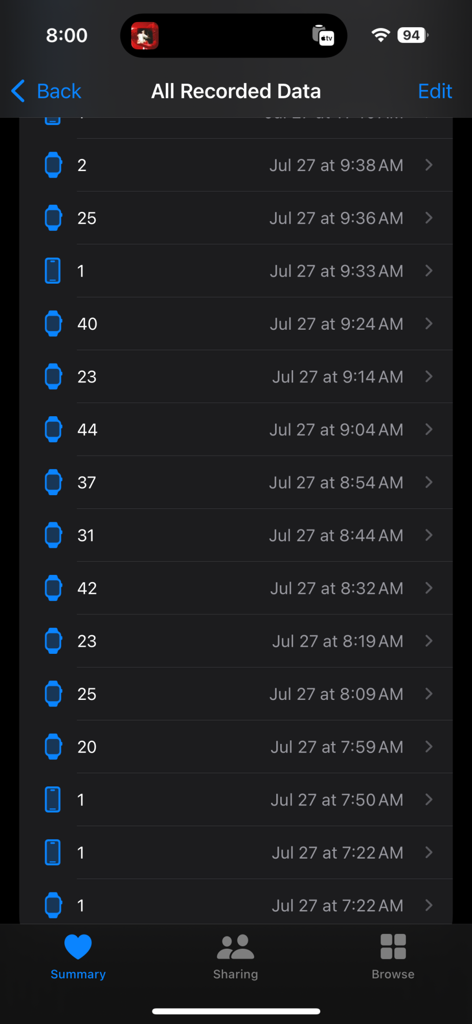

Still an ongoing issue. This is from yesterday, 49 flights climbed in a 16 minute period. All I was doing during this time was walking back and forth from the shed to the patio putting out the cushions on the furniture. No elevation changes, no jumping or rapid arm movements. Just walking back and forth across the lawn. Weird…
