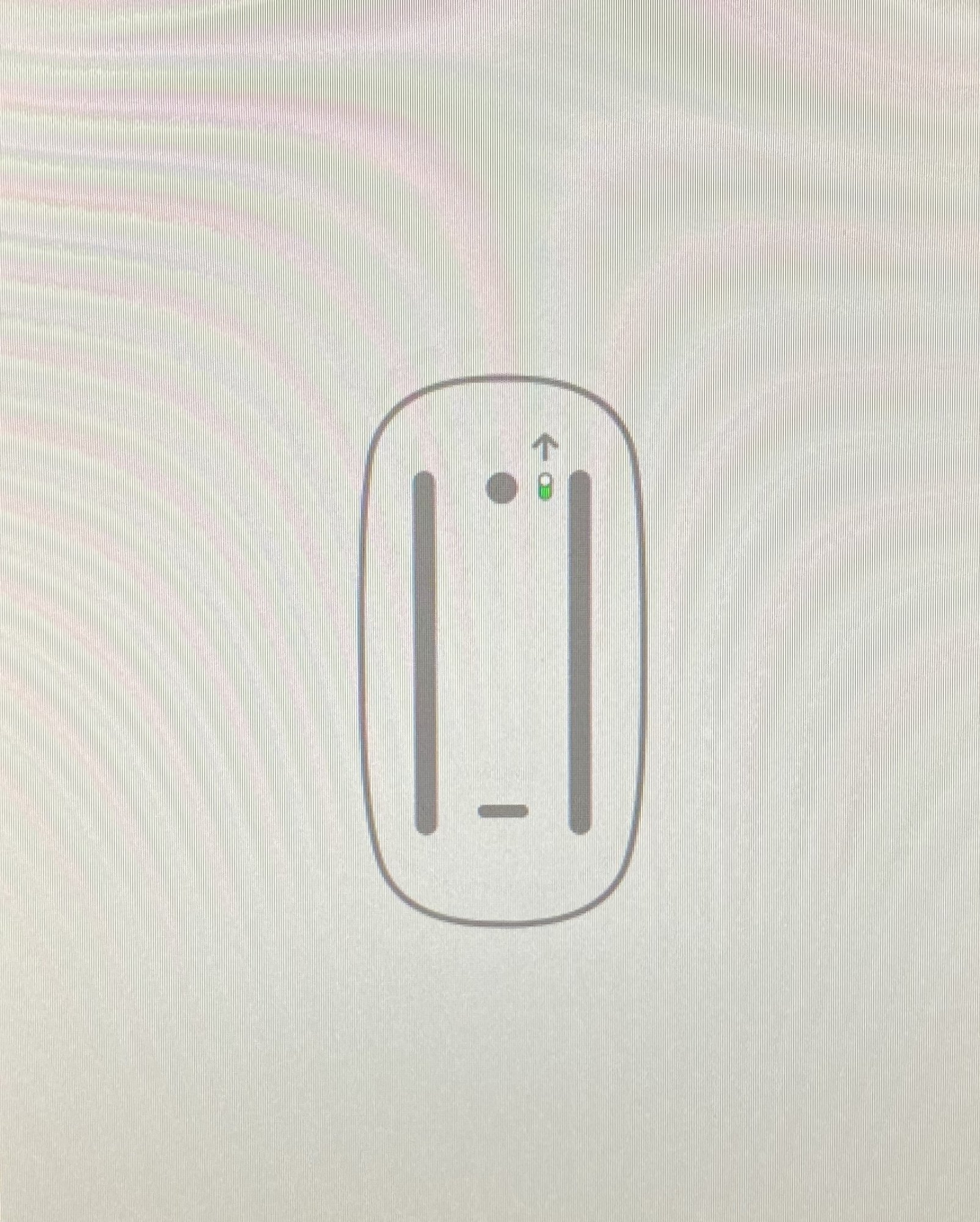

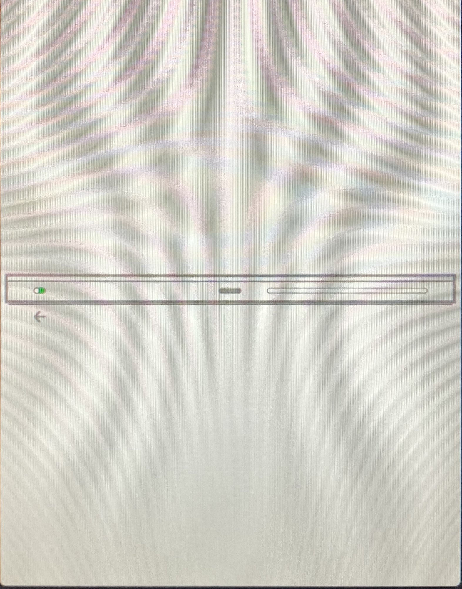

I have tried 3 different monitors and tried DVI and HDMI and USB C connection combinations and I always get half way through start up and then the Spple logo and start. At turns from white to green and then slowly toggles between the two drawings of the laptop and desktop with their power buttons highlighted green.
I still have not successfully completed my initial boot.
[automerge]1580991209[/automerge]
To my untrained eye it almost looks like the mini goes into some type of power save mode half way into start up?

Replacement mini arrived today.
Used 3 different types of new cables.
And here are the results.....
just toggles between these two drawings .
D’oh !!!!
