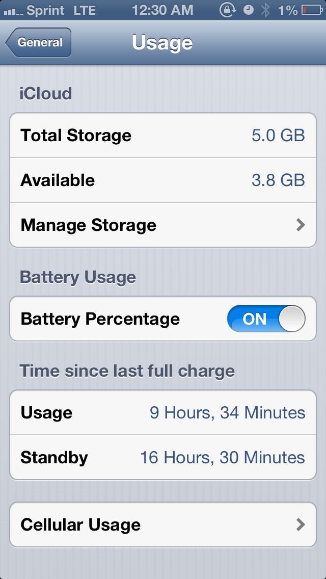

This time my iPhone 5 replacement came with iOS 6. Thank god! The image below is what iPhone 5S users are rated to get. 😀
