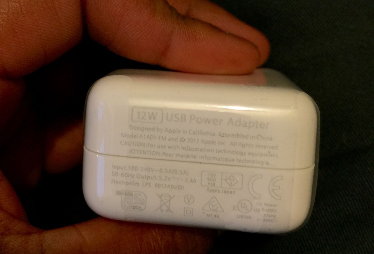

I figured this would be a good time to make this thread. I purchased a 12 watt charger in order to speed up charging times with my 6+.
However, I started having doubts of the legitimacy of this charger. So I took it upon myself to open it up, and behold:
Now, can anyone tell me if this charger is legitimate or not? It passes all the genuine checks on the outside. "Designed by Apple in California Assembled in China", and spelling is correct, all signs and logos are present, USB port looked normal.

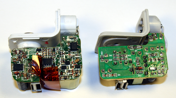

This is a comparison of legit vs fake (Left is real, right is fake)
This is where I get lost. The top of the circuit board on the one I have looks exactly like the genuine charger I have. Meanwhile the back of the circuit board looks like the fake charger that's above.
Also, I am not sure if the 5W and 12W are built differently. The images above I believe are from a 5W. I purchased a 12W.
There's a bunch of things that add, and yet, simple things like the USB serial aren't there.

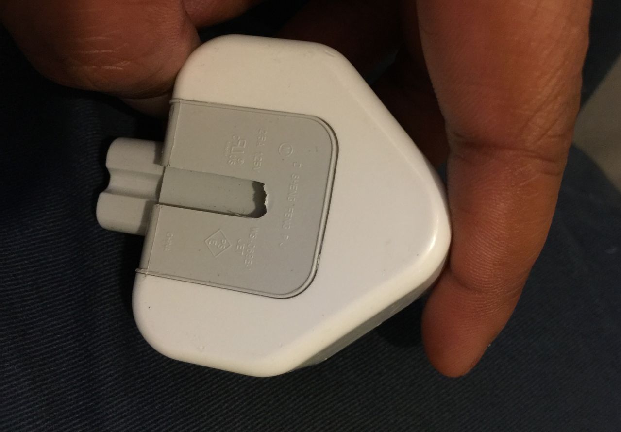

Looking at your pictures more, the international adapter definitely looks like it might be a knockoff. The charger itself looks identical to mine

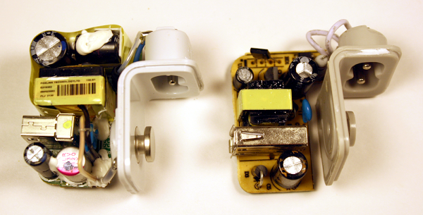

Looks the same as my genuine charger (bought direct at a US Apple Store):
But, that isn't a guarantee that yours is genuine. If someone has the equipment to make plastic molds that look like Apple chargers, they can probably screen-print text that looks identical, too.
I think the bottom line is, if you want to save money, you should get a charger from someone hat spends money to be MFi certified so the internals are quality, even if their charger looks different. Rather than buy from someone who spent all their money making the outside look like a plausible Apple knockoff.
It's fake for sure, look at the amount of components lacking on the bottom.
The top of the circuit board also looks pretty different, there's a big diode on the bottom with a single electrolytic capacitor, that doesn't exist on the real one. Capacitors are important for filtering, lesser capacitors generally mean a less clean output, which would be expected of a fake one when it comes down to manufacturing it as cheap as possible.

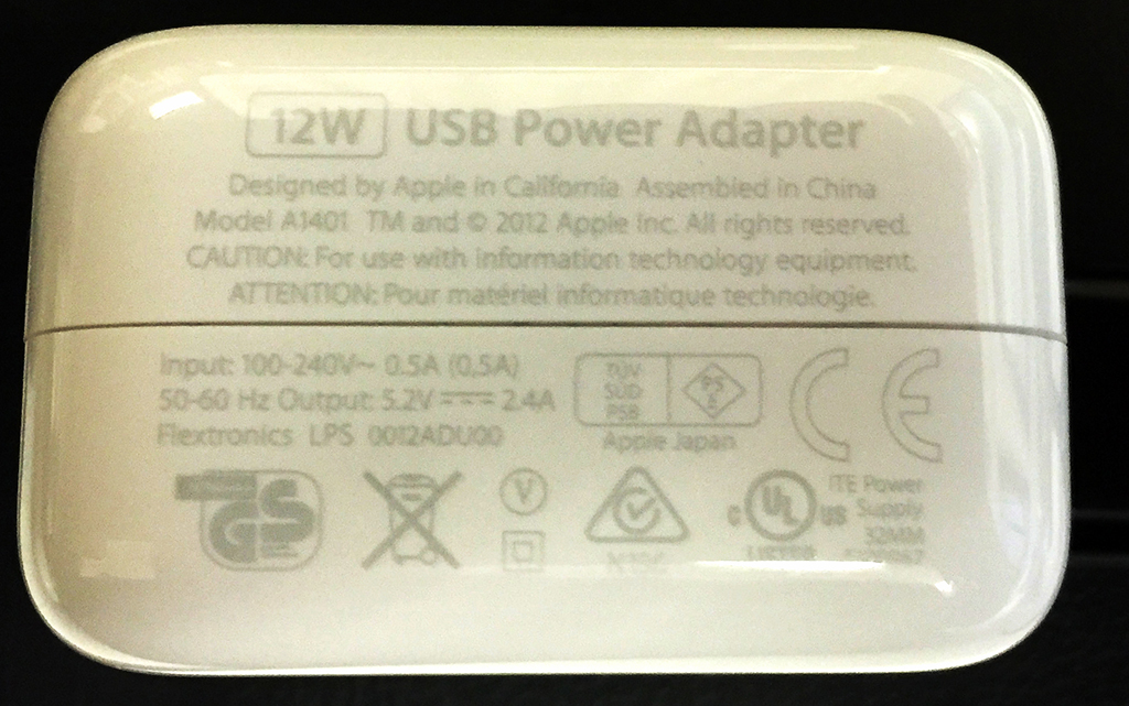

This power adapter and the plug are fake. The font is wrong on the adapter and the plug has obvious issues.
Have a look at the one above - the font is heavier and more consistent.

http://www.righto.com/2014/05/a-look-inside-ipad-chargers-pricey.html
That article was perfect. I already got my refund for the charger so no worries.
