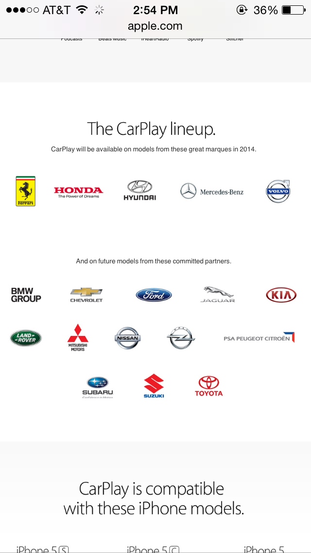

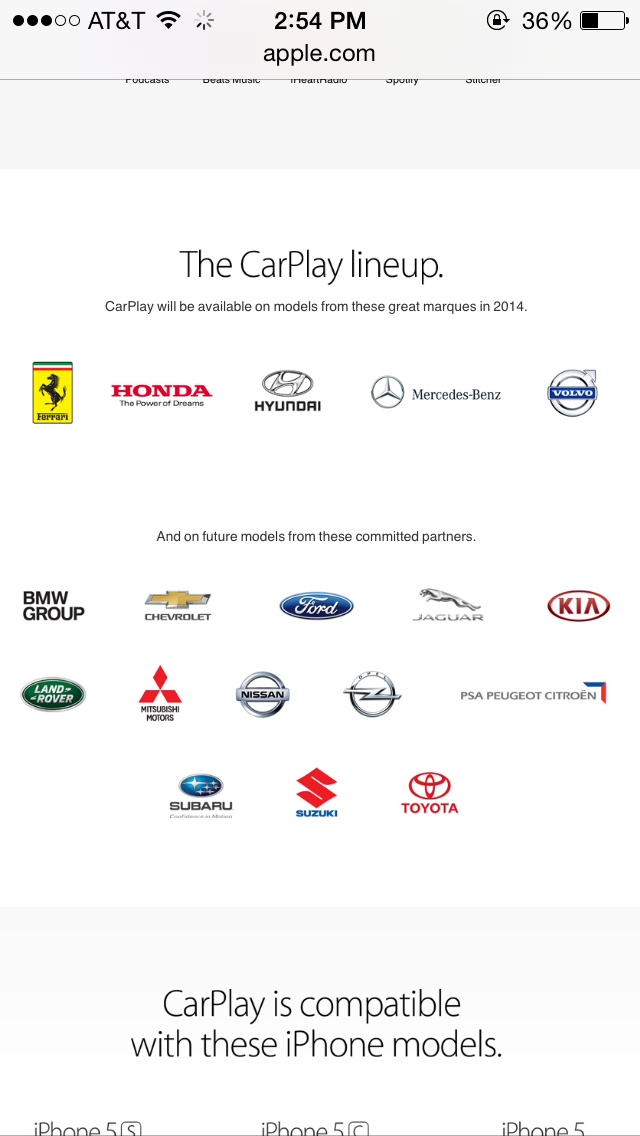

Cool! Do you have a link on the CarPlay announcement?
Ford Sync with iOS 7
http://www.apple.com/ios/carplay/
Excellent! I admit that I haven't paid any attention to CarPlay before. I've only had this new car for a couple of months and the previous vehicle was a 2003 F-150 which had no new-fangled technology in it.
Same thing with me! Really excited that ford joined in. I assume when the time comes us existing MFT users will have to a download it similar to how we upgrade the software.
