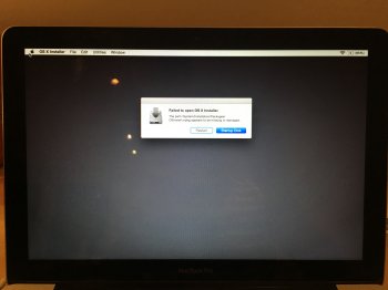

I attempted to upgrade my wife's MBP to El Capitan, but have not been able to install the new OS. Since it downloaded and installed I am unable to progress past the final installation screen once the machine reboots as it reports a disk error.
The recommended restart and quitting the installer result in the same cycle - machine restarts and loops back to a disk error. How can I get past this? I don't understand how I can make an external boot up disk if I can't logon to my computer to download El Capitan to an external drive.

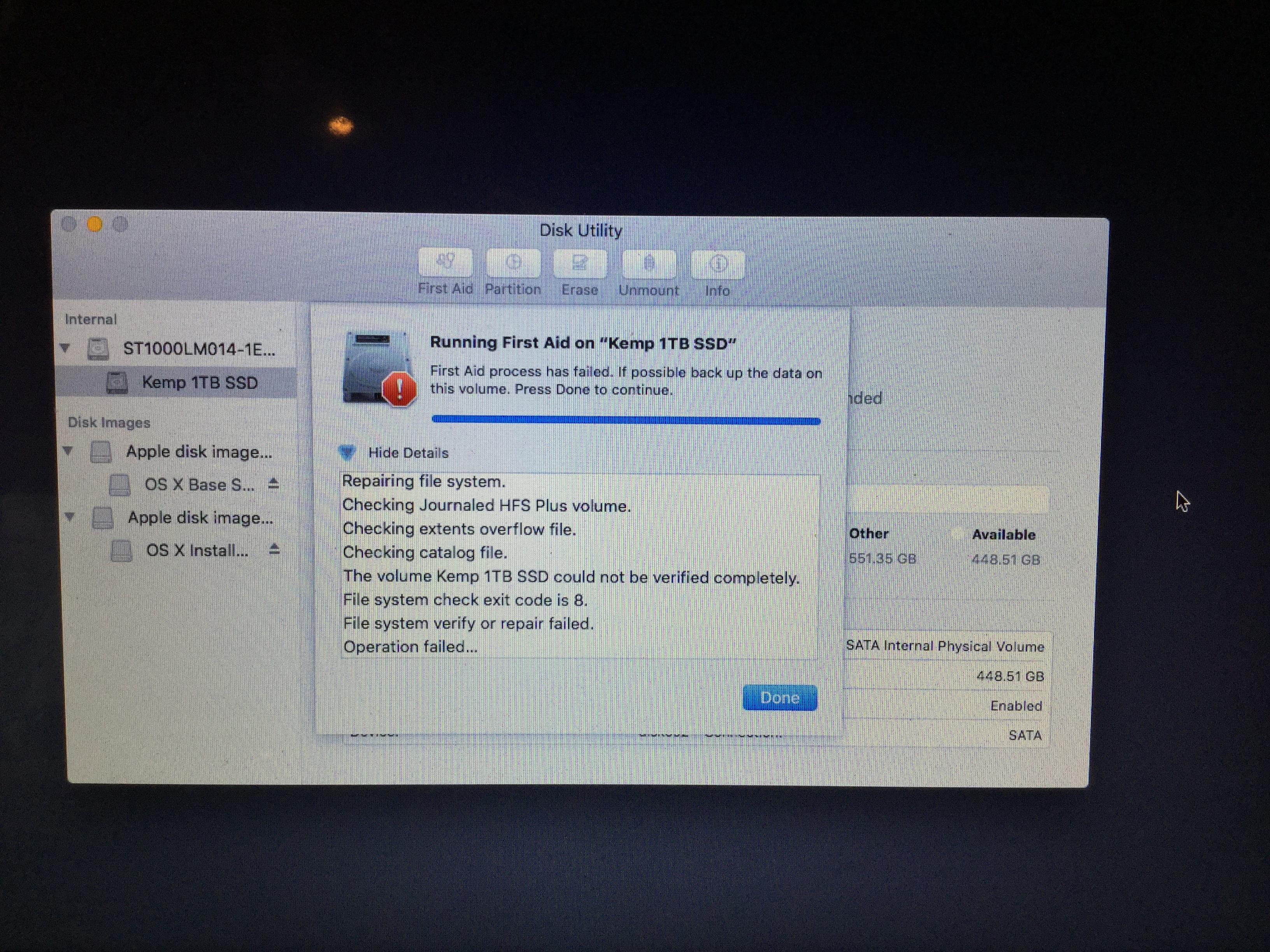

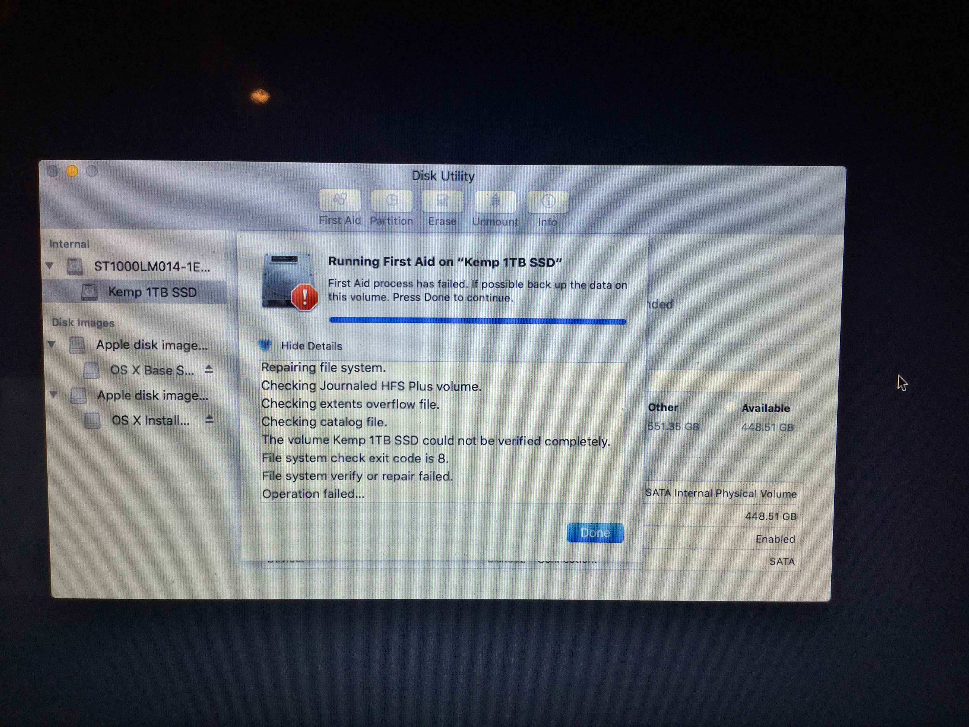

I was able to enter disk utility from the OSX installer screen, and then run First Aid on my drive. It failed and showed the attached error ehen I ran it on 'KEMP 1TB SSD', but runs perfectly if I use First Aid on ST1000LM014...
If I choose to format the drive from this screen, won't it wipe the OSX installer as well? I'd prefer to get this drive working if possible as installing the old drive would involve me having to setup my old user profile and then transferring all of the data again.

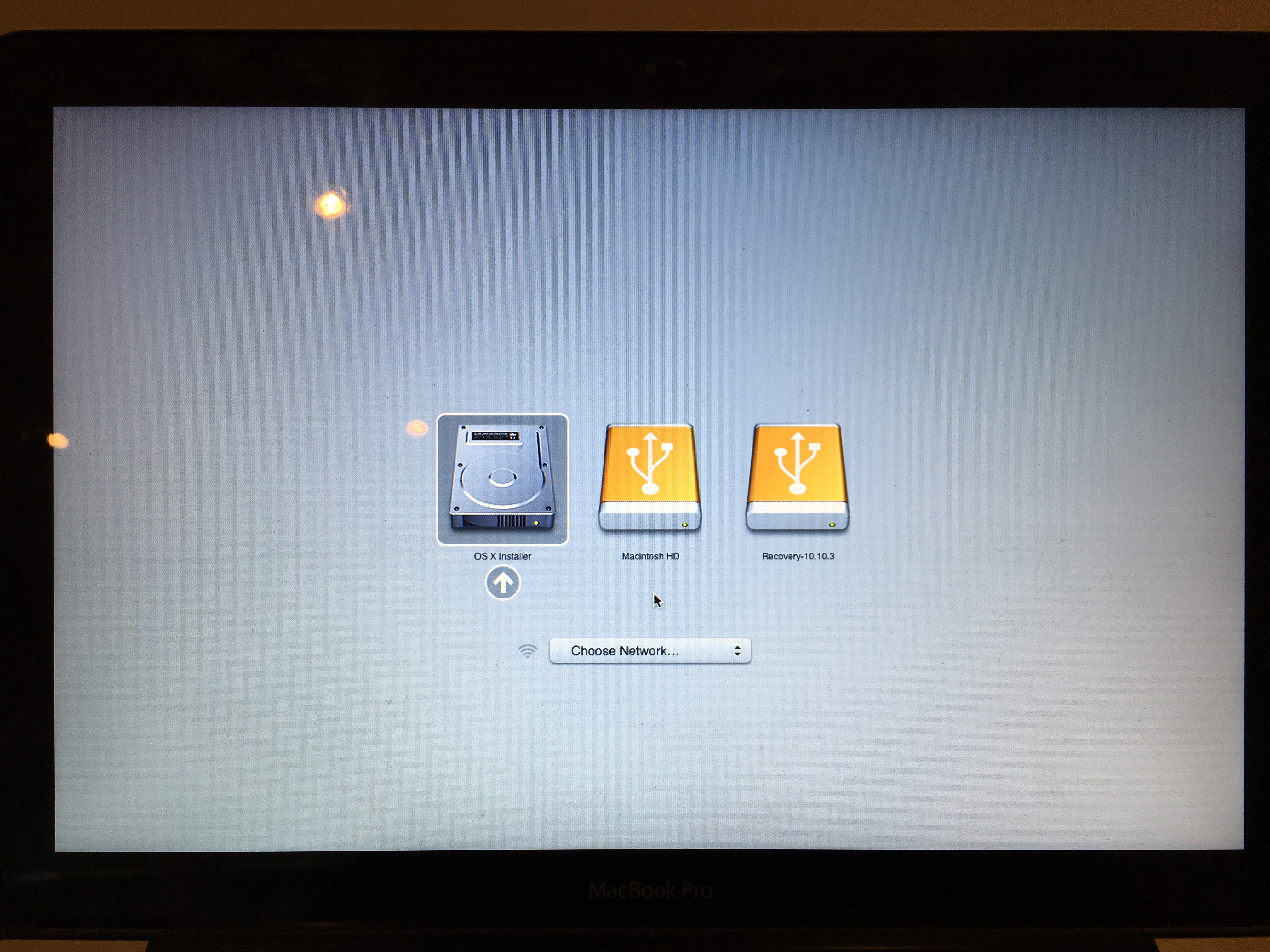

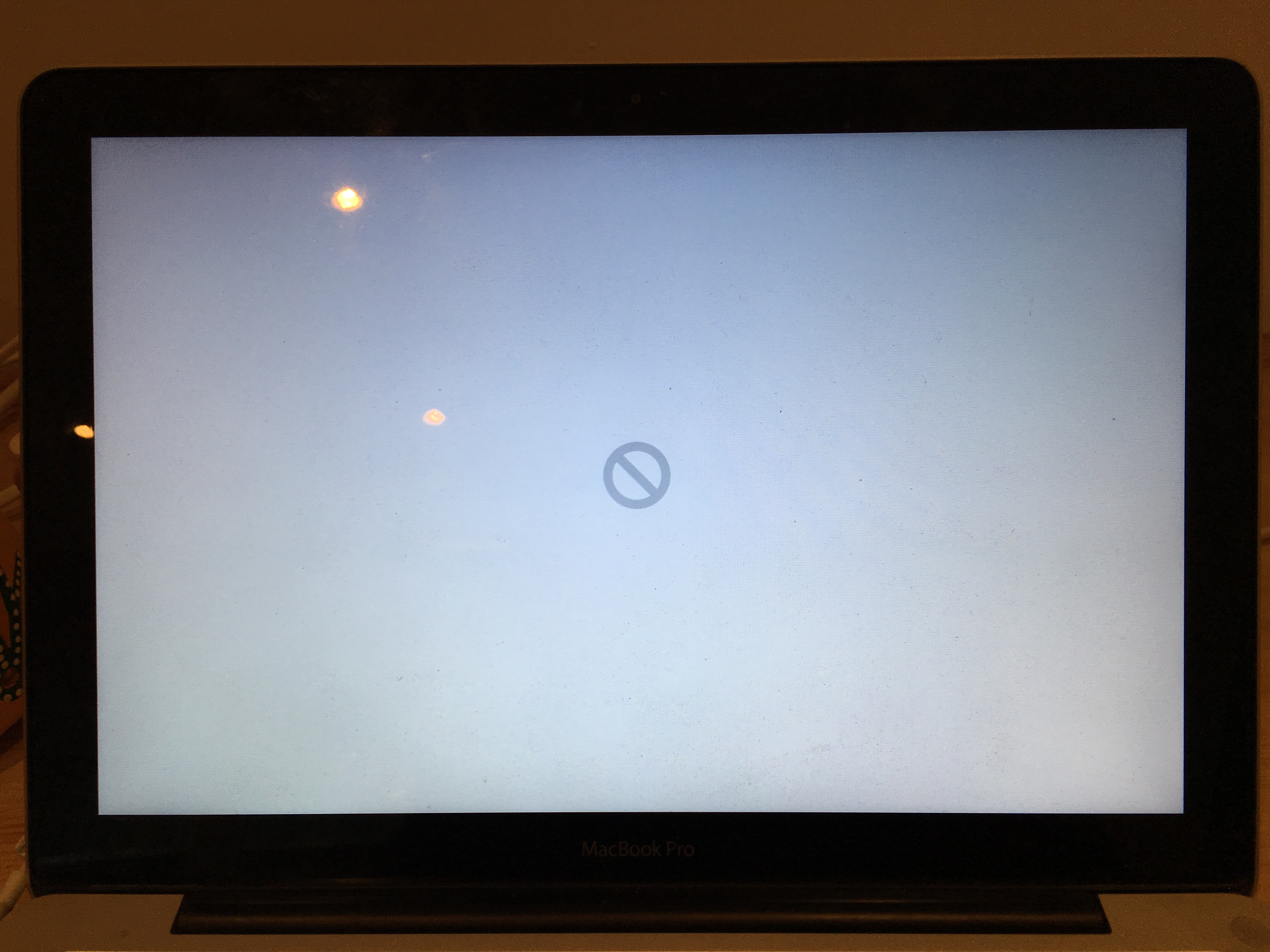

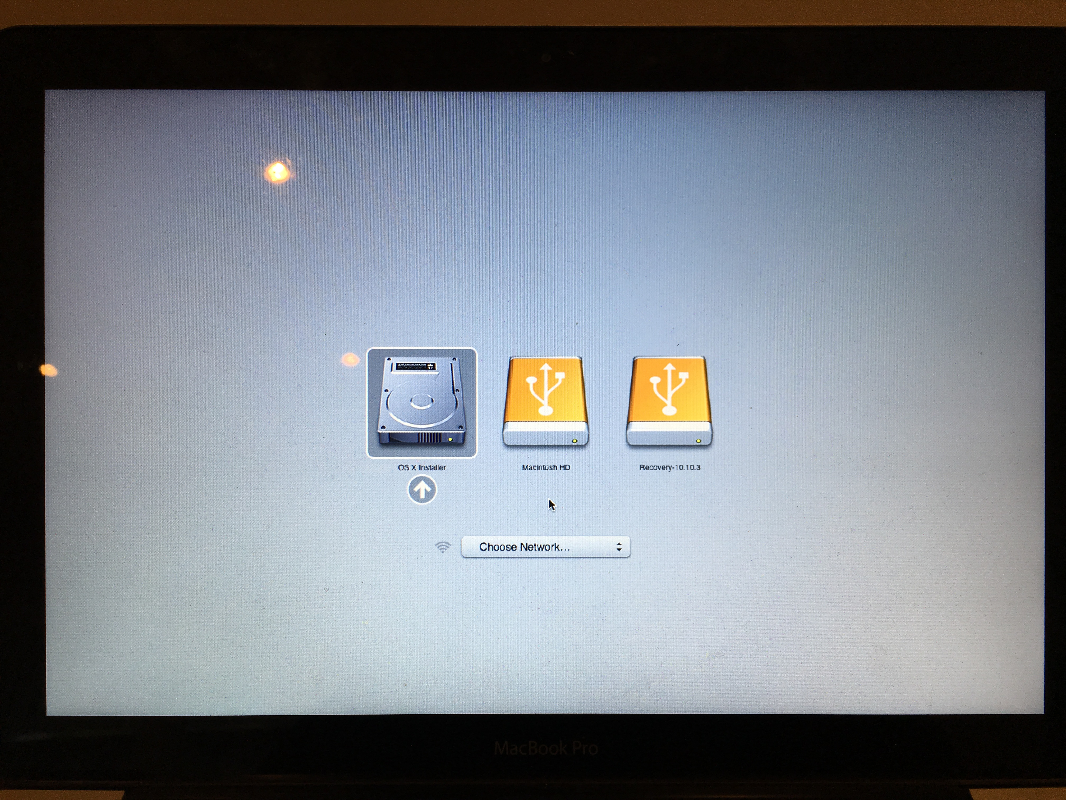

Thanks for your advice guys. I got to the bootable drive selection screen. I presume the orange drives are the external drive and display the USB logo.

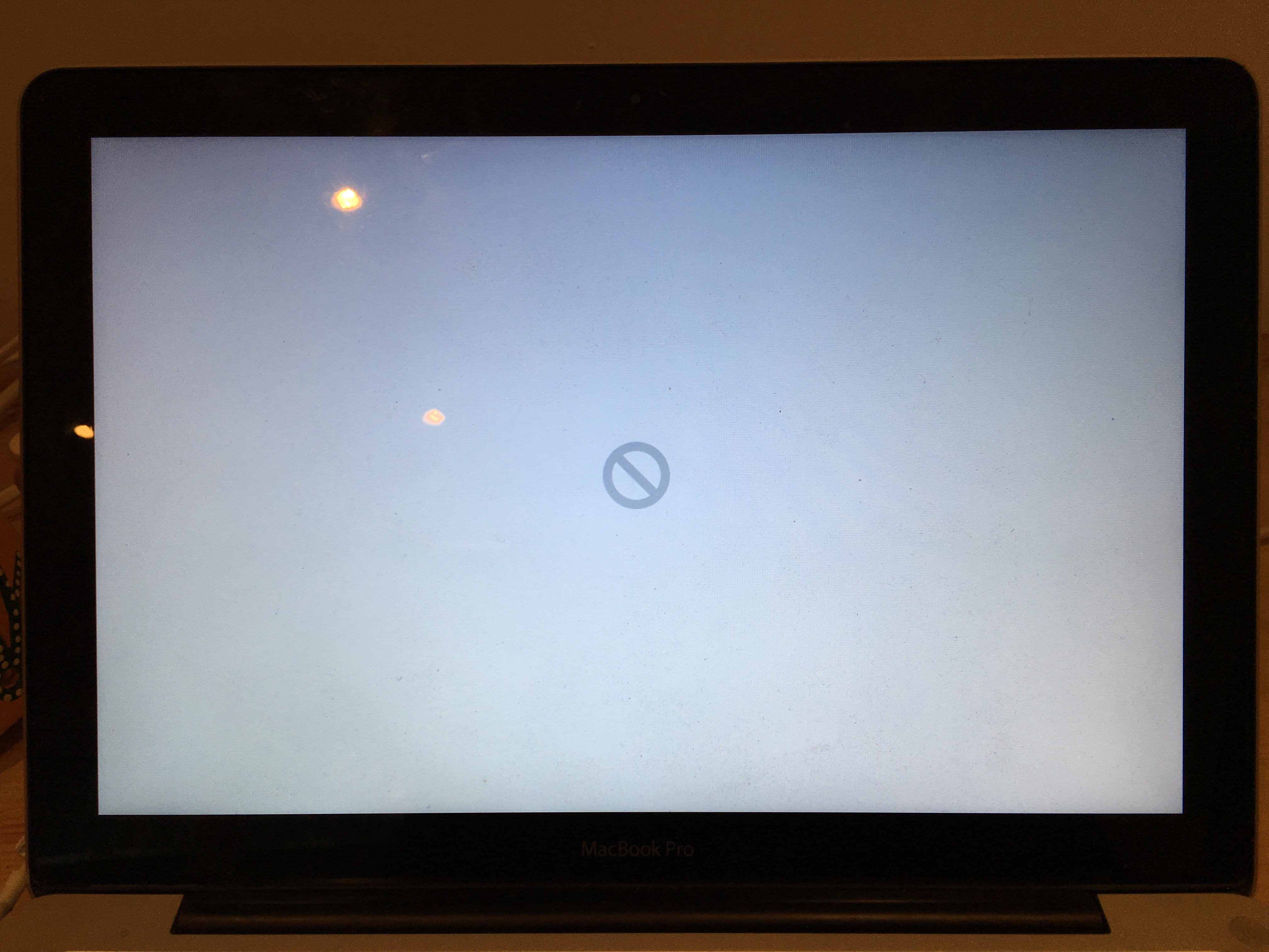

I selected Macintosh HD (any idea what the Recovery drive is?). I didn't get any further as it eventually returned a stop sign image. Images attached. Any advice on progressing from here?
Based on the that Disk Util error you posted earlier, you are going to need to option key boot to the TM drive like I mentioned and erase the entire disk then restore from the TM backup.
Even that won't work if the drive is bad. It is also possible the drive cable is bad. That can cause issues like this too.

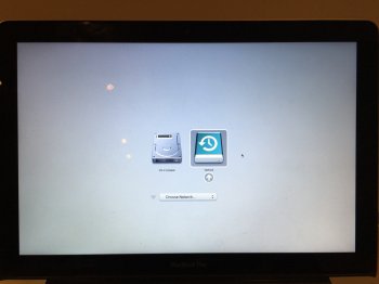

I've plugged in a TM backup external hard drive from my personal 2008 MBP (which is also dead but hopefully just down to an old battery).
This showed up instantly in the option key boot selection screen. The other original external cloned hard drive from this MBP took ages to display. I'm guessing it's down to the enclosure's newer USB 3.0 interface.

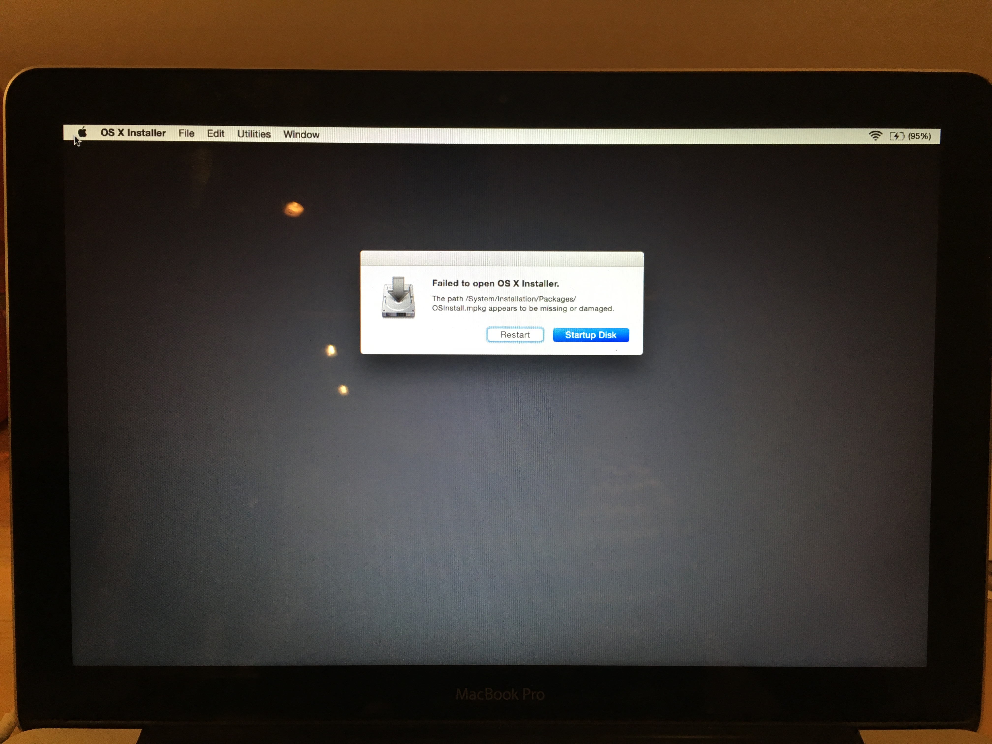

The problem I'm having is that when I select the TM backup in the boot selection screen, it doesn't lead me to the recovery screen, it takes me back to the El Capitan OS X installer on the local startup drive.
I know this because if I select Startup Disks from the Apple logo menu in the taskbar, it only shows me the local startup disk.

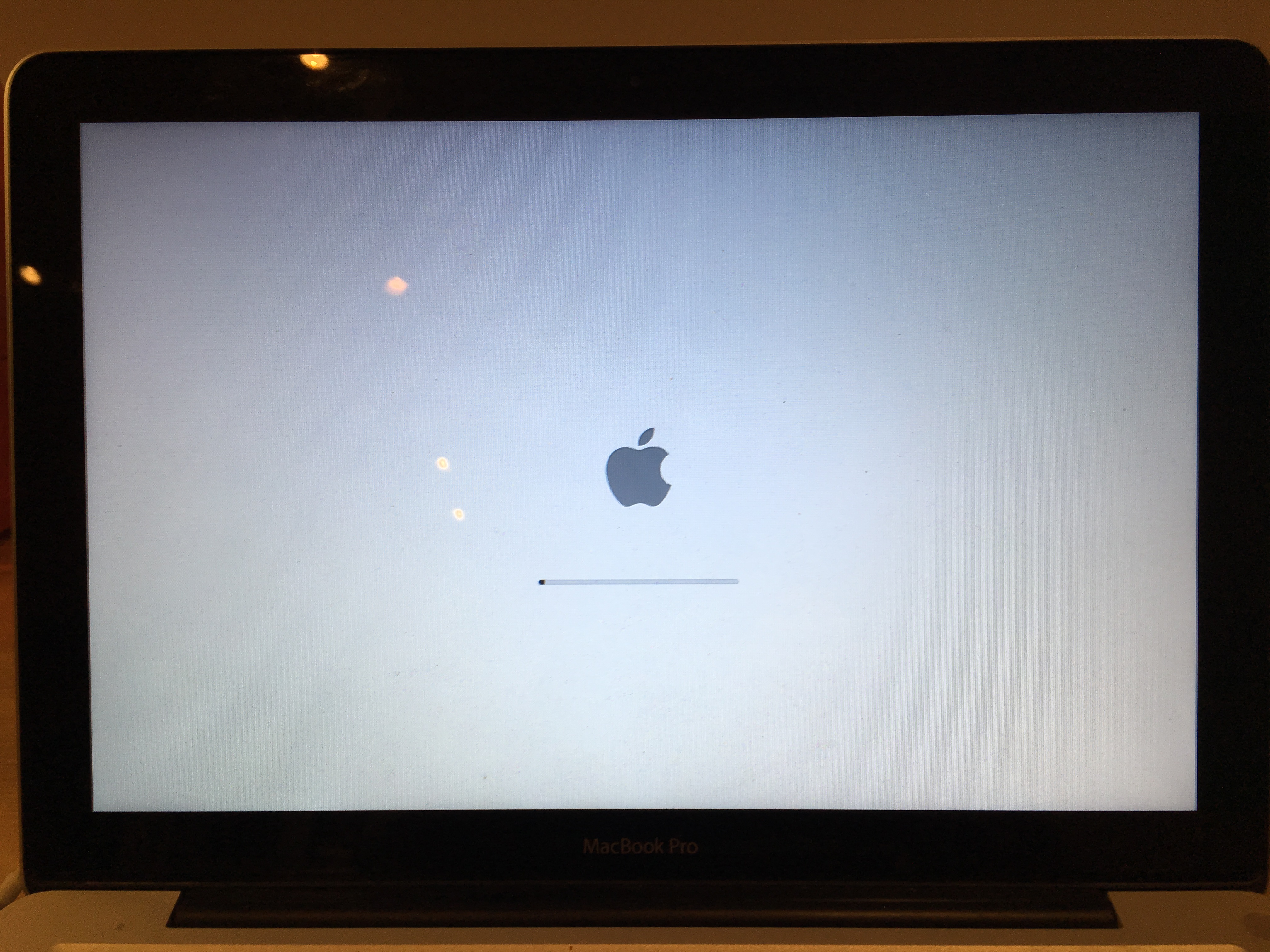

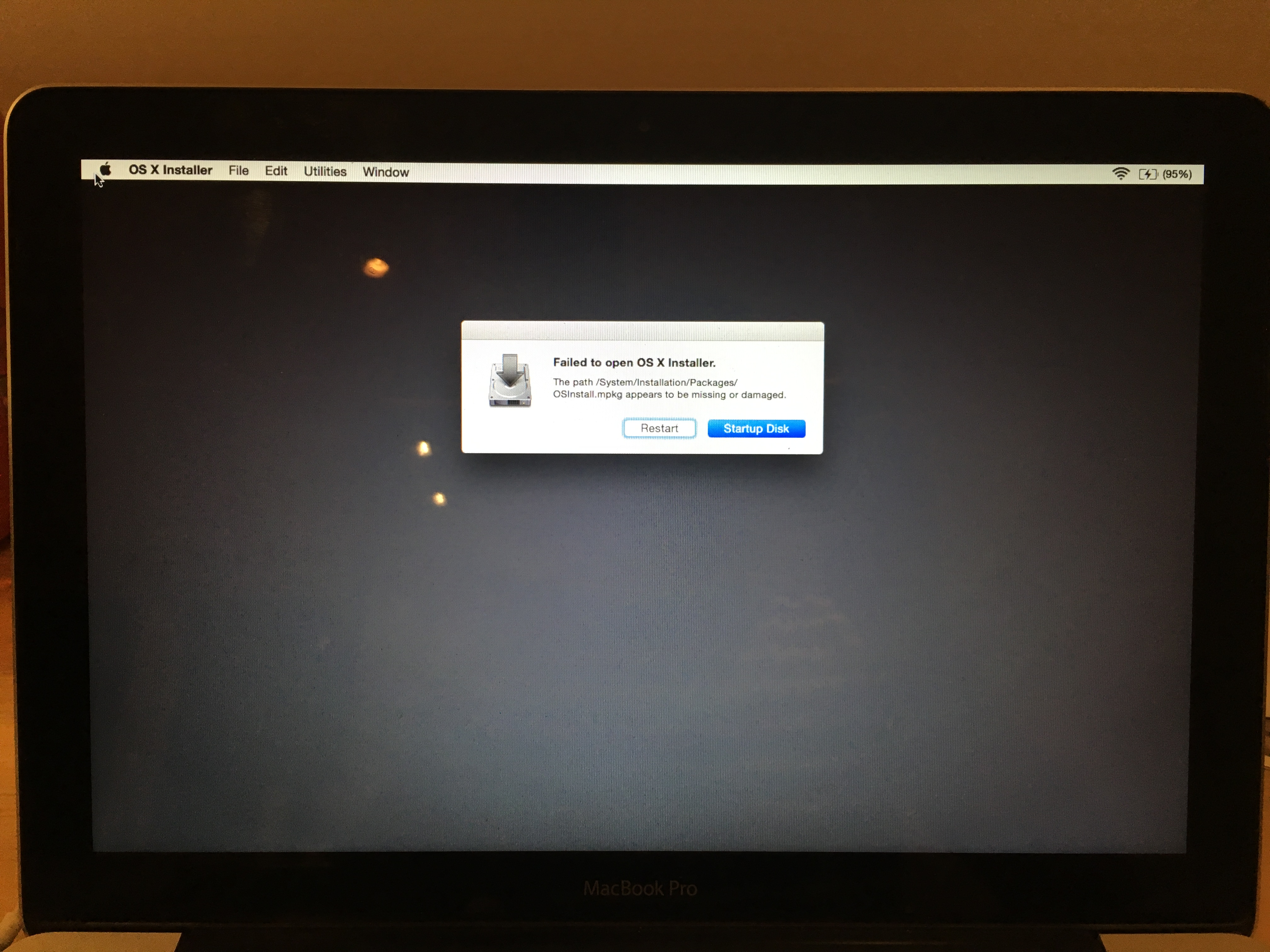

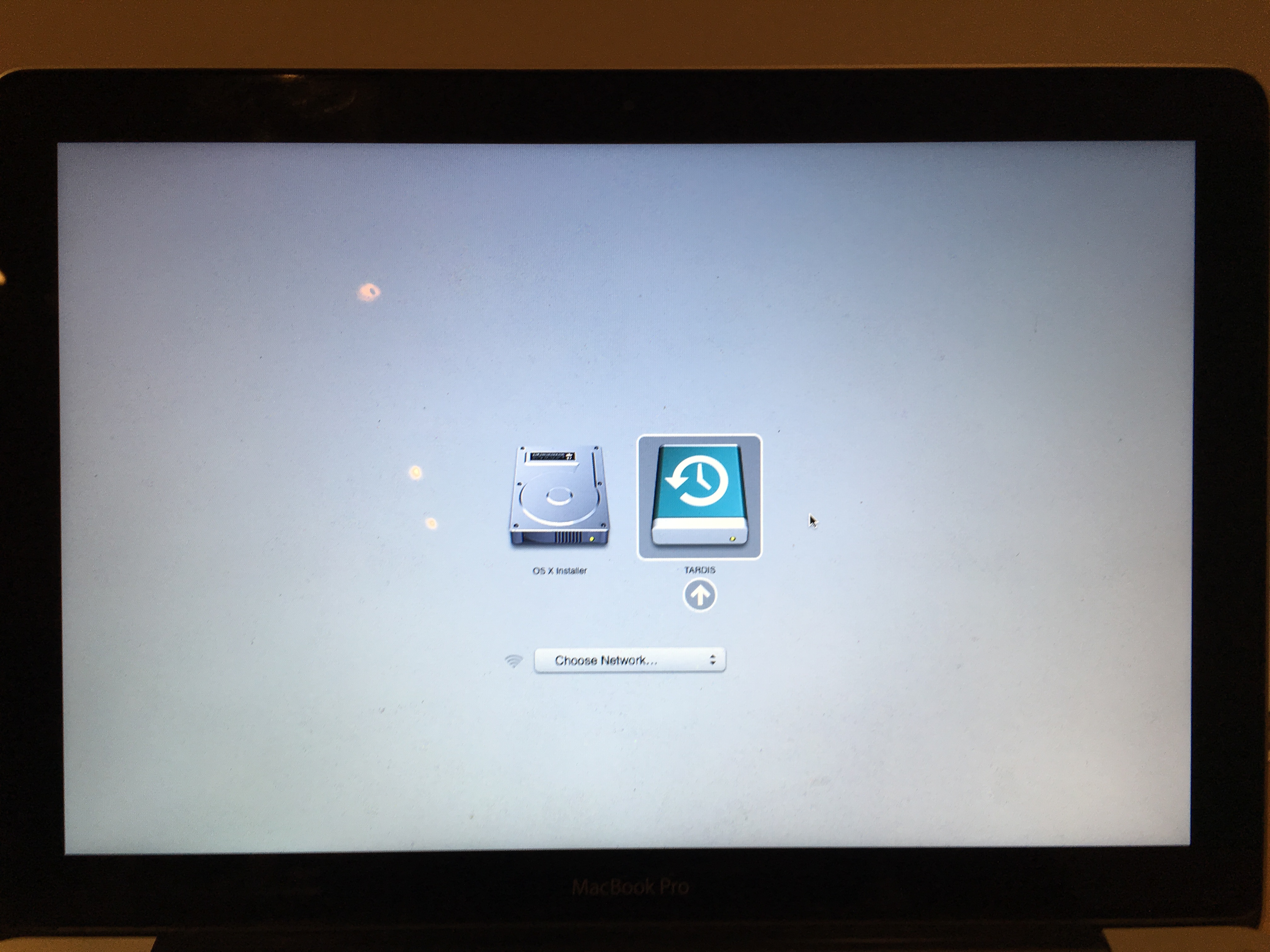

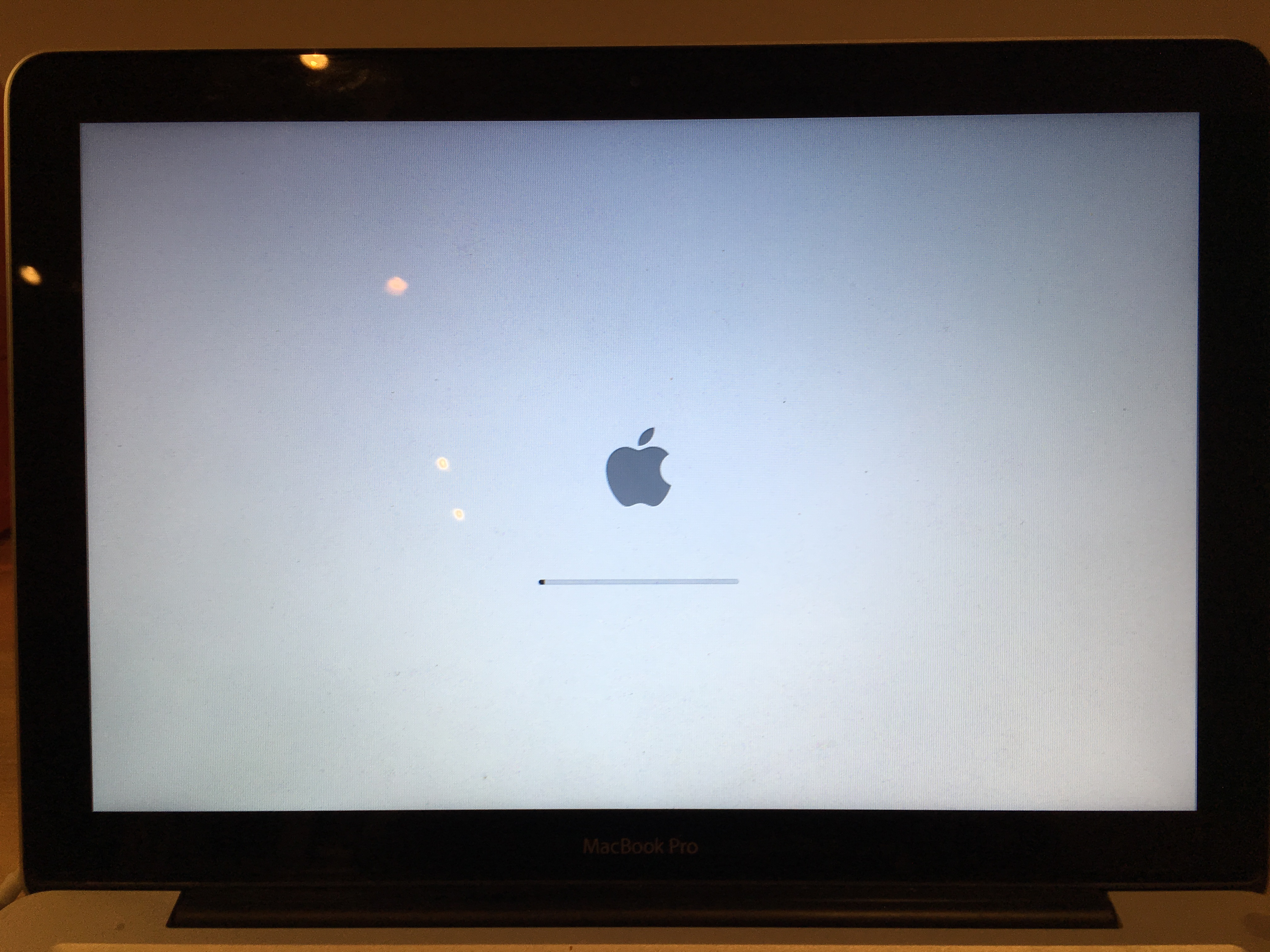

I've attached the process I see on screen.
Image 1 - option of booting from TM Backup (named TARDIS; apologies)
Image 2 - Apple loading bar
Then, about 5-10mins later...
Image 3 - 'failed to open OS X installer'
From here I am only left with shutting down and restarting. Utilities menu in the menu bar is all greyed out.

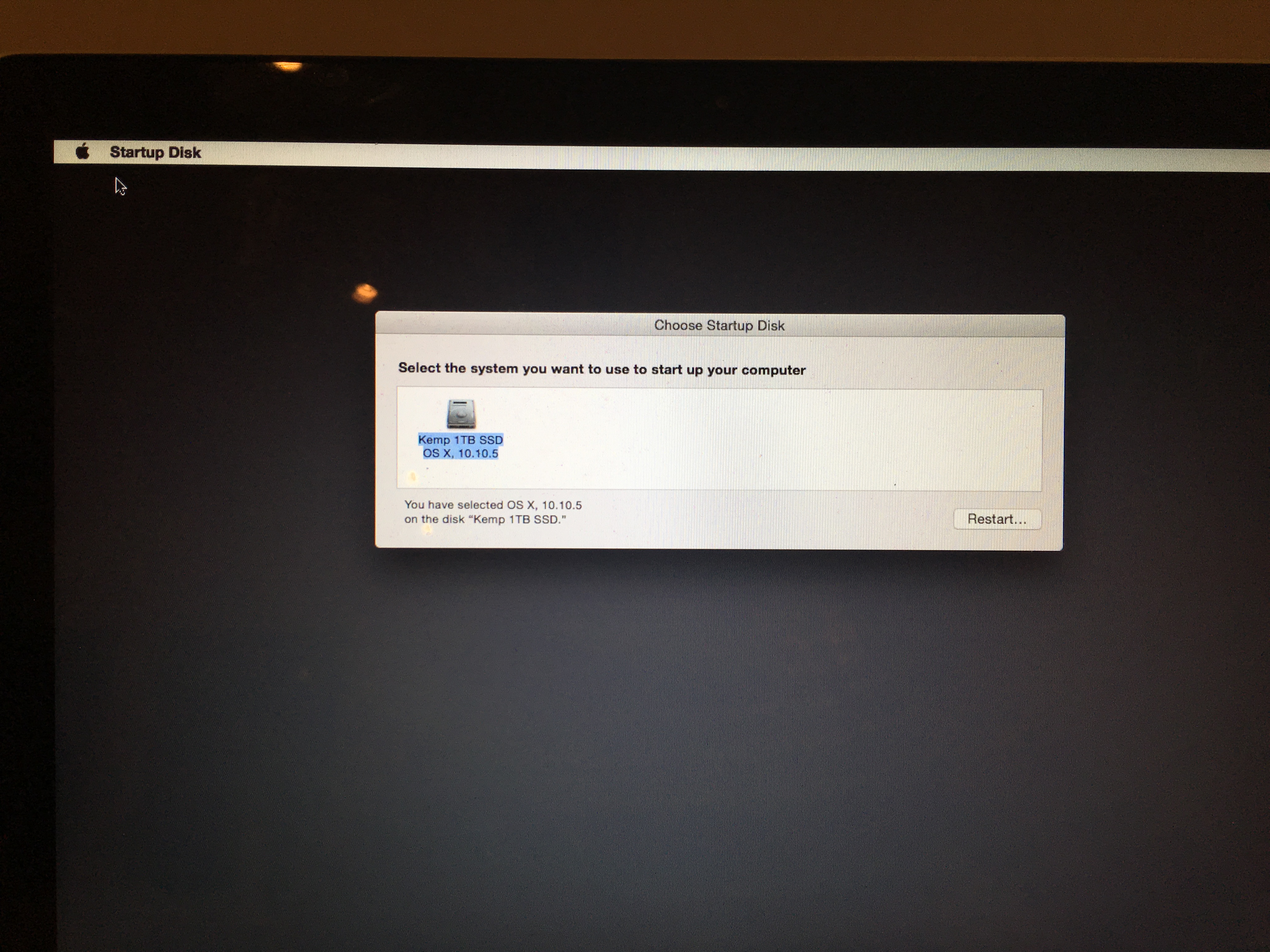

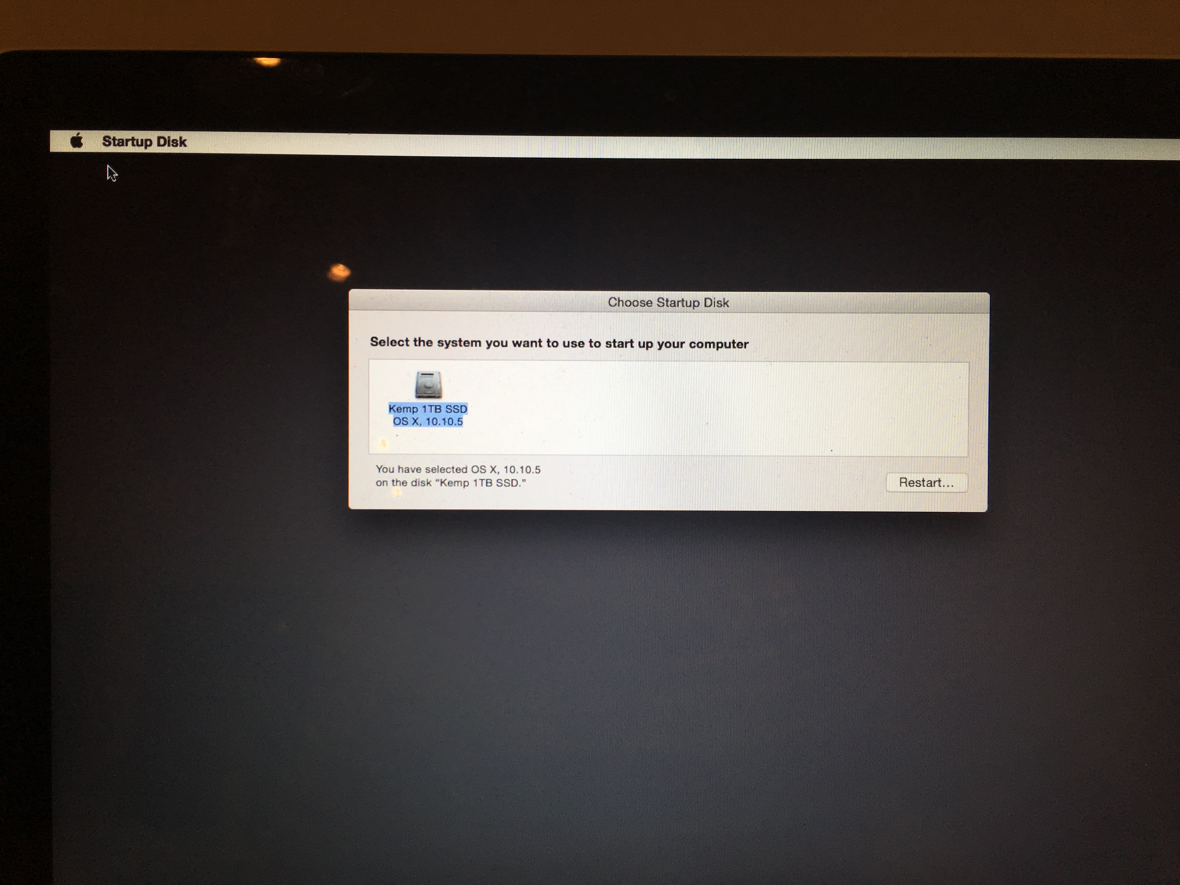

Opening Startup Disk in Apple Menu only shows current internal drive for startup disk (image 4).
