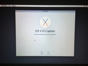

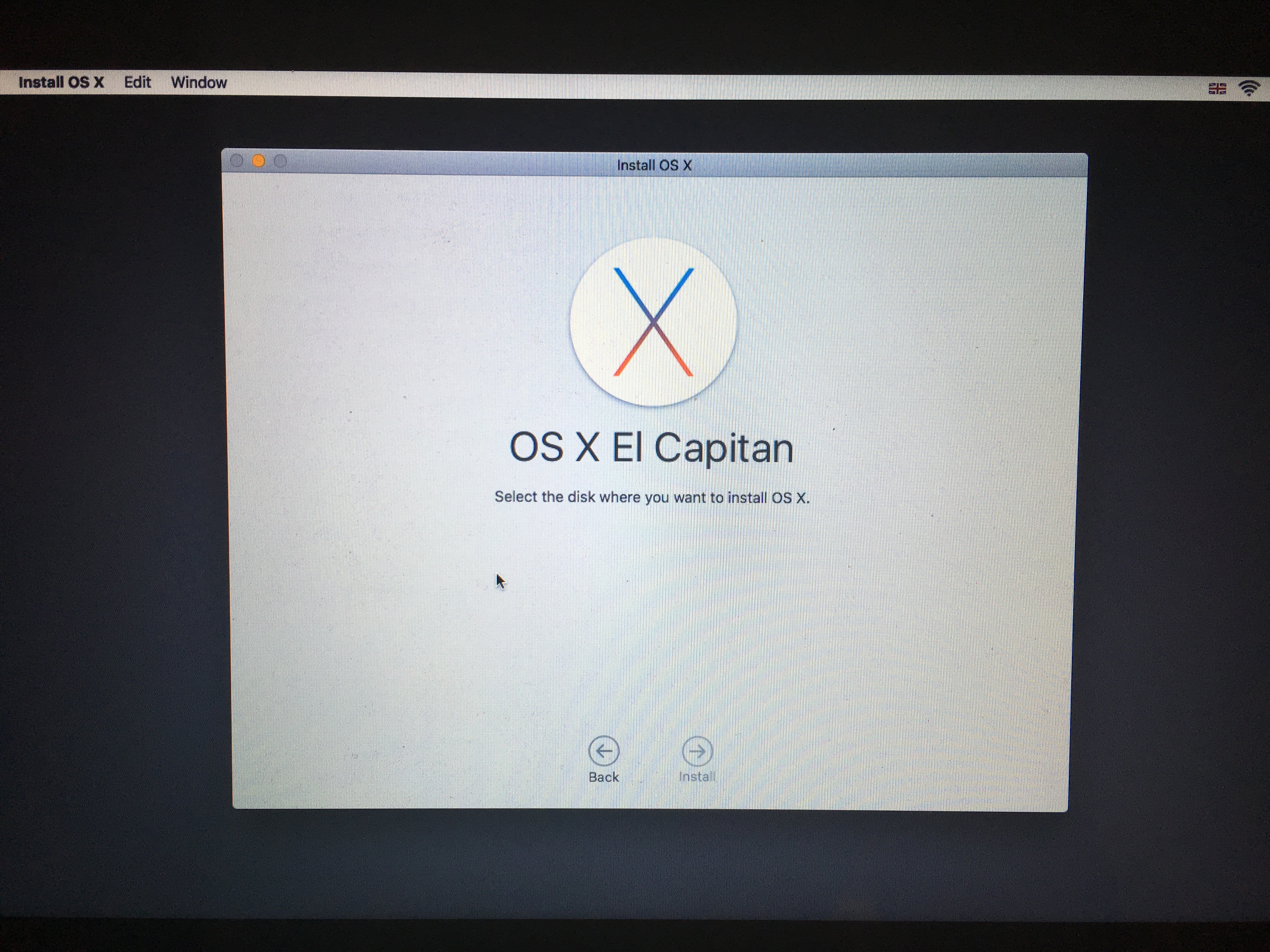

The Reinstall OS X option takes me to the attached image. No disks show up for selection... 🙁 It does seem to give me El Cap as the option.
It looks like Erasing the hard drive and then trying the Installer is my only option. I'll report back.
Yep, no disk means nowhere compatible to install to. Go to "partitions" and create one empty partition. Erase the drive as Mac OS Extended (Journaled) and go to options and make sure GUID is selected. It should be already selected, but just to be sure.
I've erased the drive and I'm now running the OS X installer for El Capitan.
I didn't create a new partition for this due to the issues I've had up to now. I want a full, clean install. Previous First Aid did not run on the disk, but now I've erased it, the First Aid check says all OK.

This is what I did. It ended up booting from Apple's servers (Earth globe with progress bar). I was then able format the drive and install El Cap as new.
