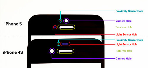

iphone 4 and 5 had such sensors (pic from http://www.macmania.at):

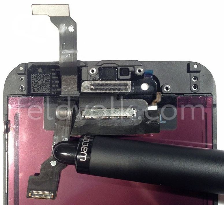

Here another picture (as it shows the back, it is mirrored) I see two sensors:
Here a picture from iFixit again with some info:

Ahh my mistake. I did forget about the ambient light sensor.
Well, I don't know which sensor is which of the 2 above the speaker/receiver.
When I make a phone call and I cover the sensor which is in the center above the speaker/receiver, the display goes black (as if you are taking a call). But I dont't know which sensor is responsible for that (meaning I don't know if the proximity or the ambient light sensor triggers this). If the one in the center, which you can clearly see is the proximity sensor and the one on its left (phone display facing you) is the ambient light sensor, then the ambient light sensor cannot work, as it cannot work through metal etc.
EDIT: http://www.tuaw.com/2010/08/13/hardware-test-your-iphone-4/
according to this link, the hole in the center above the speaker/receiver should be the proximity sensor. This one triggers to shut off the touchscreen/display when making a phone call and holding the phone close. Ergo, the other sensor on the left above the speaker/receiver should be the ambient light sensor. With the iloome screen protector the ambient light sensor would then always think it is dark.
