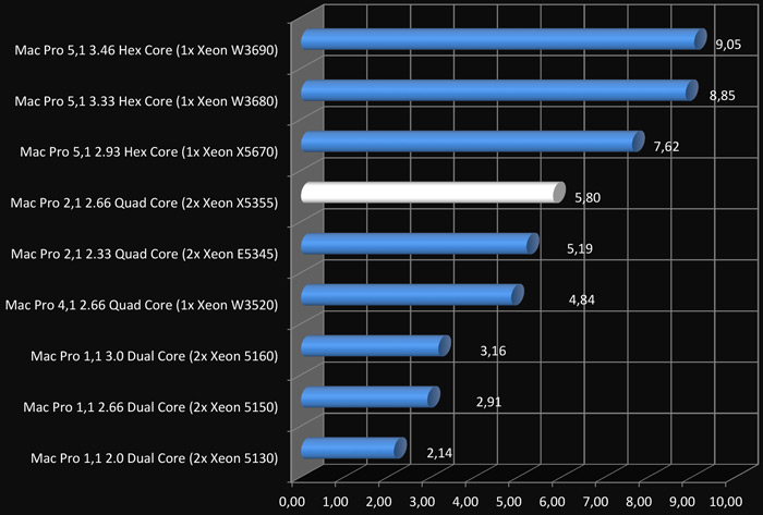

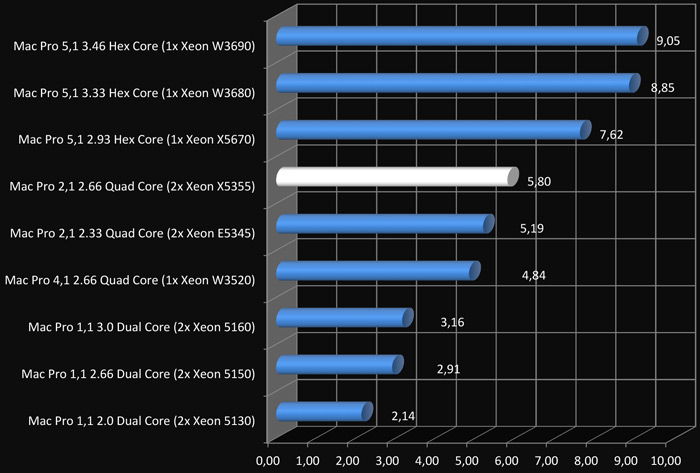

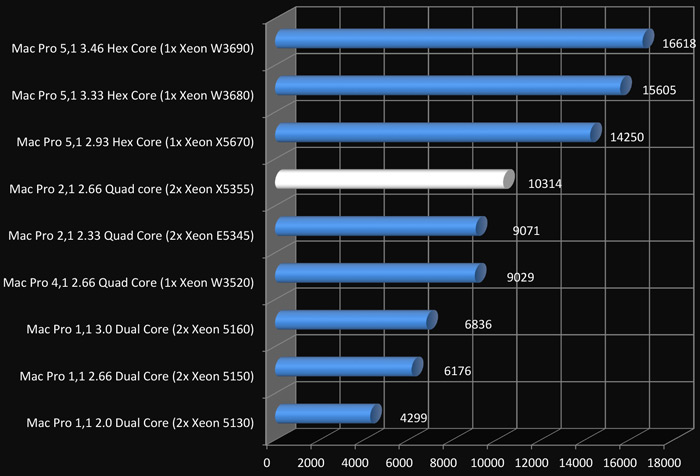

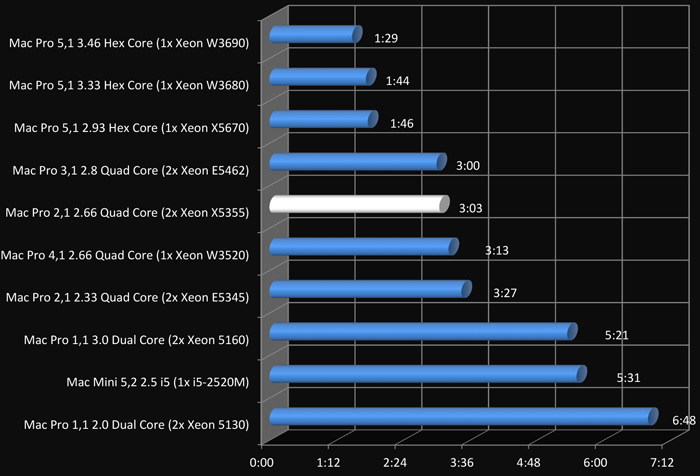

In well multithreaded apps 2x 5355 are faster than 1x W3520. You can check these graphs which I made one day when I was bored.
First is Cinebench 11.5, second Blender Cycles CPU (Mike Pan - seconds to render), third is Geekbench 2.2.7 64-bit.
If you'll convert numbers to %, you'll have a better picture. All tests were made on my own machines.

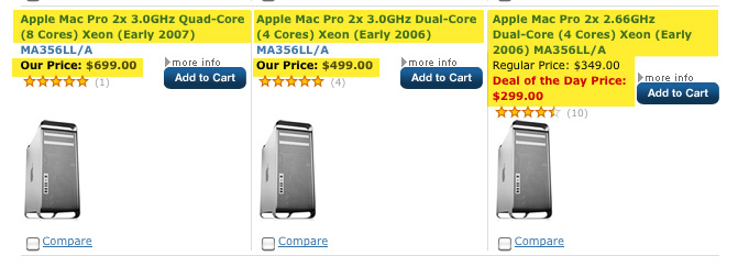

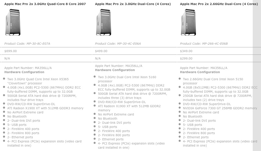

When I was shopping for my MP I noticed that macofalltrades.com had some really good prices (I bought my previous Mac from them back in 2004, which was a G4). Their prices seemed to be about where the prices were at for similar MP models being sold on ebay at the time. This is Mac of all Trades' MP page.
Check out the attached screen shots from that page. The file named "prices" shows the prices of the 1,1 (and 2,1) that they have right now (I highlighted the model names and prices in yellow). I also included a "comparison" file so you can get an idea of specs for each of those three models. I suggest finding the nearest specs to your 1,1 in it's stock config and then factor in any differences specific to your machine's actual config (for example the 20GB RAM and 8 cores that your 1,1 has). You can also check for any MPs with similar specs on ebay.
