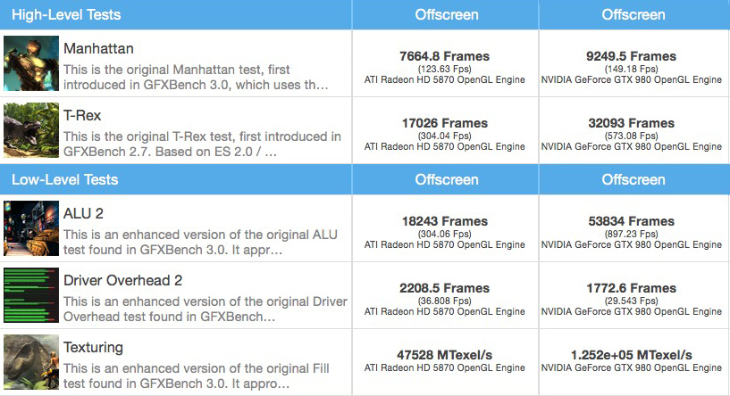

The GFX Bench Test Offscreen was also better for the Geforce, except for Driver Overhead 2.
(1.252e+05 means 125203 which is more than 47528)
