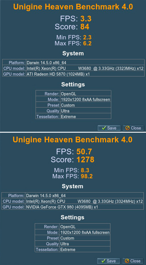

The Geforce 980 blows away my old Radeon 5870 in Heaven and Valley in the fullscreen mode.
I have decided to keep the Geforce.
