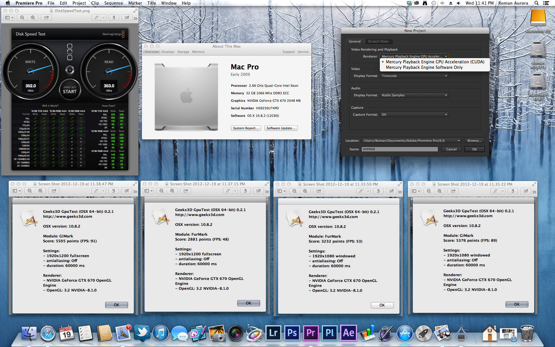

I got the GTX 670 FTW installed tonight in my 2009 Mac Pro along with the new SSD and upgraded the ram. Here are a few benchmarks of the new setup. I was also able to get Cuda and OpenGL to play nice with all my Adobe CS6 apps. So now I am able to run the Mercery Playback Engine GPU Acceleration (Cuda) in Premiere Pro.
Dustin
