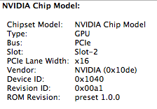

I have a Mac Pro 3,1 (Early 2008) running 10.8.2 and an ASUS GT 520. It has no fan, only a (rather large) heat sink and no additional power connector.
If I replace the current HD 2600 XT with the GT 520 I get the startup chime but doesn't seem to load the OS at all. I waited a several minutes and nothing happened. OS X in on a SSD so the system boots up in like 10 seconds usually.
I've tried keeping the 2600 XT in there and putting the GT 520 in slot 2. This gives me the ability to boot up the system but it reboots by itself when it gets to the login screen.
Finally, I've tried booting in safe mode, which this time lets me in the system, only to find out that OS X doesn't seem to detect the card properly (see attachment). It does detect that its a GPU from NVIDIA but not the exact model. Also, none of the output connector works.
I've also tried to install the latest drivers from Nvidia (304.00.00f20) but it says that I already have the latest version.
Any help would be greatly appreciated as that 2600 XT is killing me!
Thanks!

Fixed my own problem, thanks to the hackintosh community!
The problem is pretty simple, it seems that the device id for the GT 520 has been removed from the Nvidia driver plist in Moutain Lion.
FIX:
Open Terminal.app
Code:
sudo nano /System/Library/Extensions/NVDAGF100Hal.kext/Contents/Info.plist
Scroll down until you see a bunch of string such as 0x124010de&0xffc0ffff, create a new line just after the last one and add:
Code:
0x104010de&0xffc0ffff
Hit Ctrl+O then Enter to save and restart your system.
This should work with any other card supposedly not supported. Just get the device id from System Information, add "0x" to the beginning and "10de&0xffc0ffff" to the end and add it to Info.plist like the other one. I don't know what that last hex part means but it seems to be the same for most cards so I guess it's safe to try.
