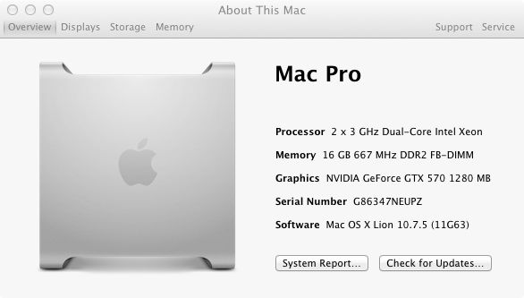

My Nvidia GTX 570 arrived today:
Haven't had a chance to run too many tests but editor photos is soooo much smoother and Portal 2 runs amazingly. The install was simple, simply plopped the card in and it worked.
