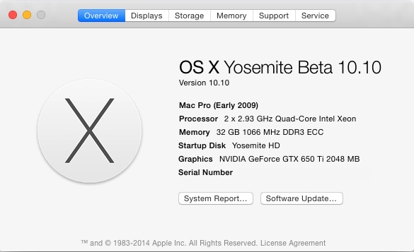

Yes, GM107 cards work with the Yosemite web driver. Not perfect yet, but it's a good sign that these will work with Yosemite when it is finalized.
EVGA 650ti SSC Works in OS X Yosemite 10.10
just took the old EVGA 650ti SSC 2GB card out of my PC after upgrading to the 750ti and decided to try the 650ti in my 2009 8core Mac Pro. Worked Perfectly. I tried the 750ti and it wouldn't boot properly, it kept chiming then rebooting and chiming again. I've only found this thread about 30 minutes ago and never thought to try a PC card in my Mac before so thank you everyone who's kept this post alive

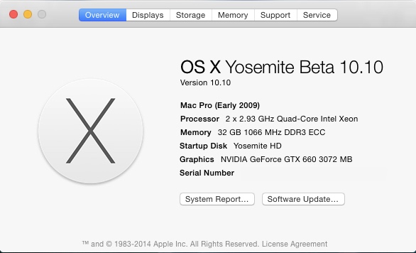

Update Sept 4, 2014: EVGA GTX 660 SC+ 3GB Card also works
