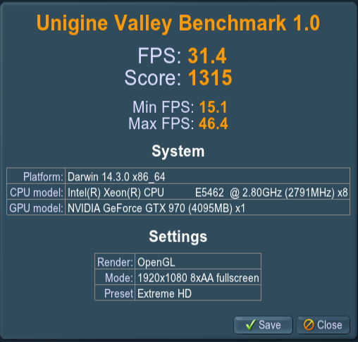

I do not get 35 fps consistently. Attached is my benchmark score. As you can see, i get more than 35 fps occasionally with my average being at 31.4
The situation is similar in games. When there is little to draw, (e.g. i am staring at a wall) i get great fps.
Is the 35 fps ceiling you encountered only happening for PCIE 1.0 or 2.0? Or is that an entirely separate issue? If so, how much of a performance difference is there between the two?

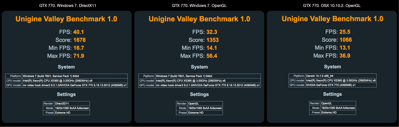

Was curious how my GTX770 compared so used the same settings. Definitely shows how poor OS X currently is, and for gaming running bootcamp is the way to go with almost double performance in Windows through DirectX11.
So I guess the question still stands, is there a way to make these Nvidia cards run better under Mac OS or is this just how it is?

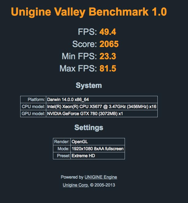

Really? My score with my MVC Modified Gigabyte GTX780 on my 5.1.
You're problem is the hardware (Mac Pro 2,1) not the Mac OS.
Lou
