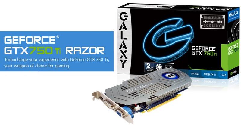

I just came across an interesting GTX 750 Ti. Single slot and no power cables needed. Might be good for those who need a video card for GUI and/or some extra Cuda cores without having to deal with looking for ways to power another video card.
