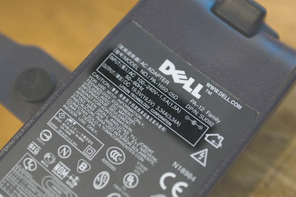

Most newer (or higher priced) electronics are made to use both.. You need to carefully inspect the power requirements, usually listed on the transformer block. From my experience, I've found that Laptops and many DVD players will accept both 110 and 220 power, meaning all you must do is change the physical plugs; easy to get a travel adapter at an electronics store. My old dell laptop, macbook pro, camera battery chargers are all 110/220 interchangable; that's good news.
The bad news is I've had a few items that weren't made for both, and I've fried a few of them. What you're specifically looking for on your electronics is the line: "Input: 100-240 VAC, 50-60 Hz." If it says something like "Input: 220 VAC" don't plug it in, at least in the US. (Notice the first line covers a range that you would use in both the US and EU? The second is EU only...)
The good part of the bad news is all the items I've fried had a "wall leech" (Some people call them "Wall Warts," basically the transformer is built onto the plug as is the case with many smaller electronics devices. The good news part is you can look at the physical size of the plug (that round one that's fairly standard and goes into your electronics) and look at the transformer's "Output" line, which is usually something like "9 VDC, 1.0 Amp."
If the case is that you have a transformer that is 220 only but has a standard plug and outputs in a standard DC voltage, you can often buy a replacement at a electronics store (i.e., Radio Shack). You must match the volts spot on, but you can supply more milliamps than required by the device, but don't under power it. For instance, if your device is 12 Volts, 700mA, then you can get a 12 Volt, 800mA transformer and have it work; If you absoloutly can't find the same sized plug, then you can always cut your original device's cable and use the plug part (replacing the 220 with the 110 transformer block).
Hope that helps! The big thing is check to see if your electronics support 110/220.
I attached an example of what lines you're looking for on the transformer. In this case it was a Dell Transformer that works with 110 as well as 220.
