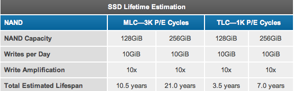

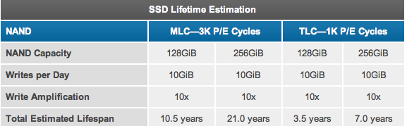

It also depends what kind of SSD it is, if it's a SLC it will not break down before the iMac breaks, but if it's an MLC or even (a lot)worse a TLC I can see the first breaking after 2-3 years for a TLC, and 5-6 years for a MLC SSD.

Unless you're writing a terabyte a day to the SSD, it'll outlive the HDD. It would be time to upgrade the system before it's time to replace the SSD due to failure.
I'm not sure this is true anymore, depending on the wear leveling algorithms. For earlier drives maybe, but I think more recent drives have good enough controllers that should extend the life well beyond these numbers. I believe the new Samsung TLC drives are supposed to live at least 10 years writing 100GB/day or something similar. Of course, the actual life is very dependent on the usage of the drive itself.

Yeah, well, TLC blows. Thanks for the link. It does raise an important point though; the higher capacity drives have more NAND chips and therefore longer life.

The iMac Fusion drives use a 128GB SSD. So using the info Justperry linked in post #10, that drive will last at least 10 years with 10GB of writes a day (which is a lot).
I suppose theoretically Fusion might result in slightly more writes to the SSD, but from what I have read about how Fusion works, I don't see how it would be enough of an increase in writes to make a noticeable difference in NAND cell lifetime.
