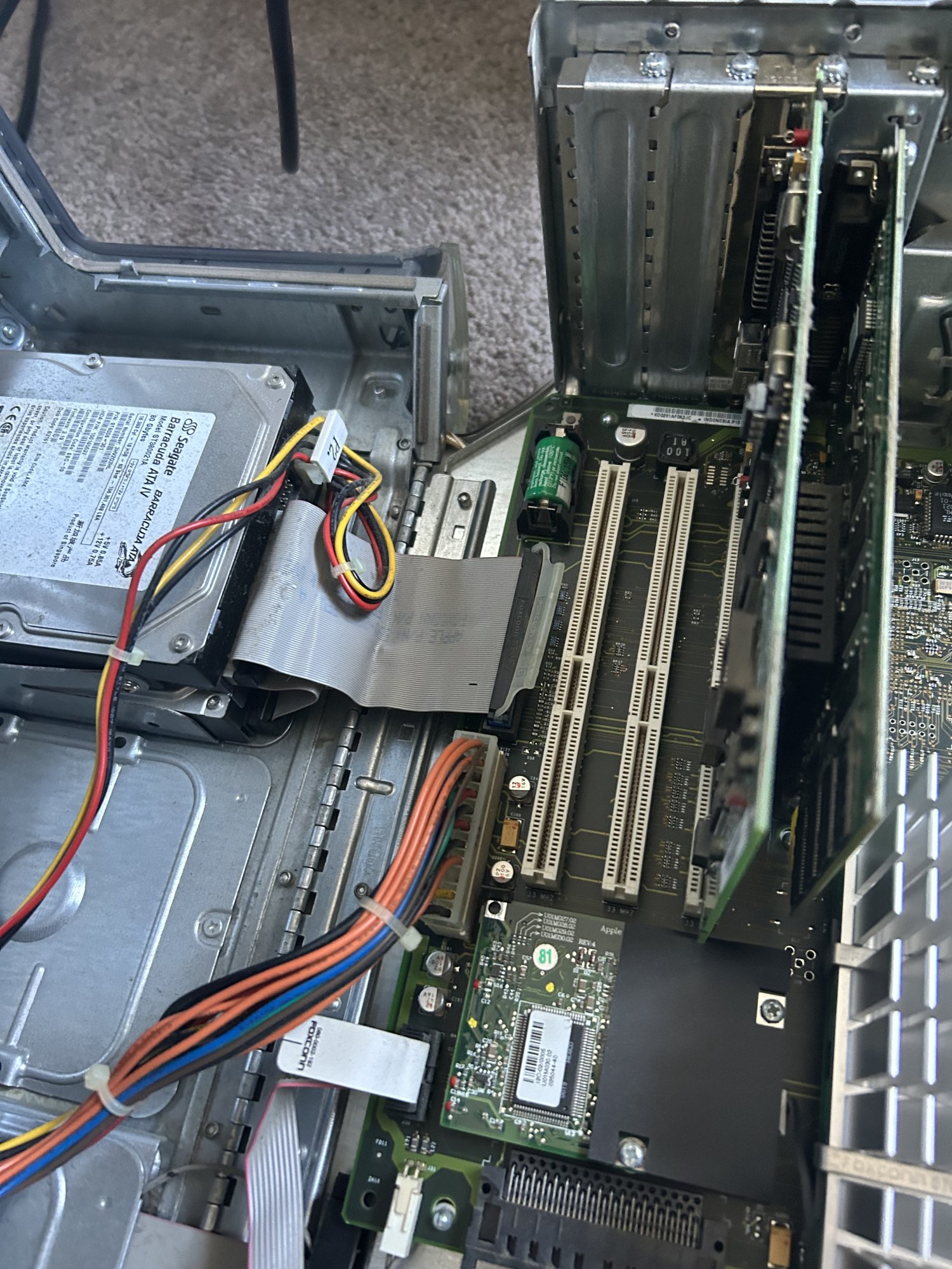

I assume the PRAM battery is the green thing in this pic? If that’s the case mine will be 20 years old, so let me find a replacement for that asap!

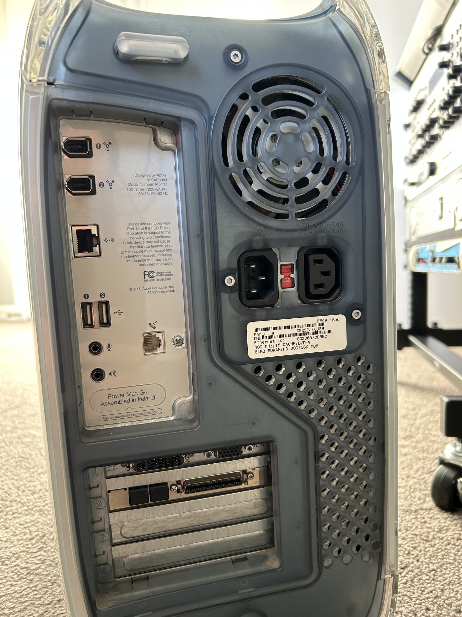

This is the rest of the machine and back if that’s helps with the model (do I assume it’s a gigabit model based on the Ethernet and FireWire connections)?:
Battery acquired. Will try the reset when I get home. Might also take the time now to clean the insides. Quite a bit of dust in the fans. Plus something makes a noise (I assume one of the fans), so I’d like to fix that too.
EMC#1856 is a Gigabit model.

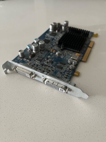

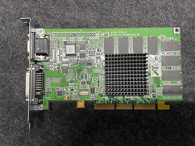

Would something like this allow for dual screens? I’d need DVI to VGA connectors but that seems like the easy part.
Or I assume this is an OEM card that would drop straight in? I assume I’d need a screen to install any drivers if that was required with a new card.

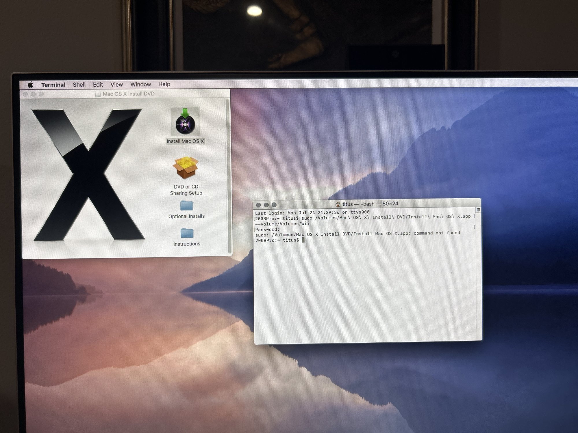

Think I’m calling it a night. I managed the easy stuff. Got dual screens working, downloaded a version of OS 10.5 and now doing my best to create a usb boot file. But it’s not working.
Keeps saying command not found.
I thought Terminal might not have access to change the computer but I fixed that. Definitely on admin profile.
