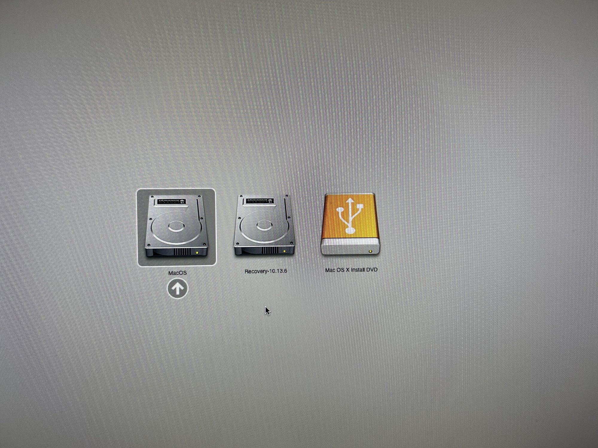

I think it’s because I have emulated the DVD on the USB drive but then not sure what to do next. If I try and boot from the USB I get that error. If I try and install the DVD, it asks to reboot the computer but doesn’t give me an option to install on a different drive. Just reboots back to the screen I was on before.
Currently trying to create a bootable drive using Balena Etcher. If that doesn’t work I’ve downloaded a copy of Snow Leopard (10.6) and will try that. Maybe it doesn’t play nice with the copy of 10.5 I have?

By shear luck I’ve managed to get here. Exciting:
It won’t let me install the OS on the main HDD. So I’ve started installing on the external drive on a partition.

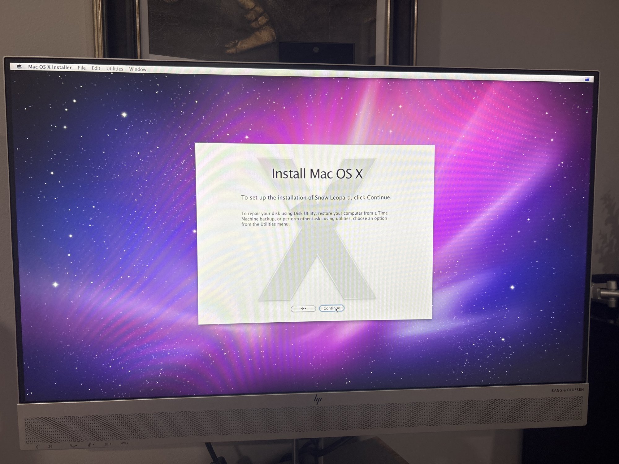

That’s very kind. I was very close to having to pull the pin and ask for help, but I think I’ve actually had some progress finally using the 10.6 install.
Ok. Install on ext drive worked. Will have a go at doing it on the actual hard drive in the morning.

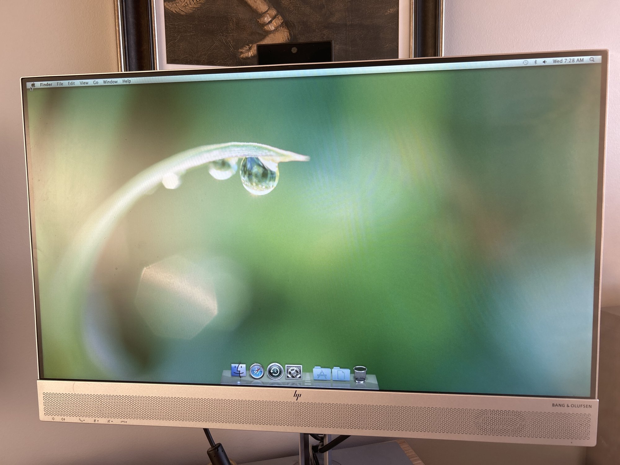

Latest update. It’s all setup and working!
Logic installed without any issues and I updated to 7.2.3 and it’s all loaded and I’ve spend the past few nights setting up the configuration and auto load. It worked immediately with the midi controller but the software for this is part of the Logic bundle which is good.
