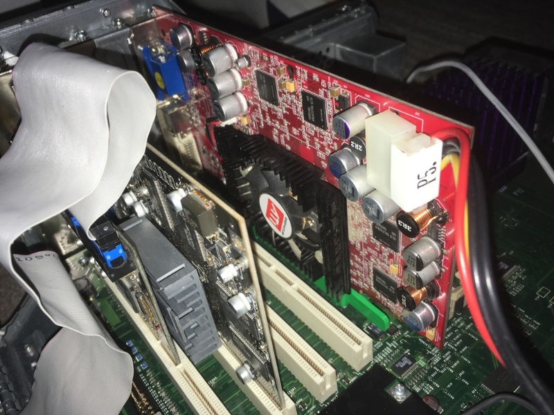

The second change is that I got a Radeon 9800 Pro, I was looking for a 9700 but I lost out on a couple on ebay and this 9800 came up for a really good price. I had a lot of trouble flashing it, turns out I needed to use the -sst command in Atiflash when flashing it due to the type of Bios chip it had. After I got this worked out and got the pins taped it worked first time.
It really is a massive difference over the radeon 7000, it seems to cope with the heat so far but it is really loud. I've avoided using it on really hot days. I need to get a molex extension too as the stock right angle plug is a bit of a tight fit. Gaming performance is decent, it plays Halo and Doom 3 without too many issues, Return to Castle Wolfenstein runs great at max settings in 1600x1200 too.

Congrats on the GPU find! That is a nice card and should work well with games. You can run up the clock speed with ATIcellerator to see where it starts to have problems then back it off a reasonable amount. I've seen some people put heatsinks on the VRAM chips and upgrade the cooler.

I think I'm gonna avoid overclocking the 9800, I see a lot of them going for parts on ebay as I understand they are from a time when the solder had a habit of going bad. I reckon my CPU would bottleneck much more performance anyway. I am watching a card with an arctic cooler at the minute so I may pick one up just to keep it a bit cooler.

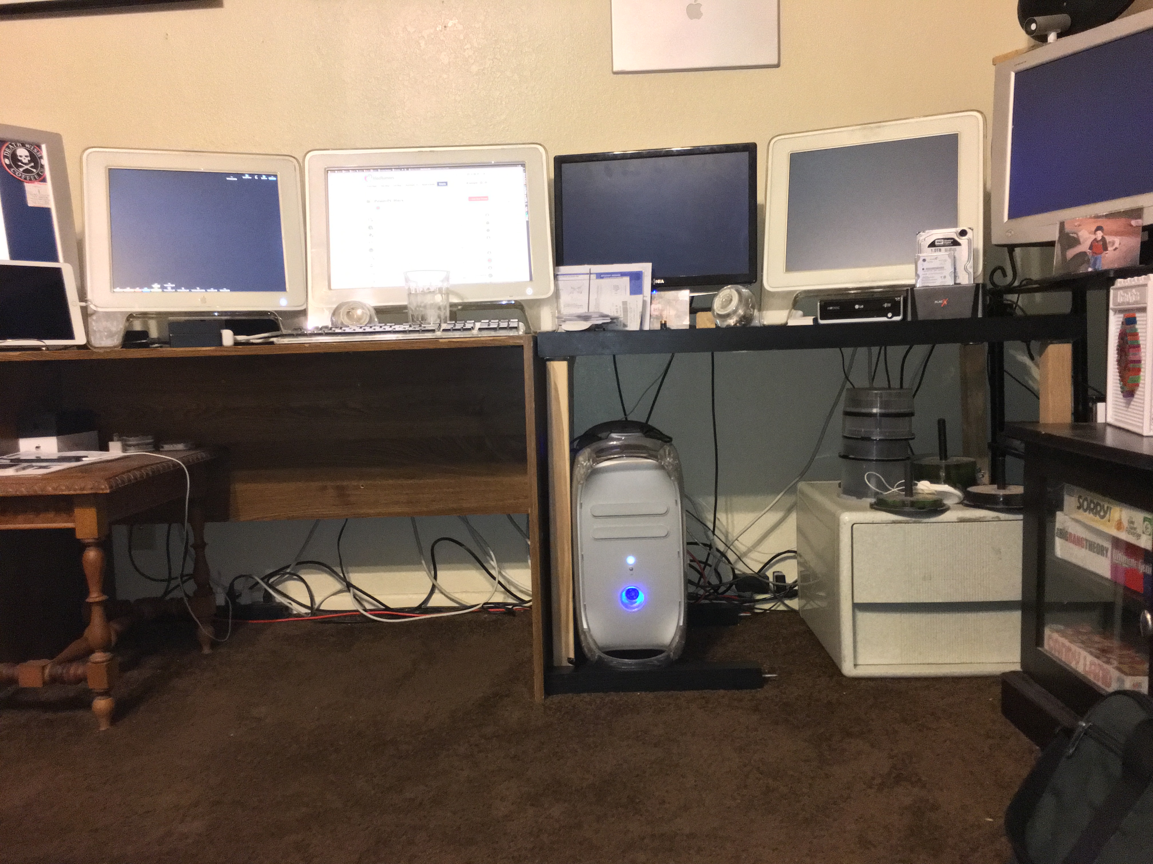

Dunno, on QuickSilver the PSU has to run the following:
- 1.8GHz Sonnet (single)
- Radeon9000
- 22" Apple Display
- USB2
- SBLive!
- Voodoo3000
- SIL3112 SATA
- DVD-RW
- CF-Card (in IDE)
- SATA-SSD
No issues so far.

I had…
• 1.8Ghz Sonnet Duet (Dual CPUs)
• Radeon 7000
• Radeon 9200
• NVIDIA GeForce 6800GT <-- Requires a Molex Cable for supplemental power
• 4 Port PCI SATA Card
• 3x 1TB Hard drives
• SATA DVD Burner (Dual Layer)
• USB 2.0 Card
• Firewire Card (FW400 and FW800)
• Bluetooth 2.0 USB stick
• 1x 120mm fan
• 1x 80mm fan
• 1x 60mm intake fan
• Apple Pro Speakers
Plus incidentals, such as keyboard, FW devices, PSU fan and main 120mm fan
Radeon 7000, Radeon 9200 and NVIDIA cards drove six displays
• 20" Cinema Display
• 17" Cinema Display
• 2x 18" Gateway monitors
• 1x 20" HDTV
https://forums.macrumors.com/threads/quicksilver-beautification-project.1953562/

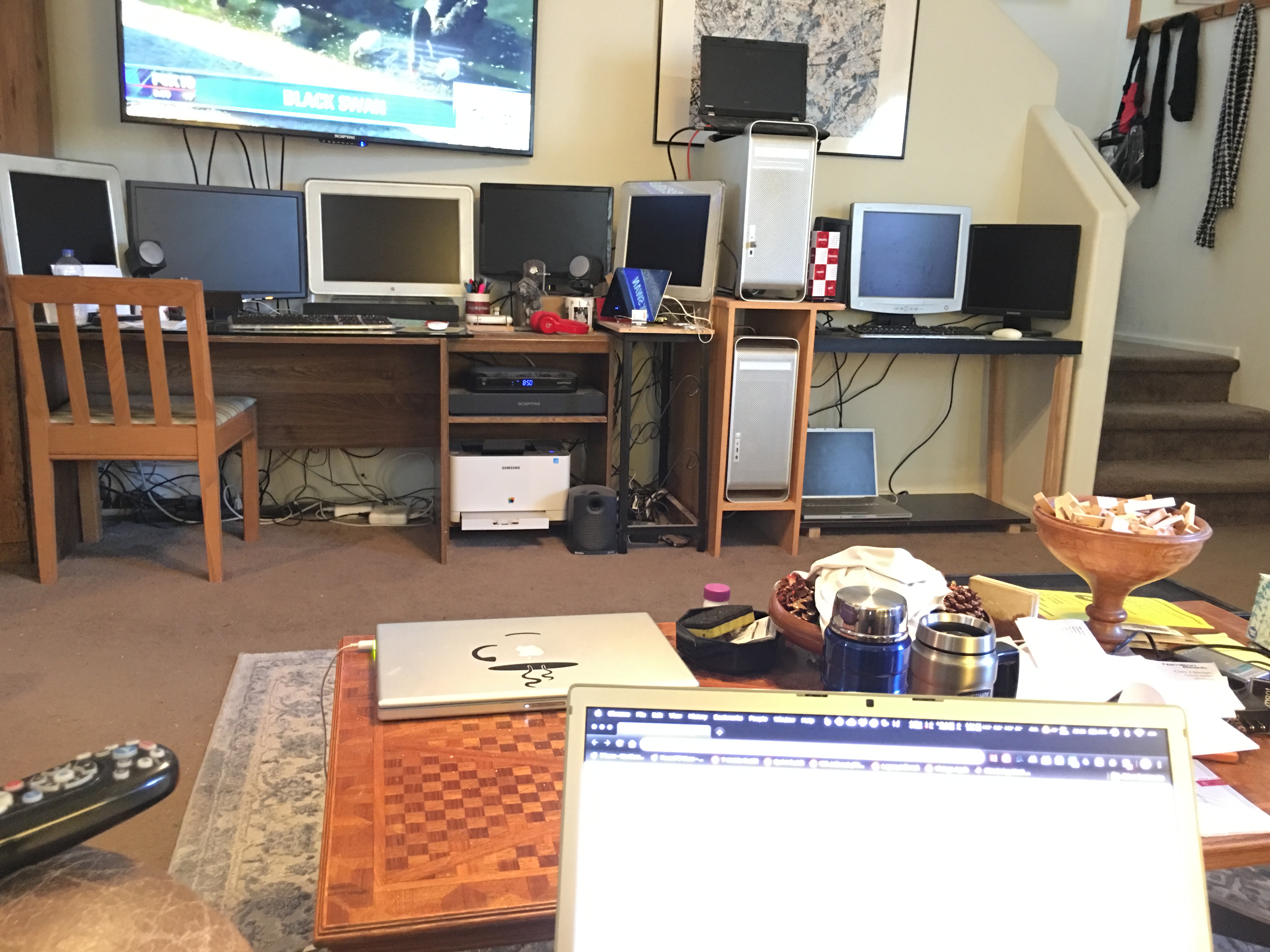

Is this a Macbook on your wall?
If you are referring to what's hanging on the wall in my picture, that's the back lid of the display to a 17" PowerBook G4 (A1013). Someday I intend to put a light with a switch behind the panel so that the logo will light up and the edges of the panel will have a soft backlit glow.
