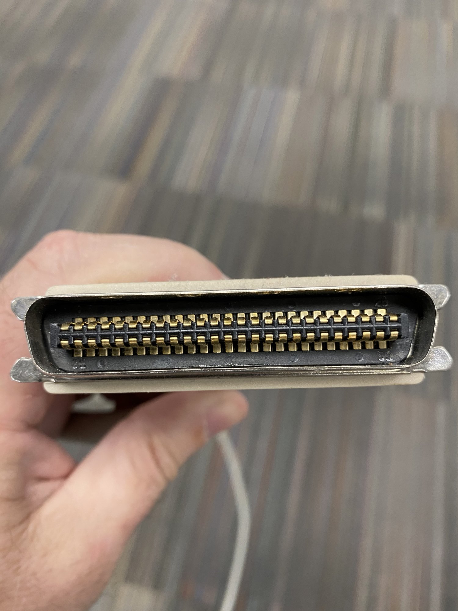

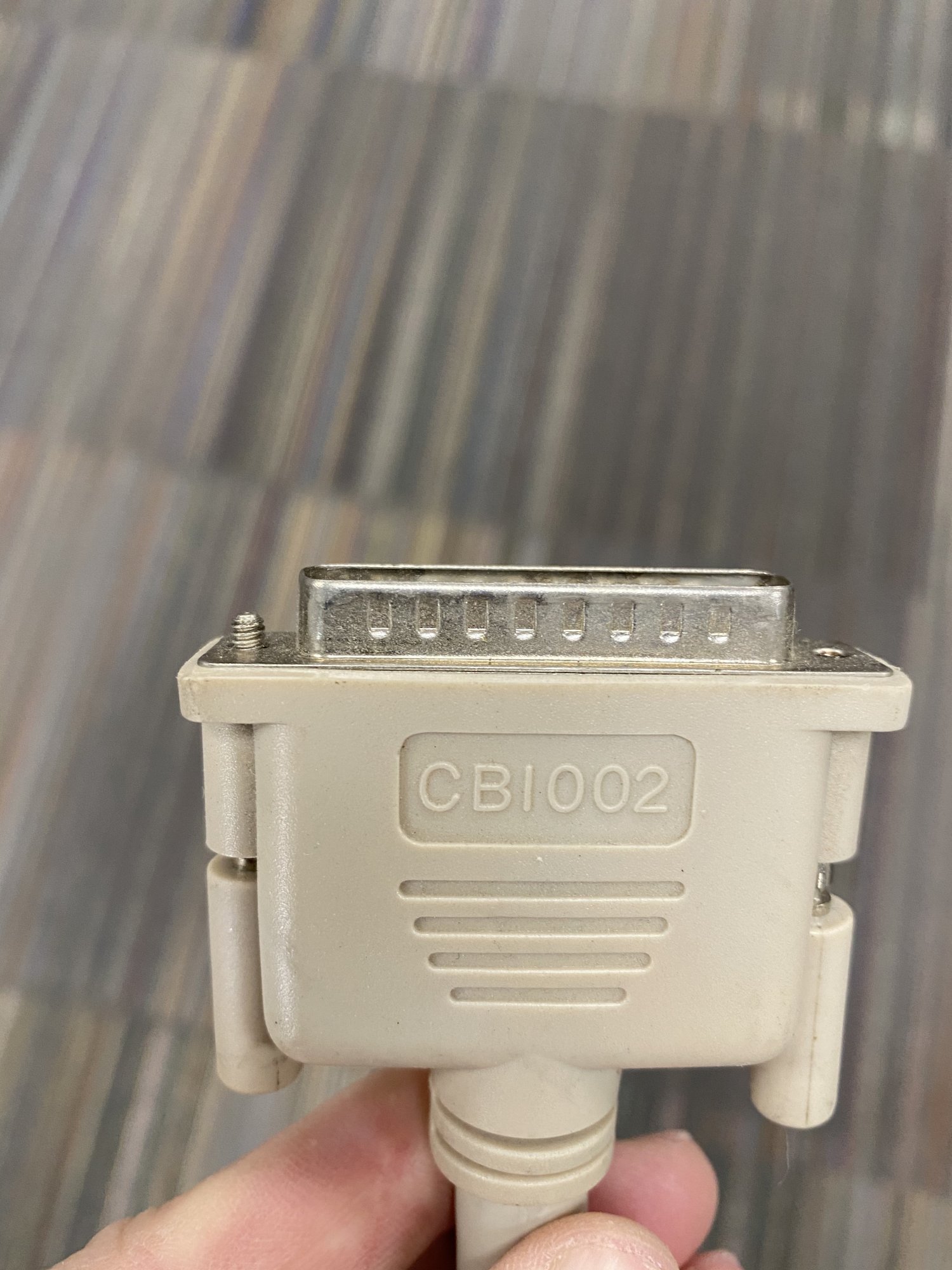

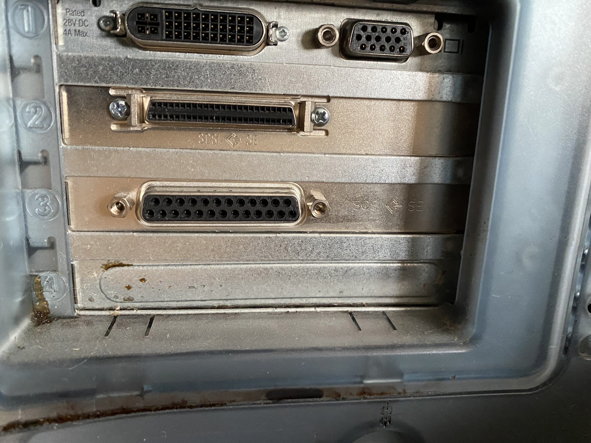

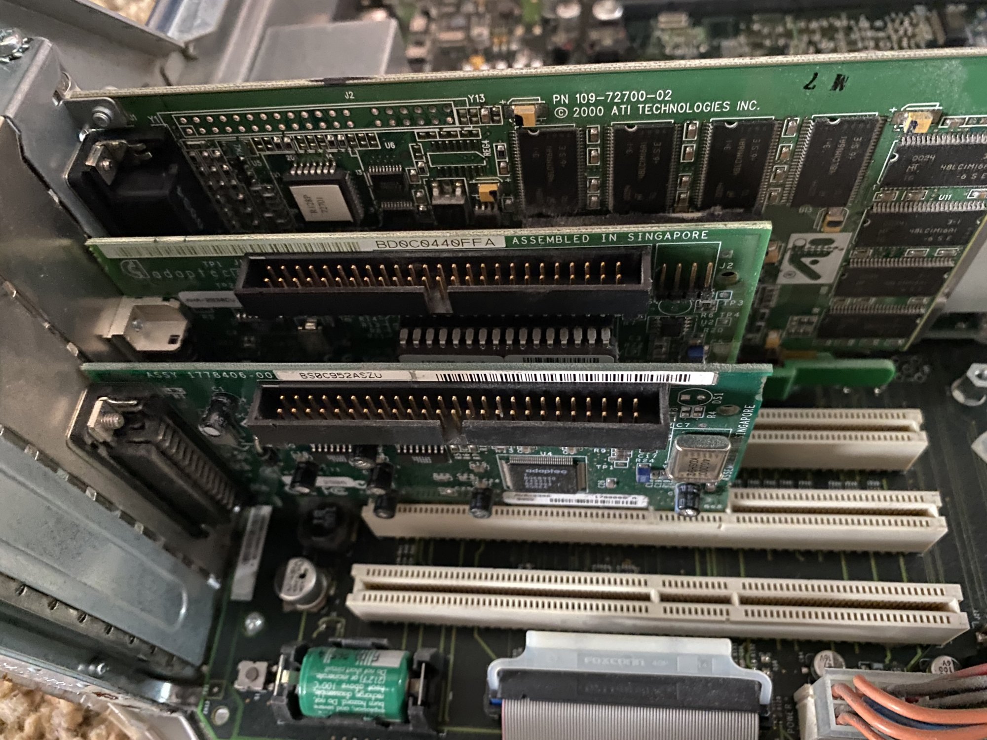

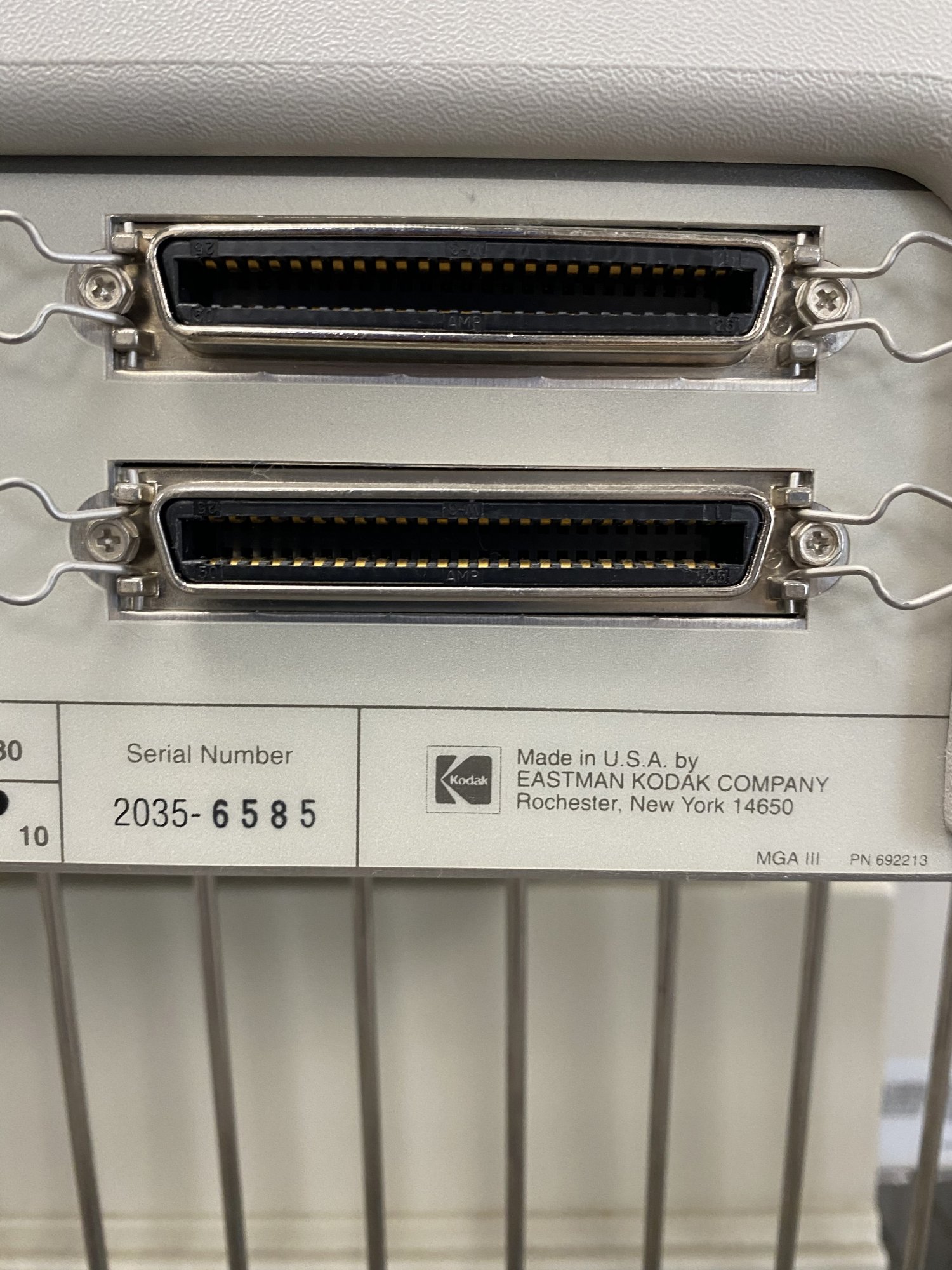

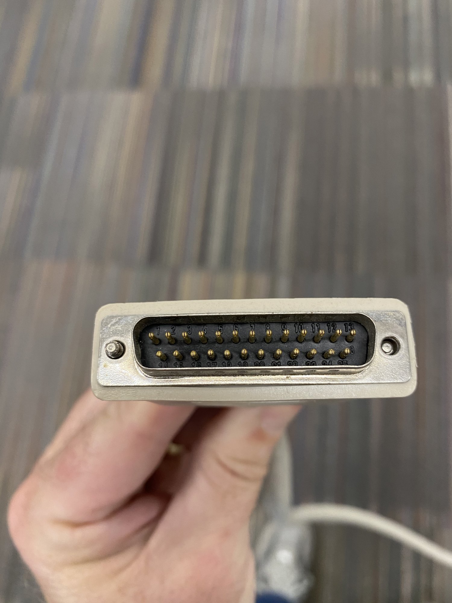

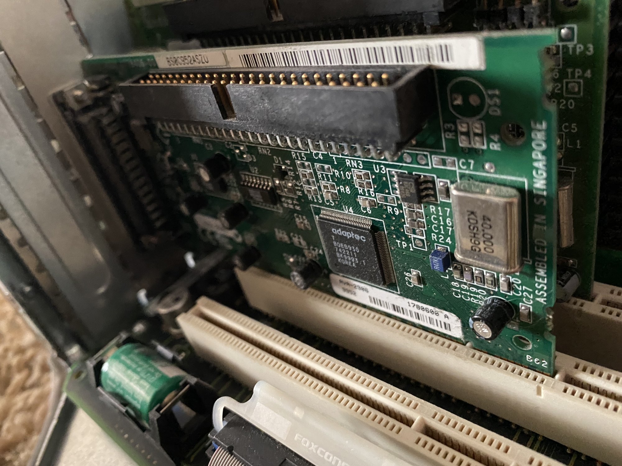

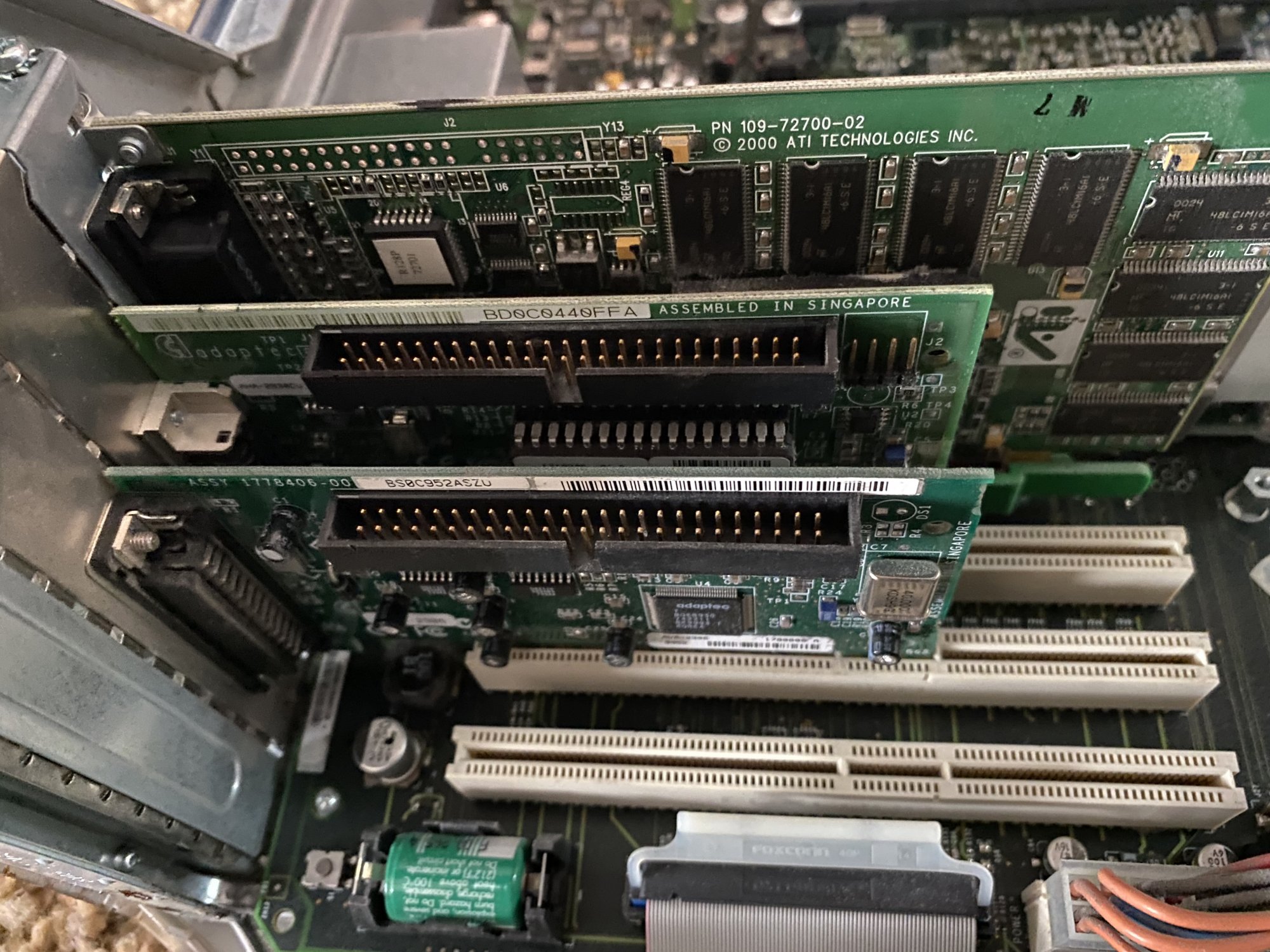

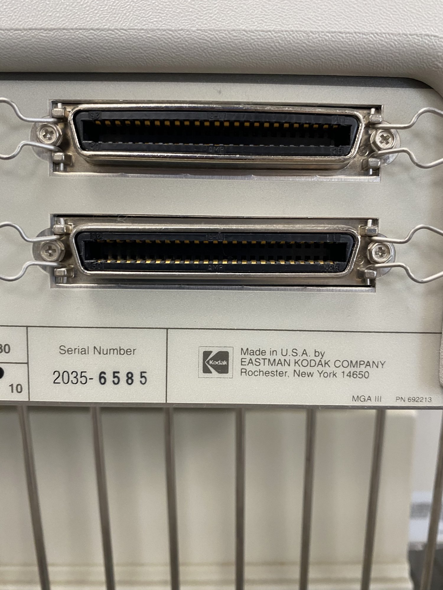

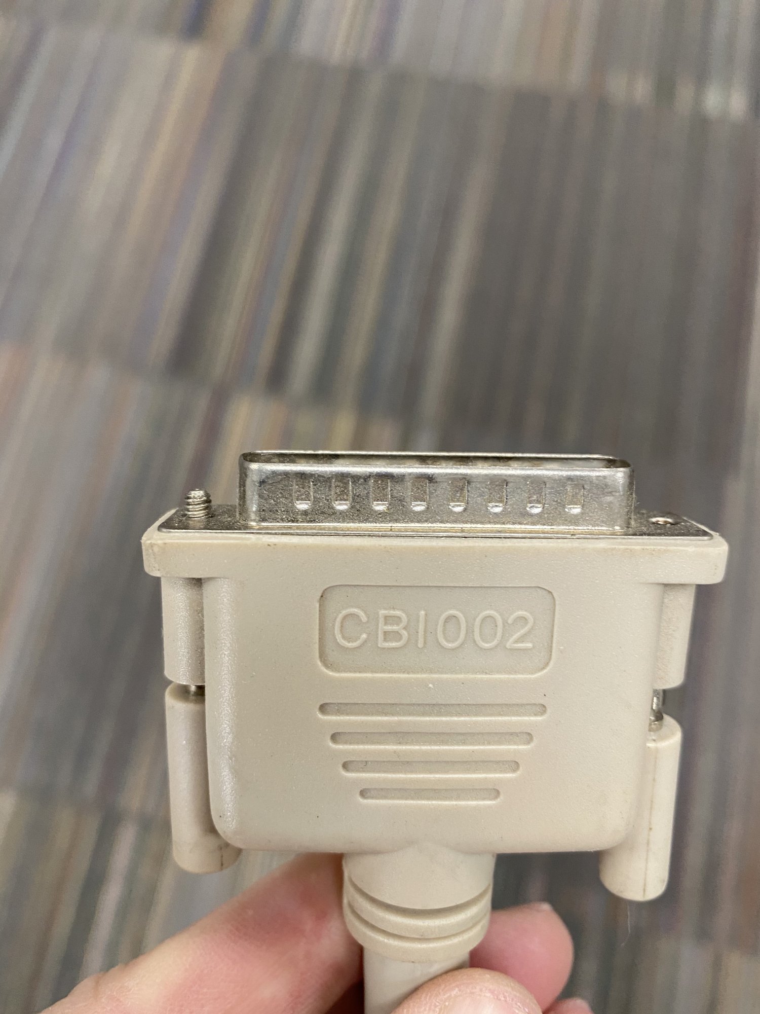

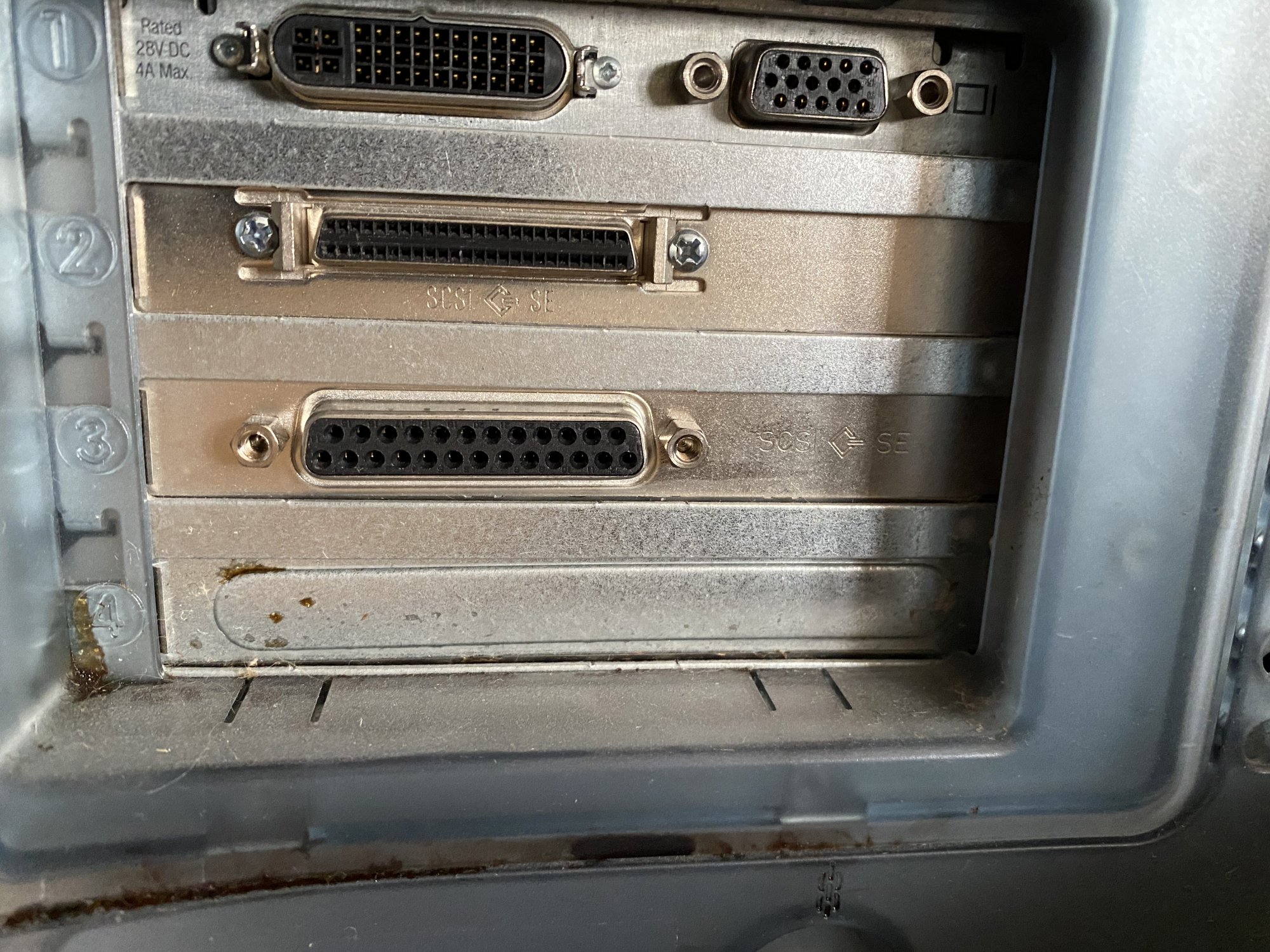

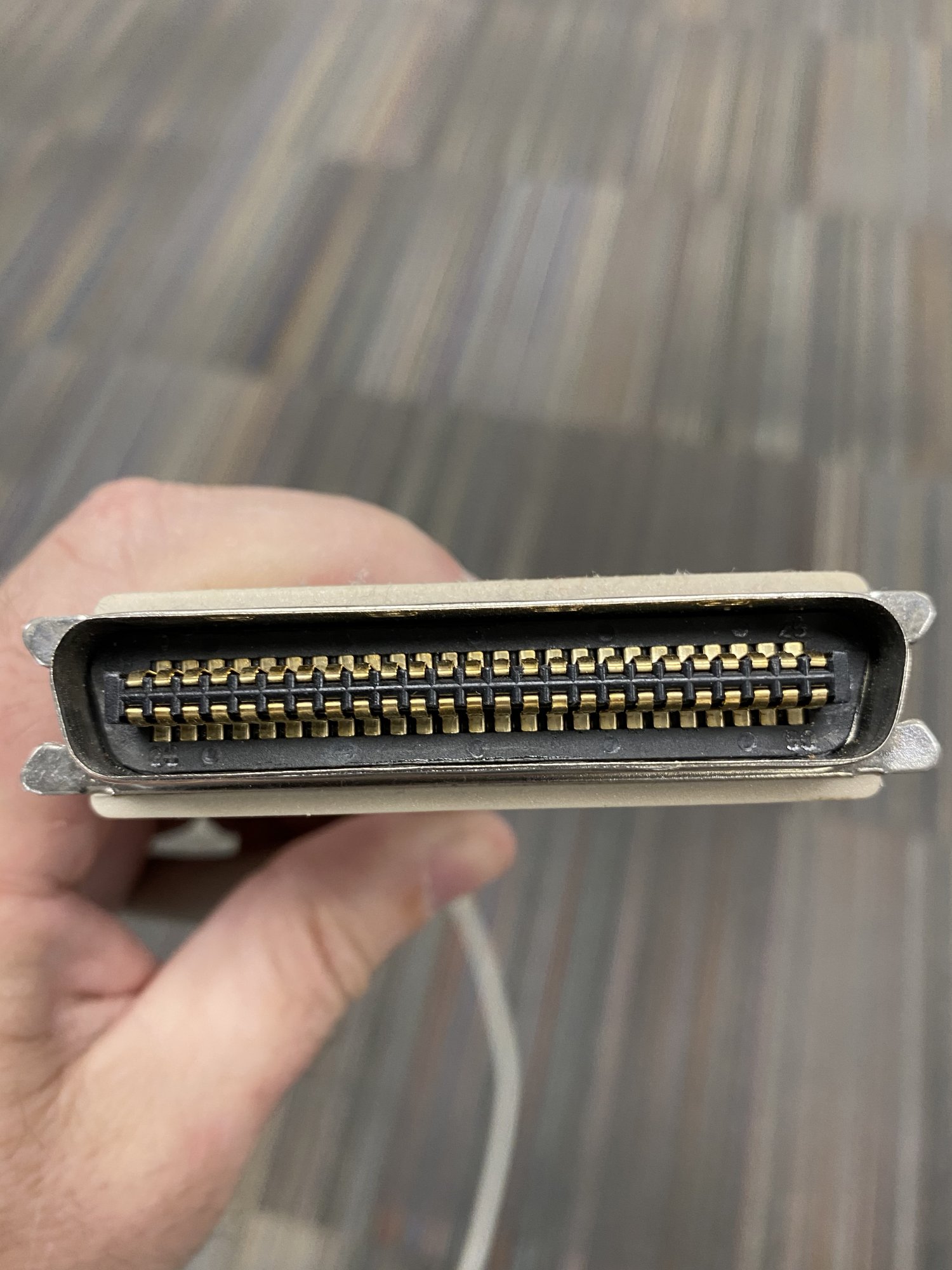

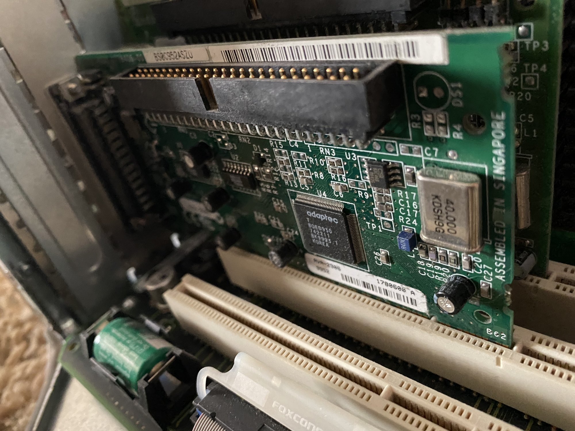

I just uploaded some images of the scanner (Kodak RFS 2035) ports; cord that connects from scanner into the G4; and the G4 ports and PCI (?) card. Not sure if it'll help anybody, but figured why not?

Looks like you have the same two cards I detailed in my last post that I have. Like I say, they should work in a G5 with PCI/X slots.
Your scanner cable is 25 PIN external SCSI, so really you only need the AVA-2906 and 10.2 or later should have built-in drivers for that card.
I'm unsure if you need drivers for the scanner itself?
Also, you will need a terminator for that last device on the SCSI bus.

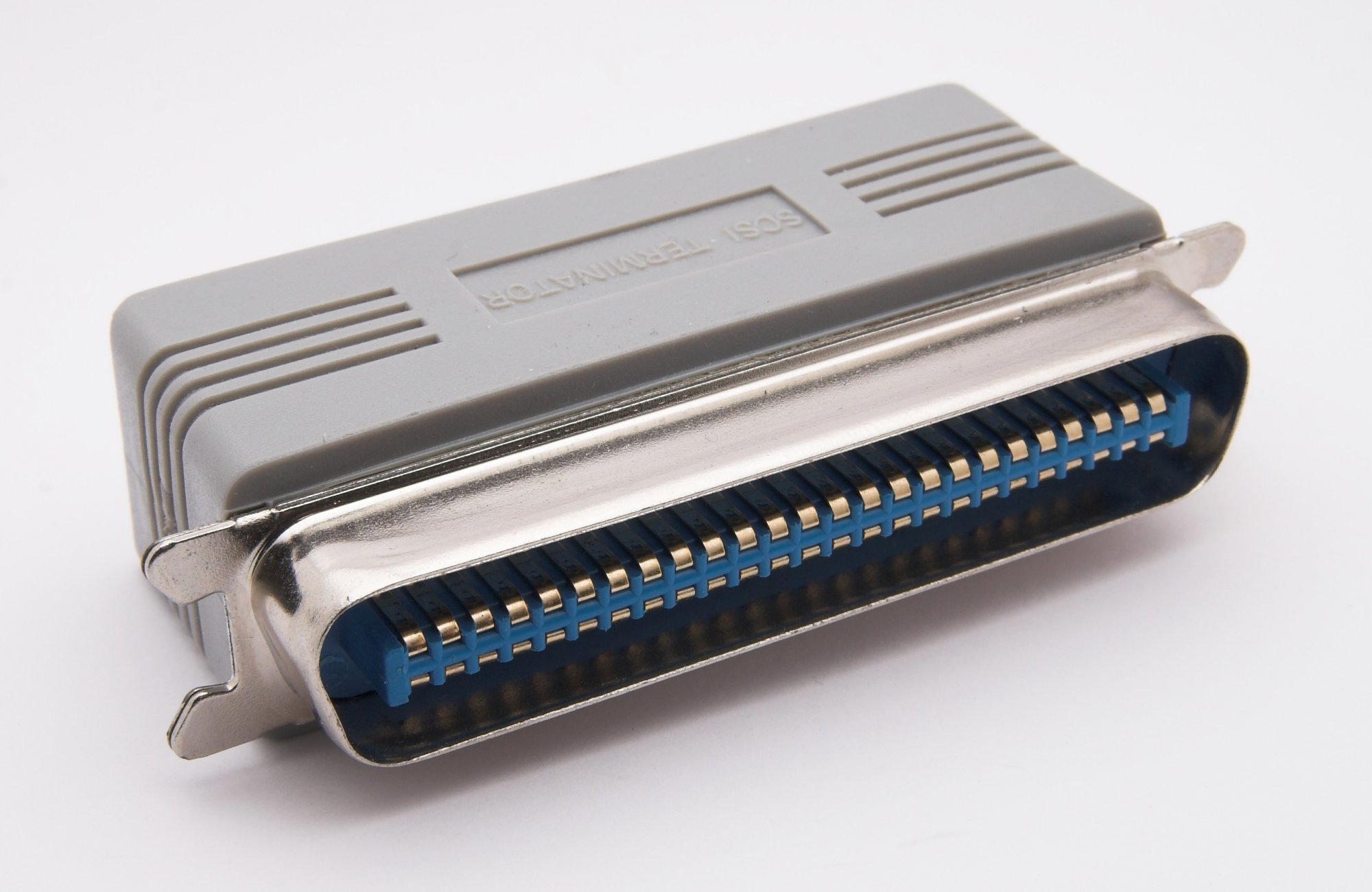

See if you have one of these laying around or connected to one of you scanners, it's a 50 PIN external SCSI terminator.
SCSI is daisy chain-able, normally the host card is ID 0 and you can set the devices 1-7 ID, and the last device must be terminated.
Not a 50pin, strictly speaking, although there are 50 connectors there. These are called Centronic ports, cables and terminators if you are going to do a search online for one.
You have been really helpful. I appreciate it. And, yes, we do have some terminators laying around... somewhere. Good thing we're hoarders in the newspaper biz.
