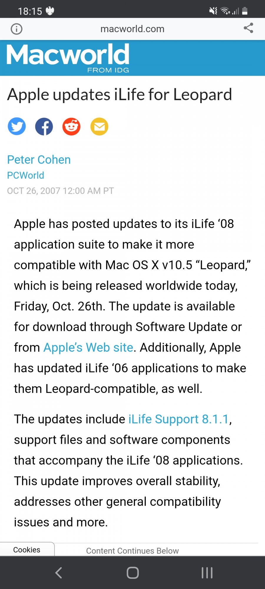

You know, that's got me thinking - could this actually be a problem caused by my version of iLife...? I'm pretty sure I'm still on '04 which came with Panther all those years ago... Could this weird screen refresh issue be simply that I need a newer version with Leopard?
I'll grab '06 and give it a try...
Reactions: RogerWilco6502
Poking around I found this article about Apple releasing updates for iLife 06 and 08 to make them compatible with Leopard... Which suggests (a) updates were needed and (b) they didn't update 04 which presumably also could have done with some...
