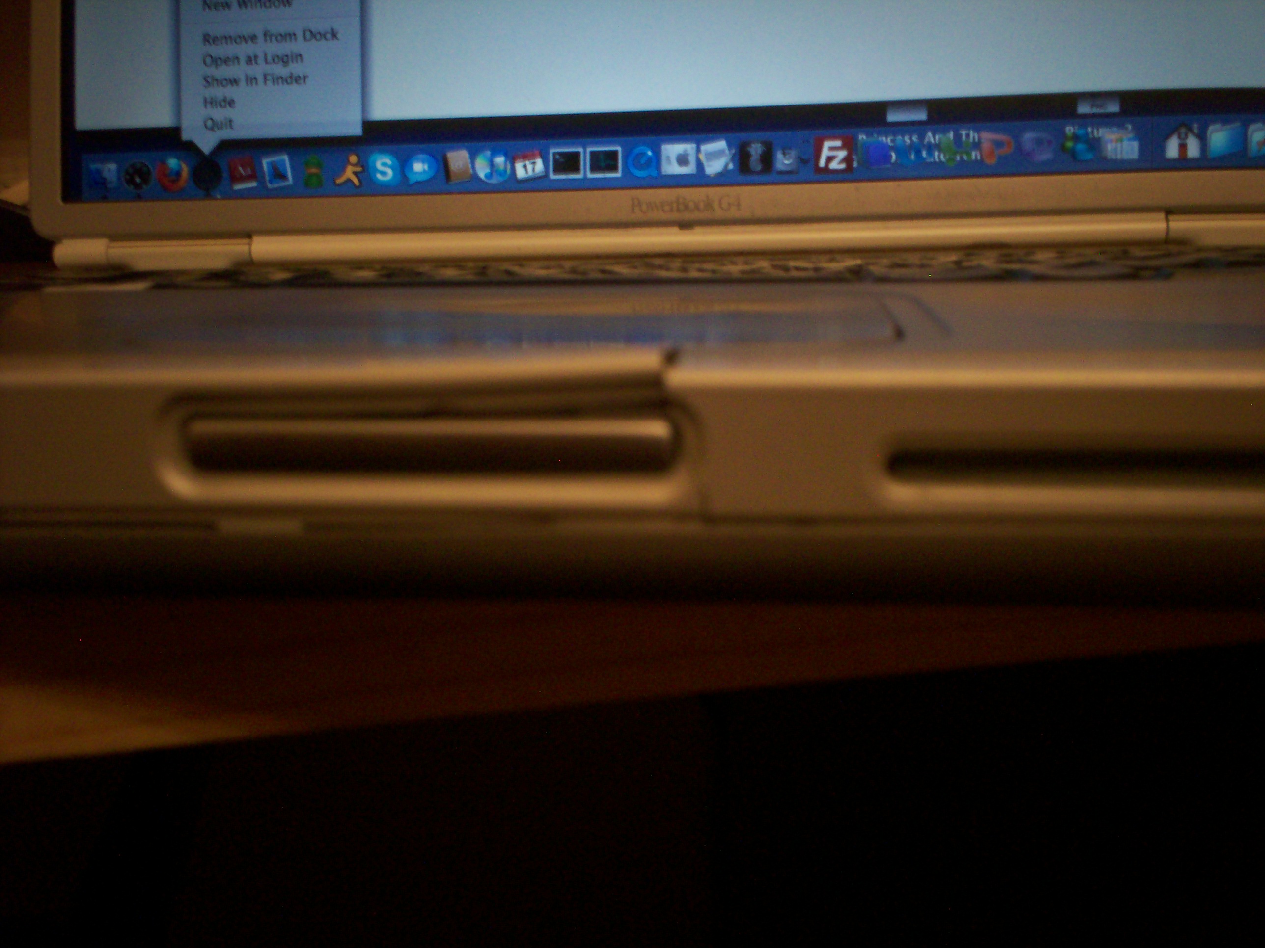

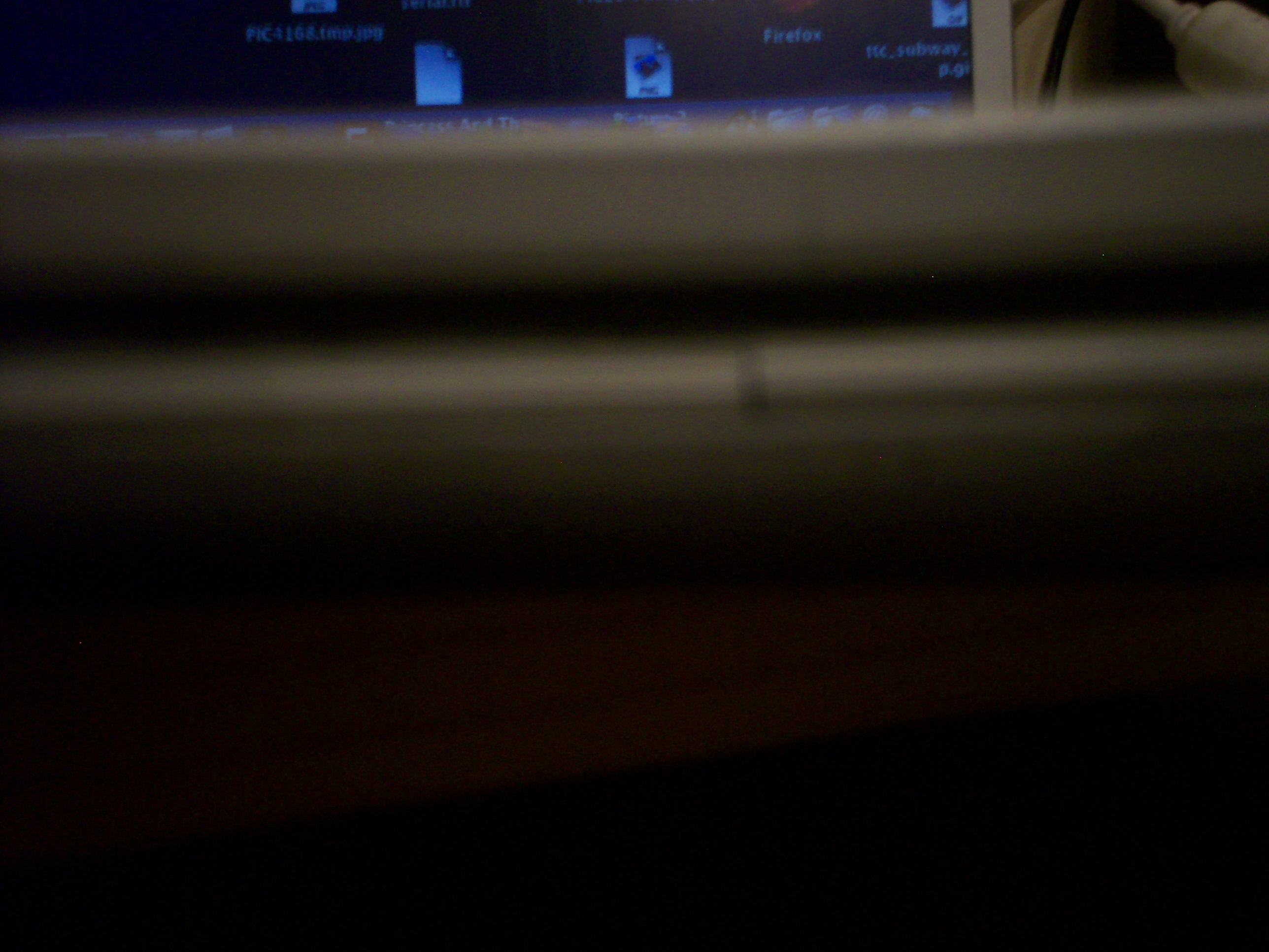

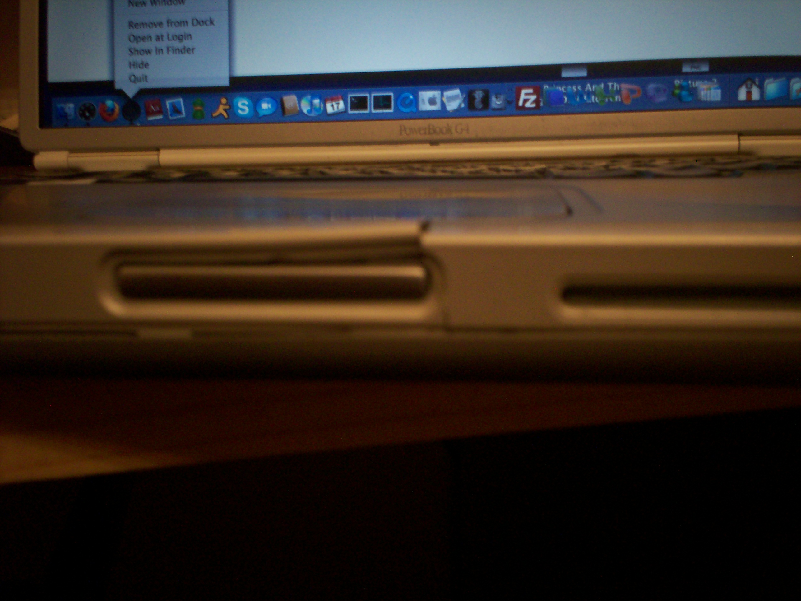

its actually not the famous hinge issue. the front near where the latch and where the latch is is cracking. the hinge is the one thing that has always been ok. amazingly.

You just need a new palmrest.
It is really not that hard to take apart the Titanium Powerbooks.
You also just need a new dvd drive. Your problem, if you have the original release of the Tibook, which I think you do, is that you need a weird adapter inside the case to update your DVD drive to a modern dvdcd burner superdrive.
Find a good, non cracked palmrest on ebay and install.

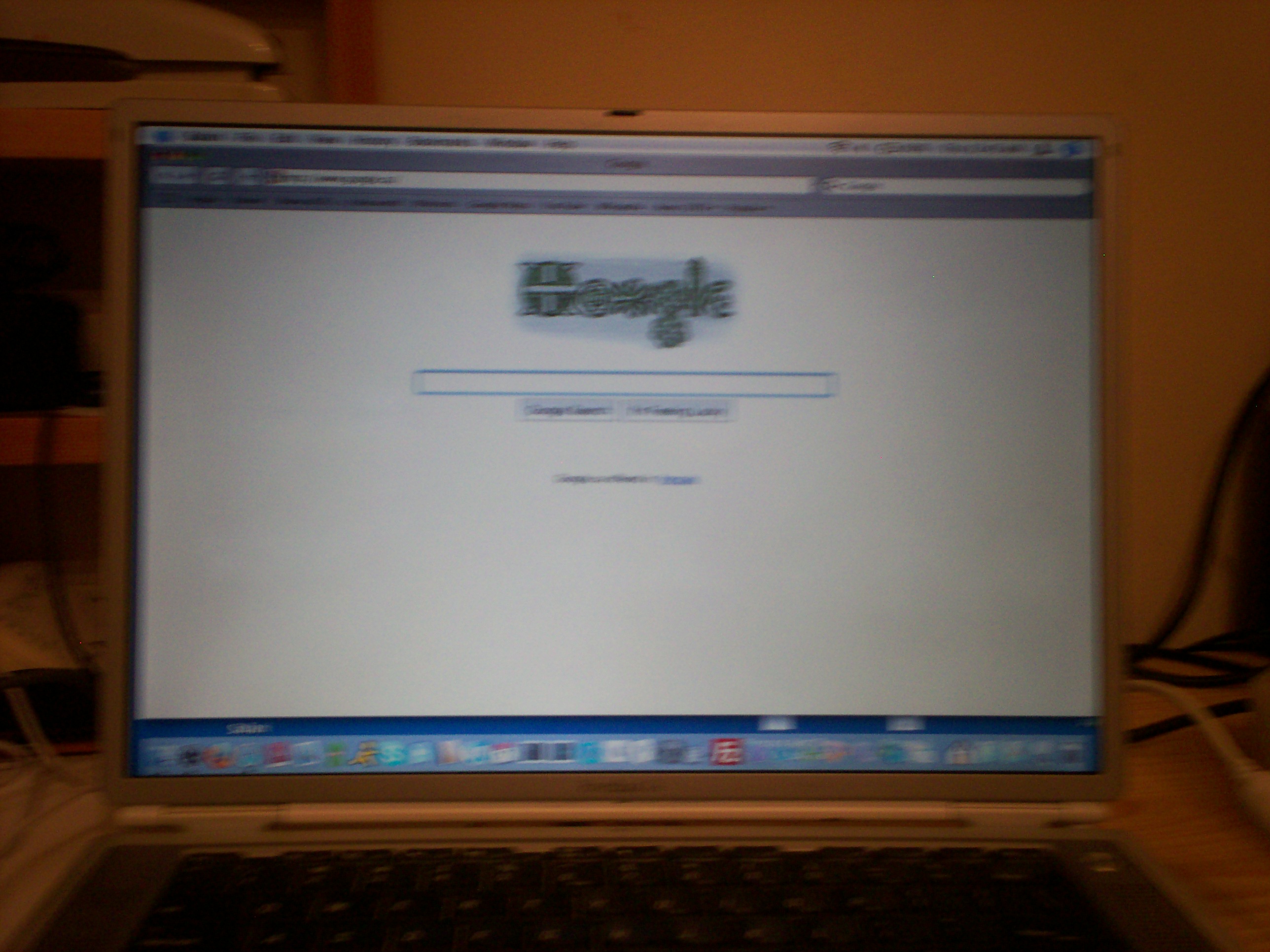

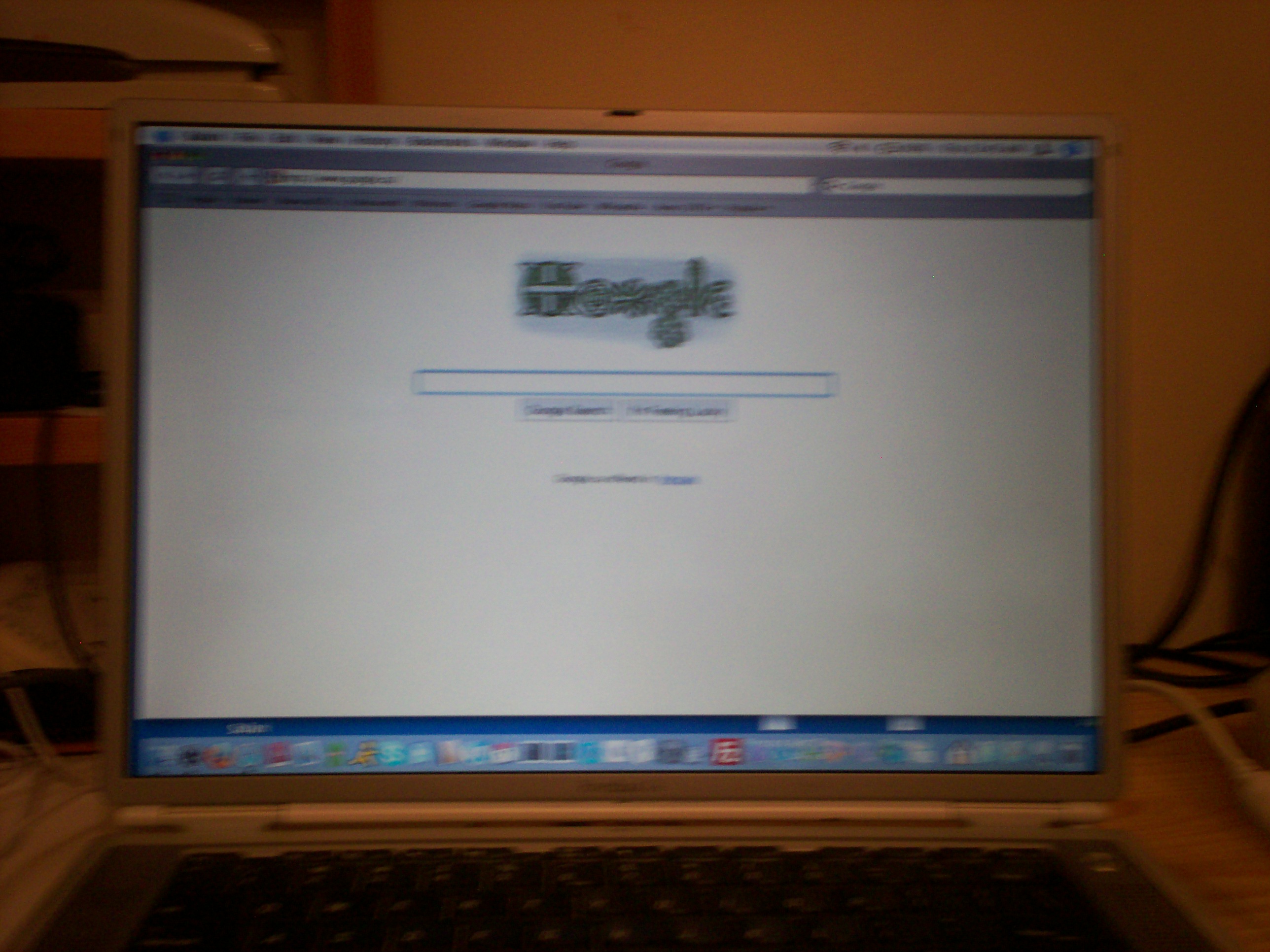

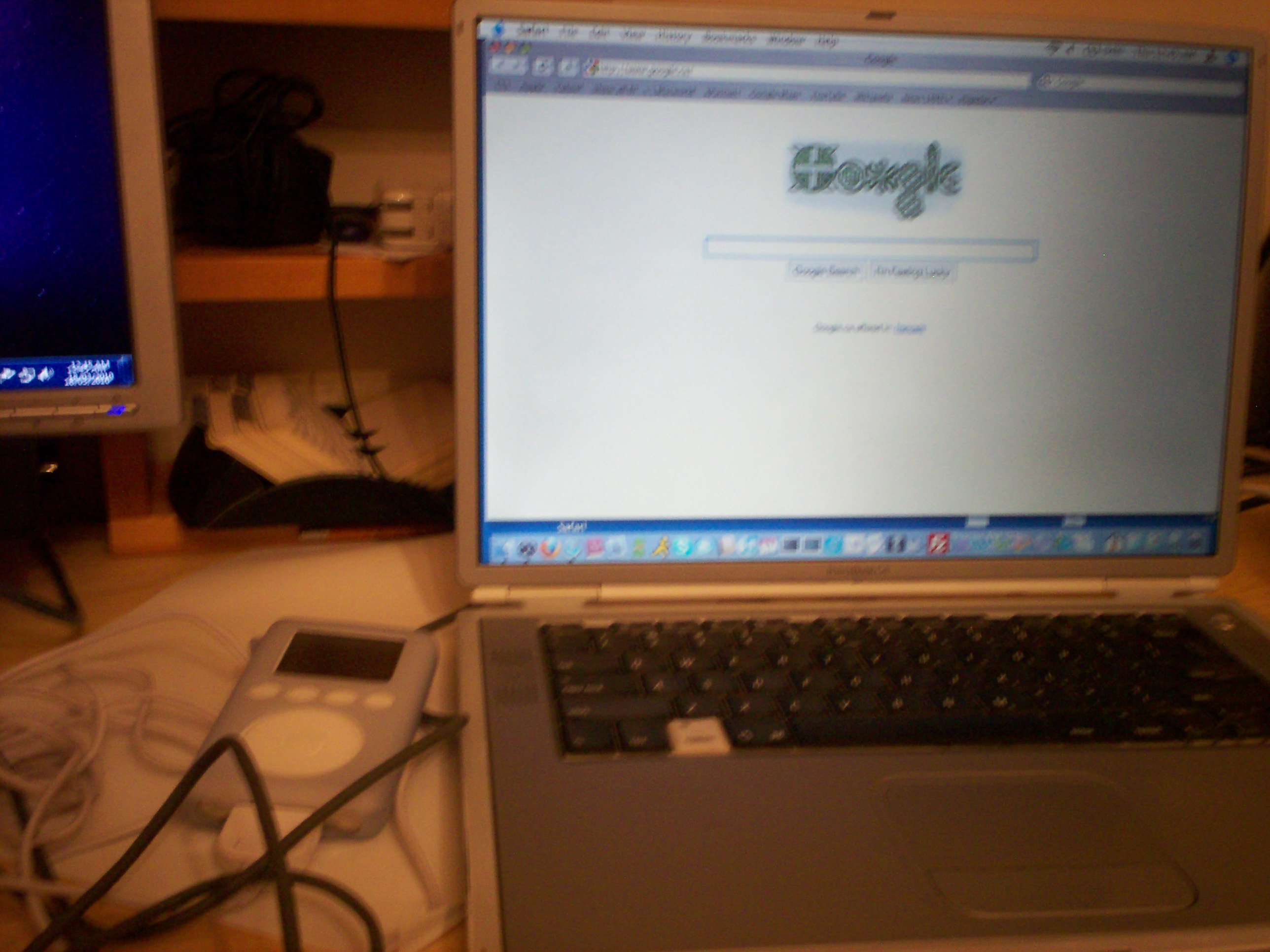

The tape was missing... THE DISPLAY IS FINE AGAIN! I put a piece of paper under it and wrapped it around. MANY MANY THANKS!
Maybe i can get this to keep going for a little longer, until i buy that iBook. He is gonna hold onto it for me atleast until september.

Also, looking at the pics, if you can push that topcase back to flatten it, then the display should latch. The latch itself is attracted by a magnet in the top case and should flip out when about to close. If the cracked part won't stay together, you MIGHT be able to (space permitting) glue a flat piece of plastic on the UNDERSIDE, like a bandage across the crack. ALWAYS use minimal glue. Don't squeeze out a whole tube of super-glue!!!! 😱
Oh, and take the bottom case off, and with a small amount of super-glue, glue the plastic on the bottom case part around the edges back down (you may need to rig some weight on the plastic to hold it against the metal) and allow a few hours to cure before putting the bottom case back on. Remember to position the bottom case back a few millimeters and slide forward and down to latch into position.

Just carefully snap the casing back together, and then glue it. Back in the day, some company actually made a product called TiPaint to fix up the sides of cracking Tibooks. If you can find that paint, good luck.
Don't glue the bottom case to the topcase. You will never get it apart again. If it is not closed down properly, it is because there are some tabs inside that aren't aligning.
You may go nuts as I did trying to figure out the superdrive fix on those, it comes down to a yellow connector. I think, but I am not sure, a DVI tibook connector might work but I have no idea anymore. Call Gary at Daystar if you are really confused. If you still want to keep the tibook, you should also upgrade the hard drive. even if you get a new computer down the line, you can always swap back your old drive.
oops I see you did upgrade the hard drive. Good for you. Just back it up. You should also bump it up to 1 gig. I would sell you my 512mb chip but it is in a Pismo PB G3, needed.
Also, disable Dashboard for cpu power if you are running Tiger.
To be clear, I wasn't suggesting gluing the top case to the bottom case. Around the edge of the metal bottom case, is a plastic frame that comes away from the metal. This is what I was suggesting be glued back together. When these two pieces come apart, the plastic latches onto the top case per design, but the metal partially hangs down, exposing the plastic frame giving the appearance that it's not properly latched together.
