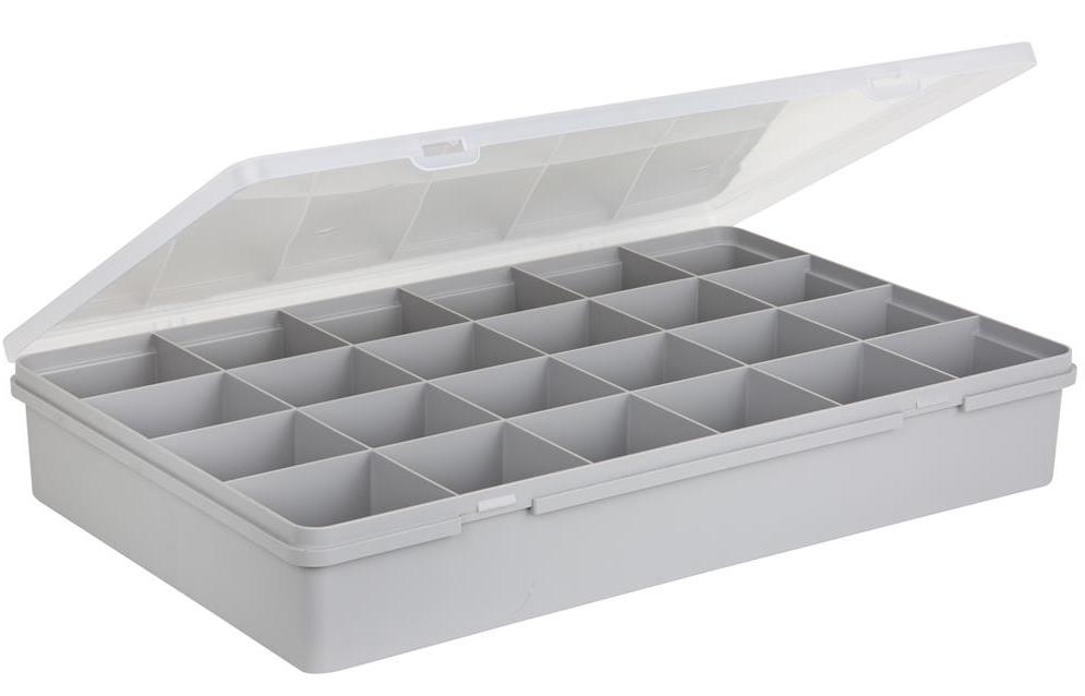

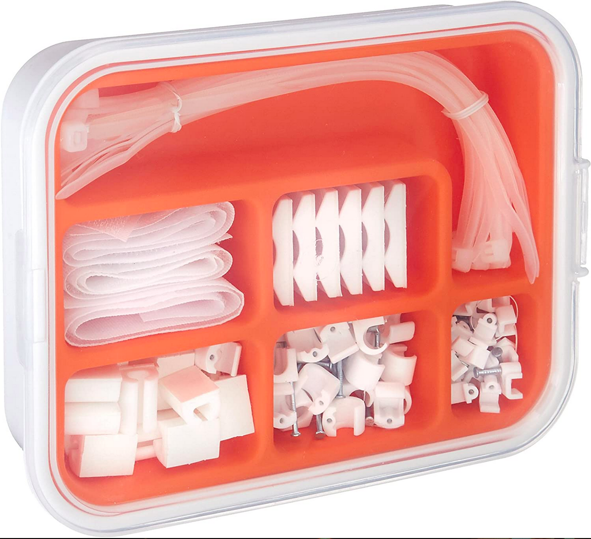

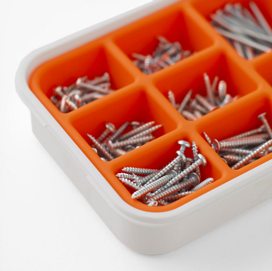

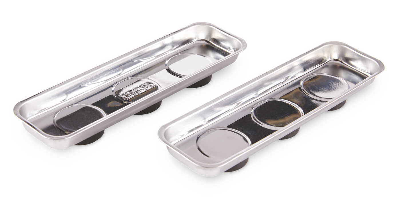

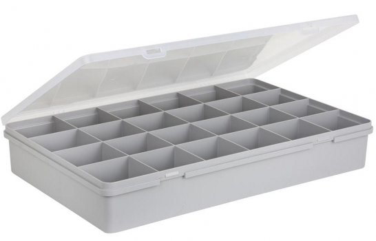

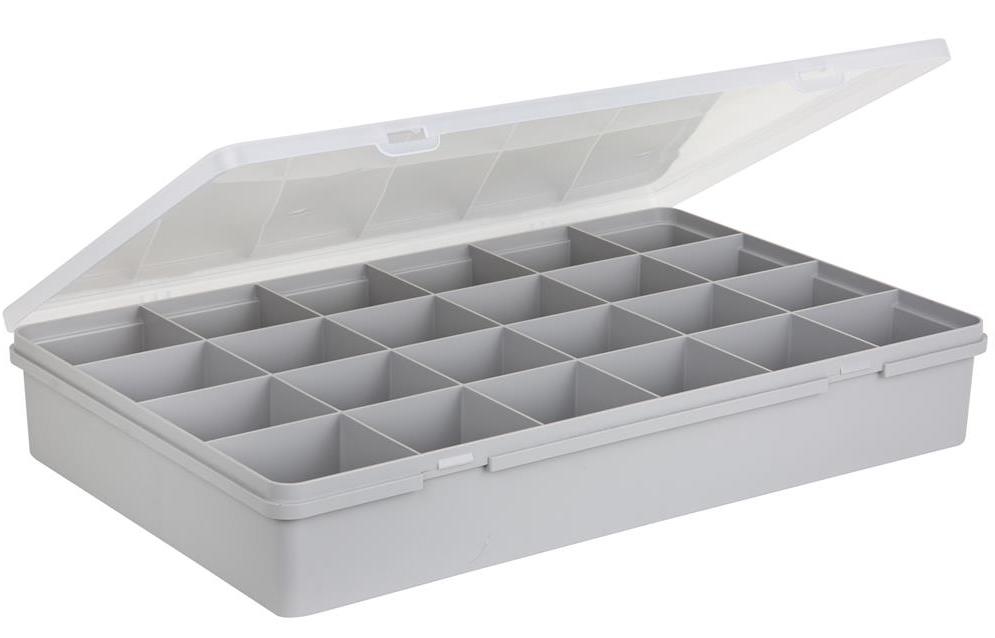

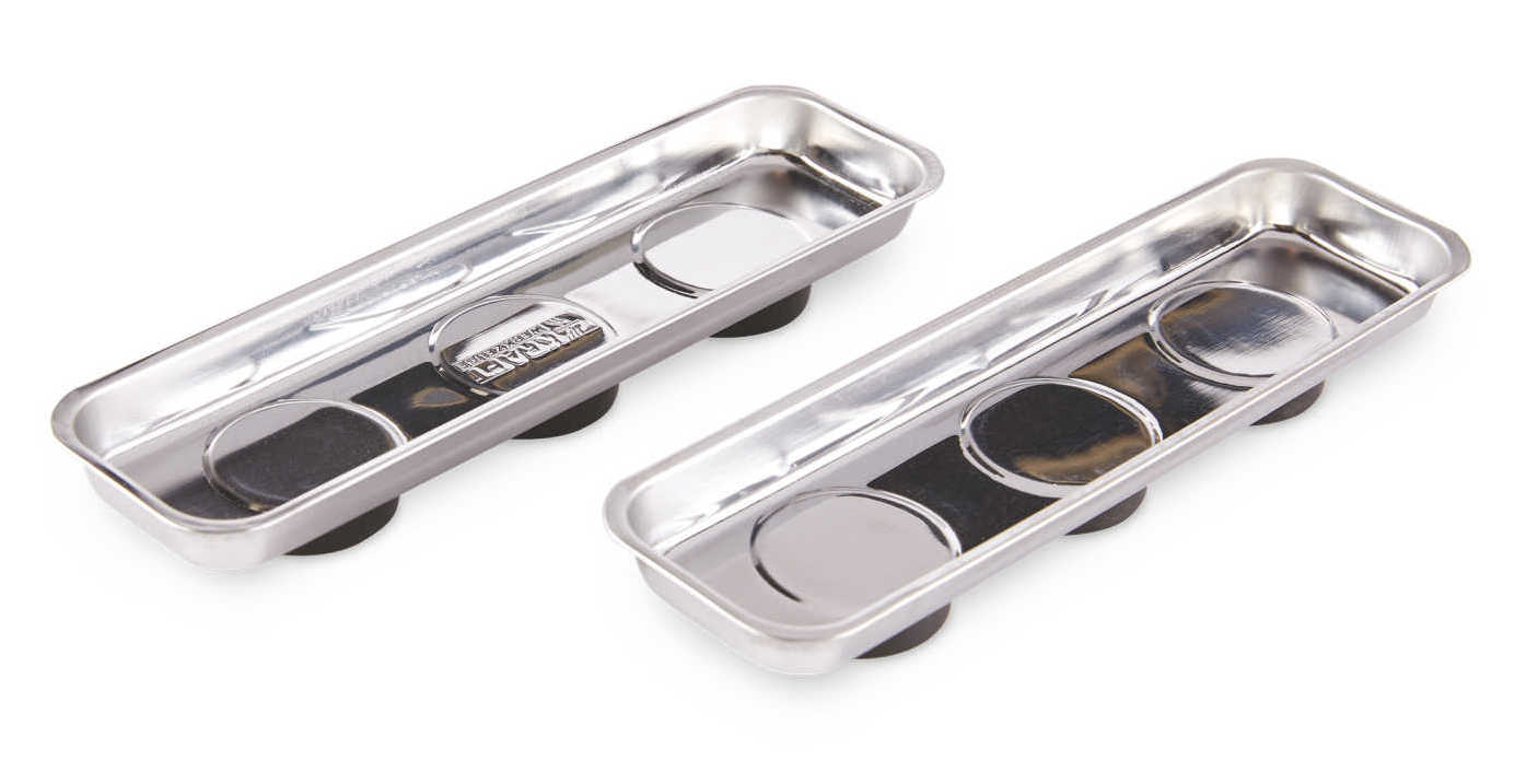

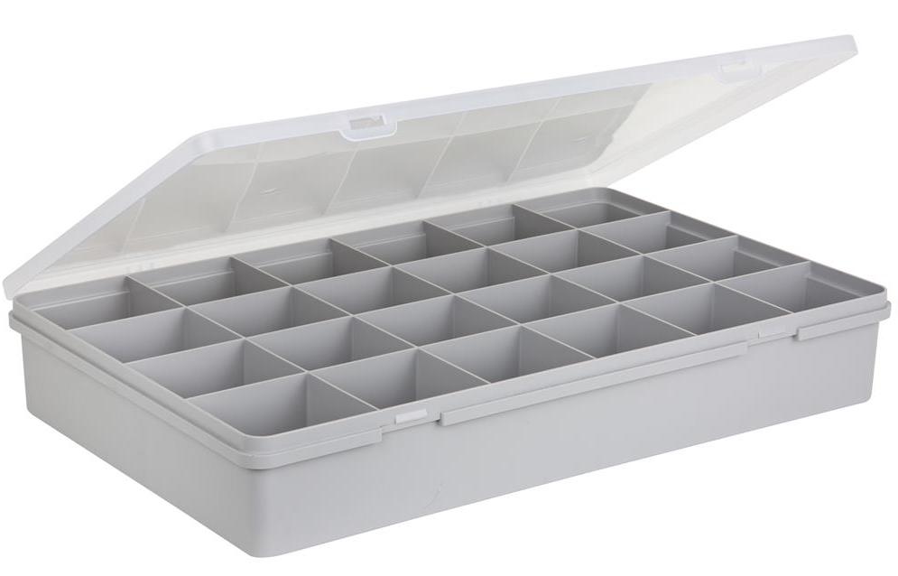

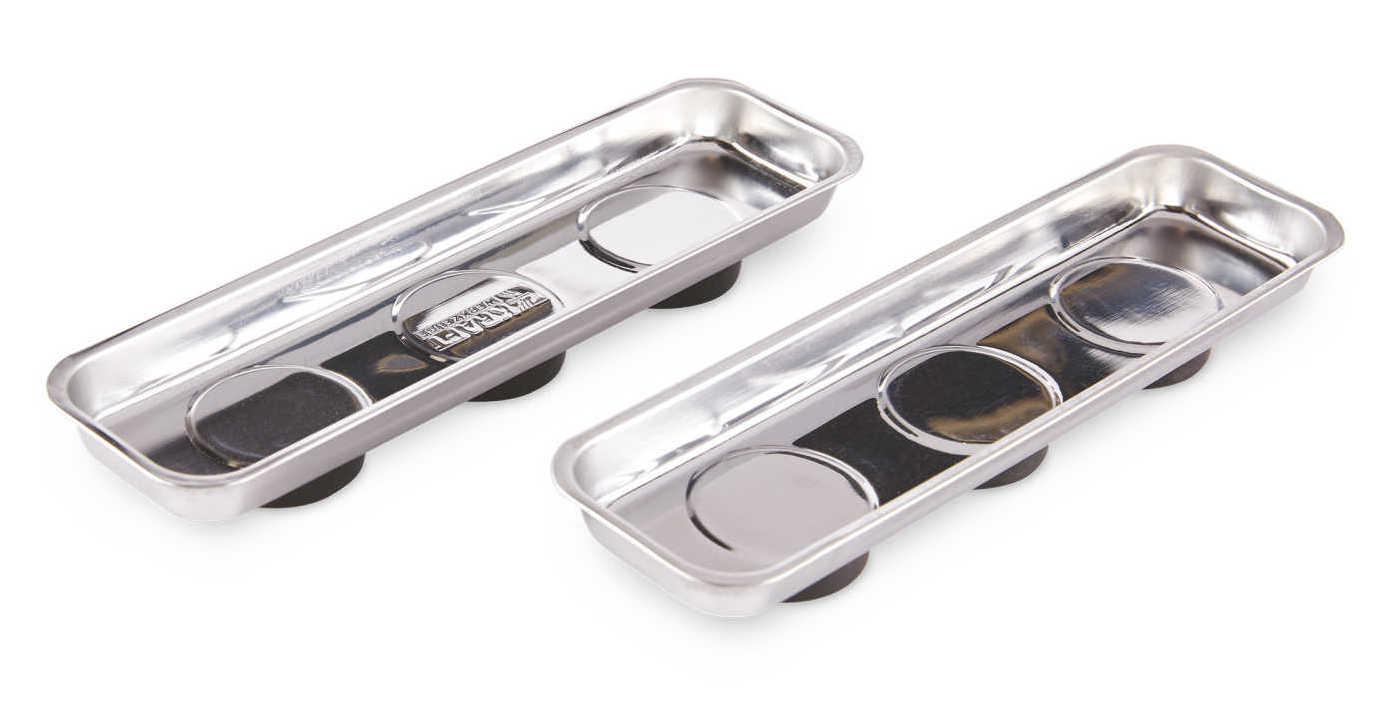

There are a couple of other cheap options for the terminally clumsy. You can get magnetic trays (Aldi and Lidl often sell those very cheaply in a range of sizes during DIY week) or, for larger jobs, I use a craft box with lots of compartments. These work the same as ice trays/egg boxes but have the added bonus of a lid as I am that clumsy and wouldn't put it past me to knock the whole shebang onto the floor.

NICE! I wish we had Aldi or Lidl in Canada!

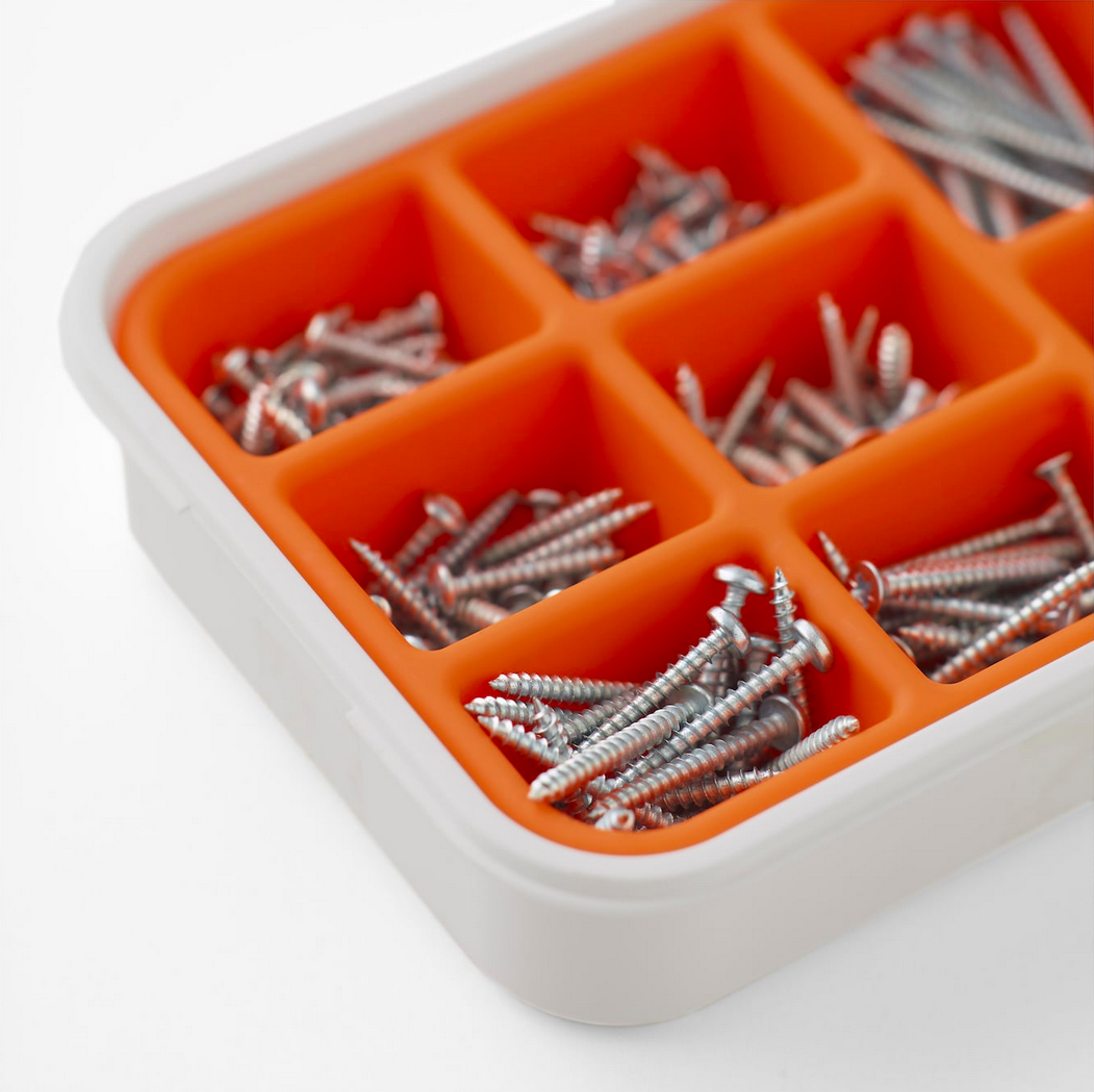

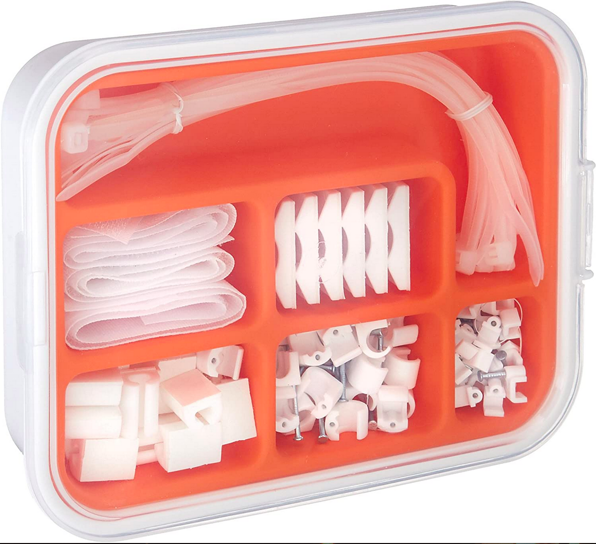

The second solution is giving me an idea, since I have a couple of these lying around: re-use IKEA FIXA parts boxes, once all the pieces have been used:
Reactions: Amethyst1
I tend to use one compartment per iFixit step, unless there is a mix of sizes that will be tricky to put back without getting them wrong, then I might split the step further. However, I have generally found the steps at the right level for breaking a disassembly task into manageable chunks and it lets me see at a glance if I have missed a step out in reassembling. One of the worst things apart from stripping a screw or breaking a standoff or cable socket is finding a surfeit of screws when you have finished putting the thing back together again.
