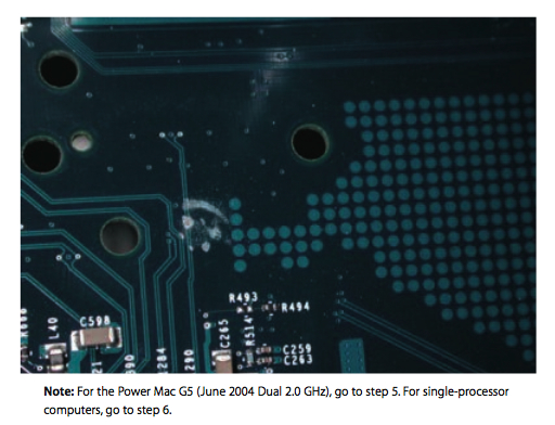

Ahh my bad - I misunderstood. Yes, per the linked service manual, you can indeed check each processor by removing it and attempting to boot off of the other. Here's the included trouble shooting process for that scenario.
Power Mac G5: Power-on LED illuminates when pressed in, but goes
out when button is released, fans spin, and there is no boot tone or video
1.Verify that the processors are properly seated.
2.Verify that the processors’ mounting screws are properly tightened.
3.Remove the processors and check for damage to the logic board under the processors. If you
see damage (see example below), replace the logic board.
4.Remove lower processor. If the computer starts up correctly, go to step 5. Otherwise, go to
step 6.
5.Replace lower processor.
6.Replace upper processor.
7.Check for trickle voltage on the power supply connector. Refer to “Power Supply
8.Verification” in this chapter. If verification fails, replace power supply.
9.Replace logic board.
Good luck.
