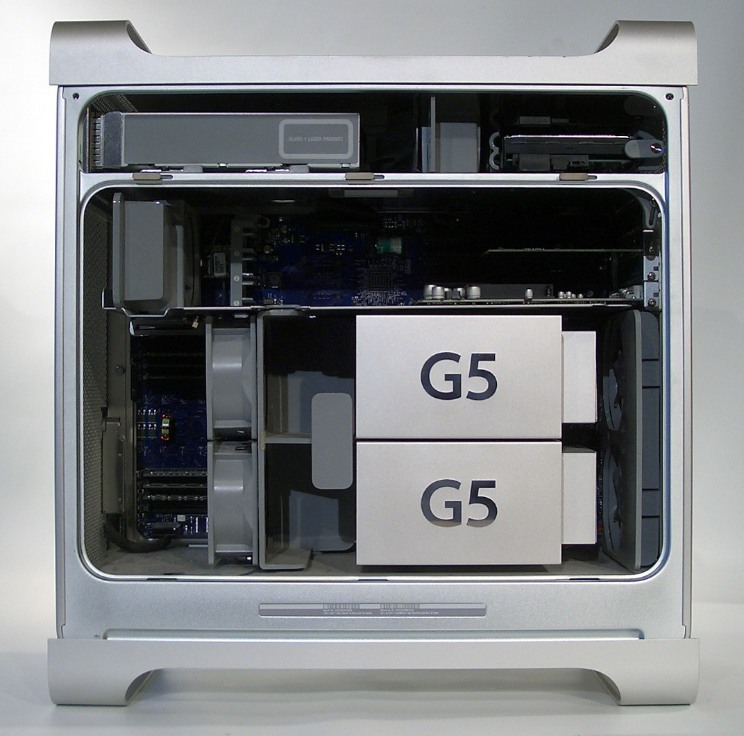

If the processors look like this:
It's the 2003 model.
If they look like this:
Then it's from the 2004 line.
