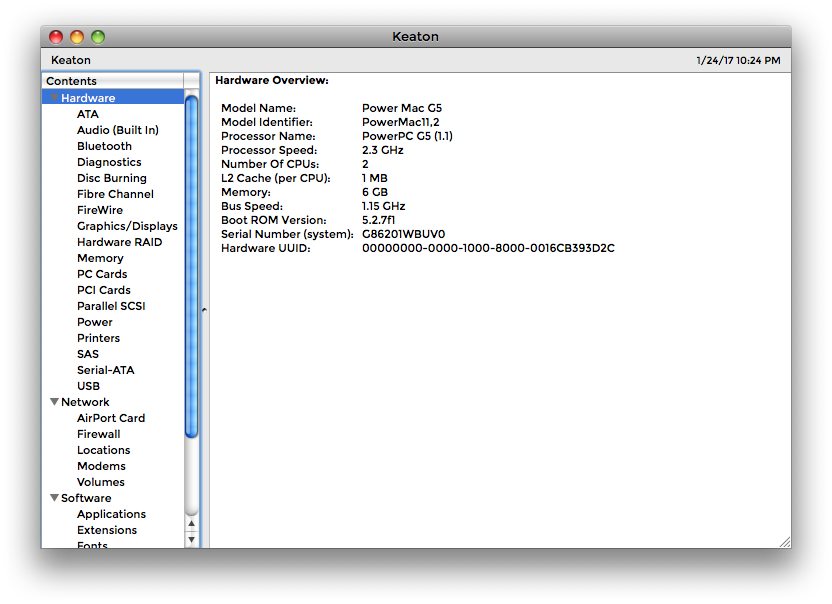

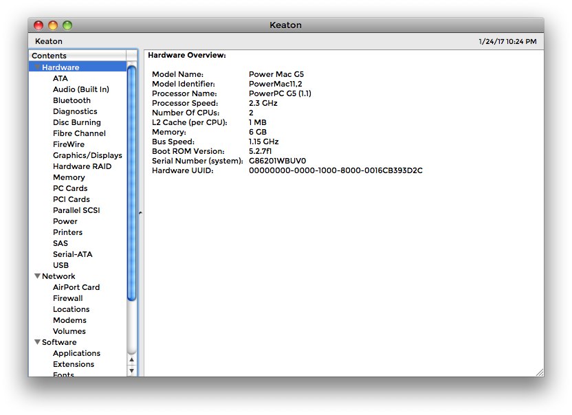

System Profiler screenshot from aforementioned G5. Look up the serial number (I'll save you the trouble by linking it here) and you'll find its original clockspeeds.

I'm confident this upgrade will work on any late 2005 model, but maybe not the earlier ones which you'll find most of the info saying it's not possible refers to. That is, provided your processor card isn't defective like mine was the first time I attempted this...

Your screen grab shows the bus speed is more than stock, how was that achieved? Again it is hardware set. Ive seen fake software hacks showing older macbooks as faster ones before. Just trading the cpu will not allow the bus speed set by resistors to change.

I don't think they have info specific to the late 2005 models. Easy to assume that what applies to the earlier models also does to the later ones, but in this case that is simply not true. All I did was swap the processor card, nothing else was modified. The system is running stable and saw a slight but noticeable performance boost from the upgrade.
