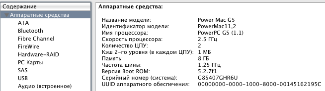

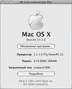

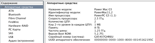

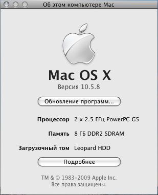

I just wanted to let everyone know that, yes, it is possible to upgrade a late 2005 G5 CPU module. I actually created a unique model of G5 by swapping out a 2.0 GHz stock module for a 2.5 GHz module from a broken G5 quad. The air cooler in that machine is massive, so it keeps up fine with the 2.5 GHz CPU's cooling needs. I hunted down a DMG of the Apple Hardware Test CD just in case it would be needed, but it was not! The Mac simply chimed to life and booted up to its installed Leopard system without a hitch.
