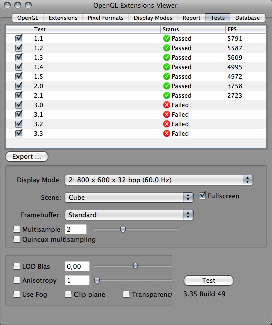

Here is a screen shot of the ATI 100% results.
Ooops! 800 x 600 @ 60Hz! This is small...
...so here is what you get out of a 7800GTX at this resolution. 😵 😉
