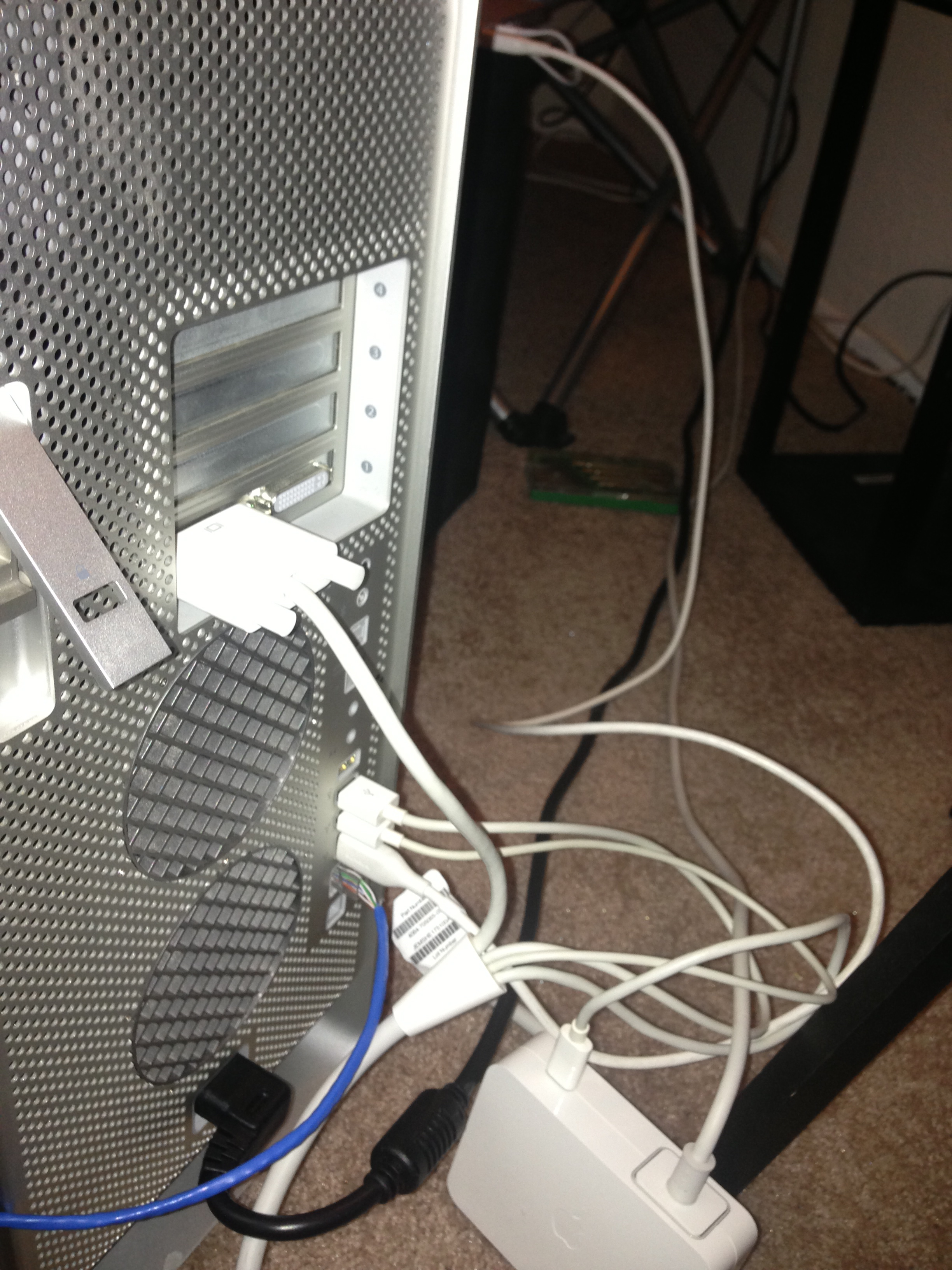

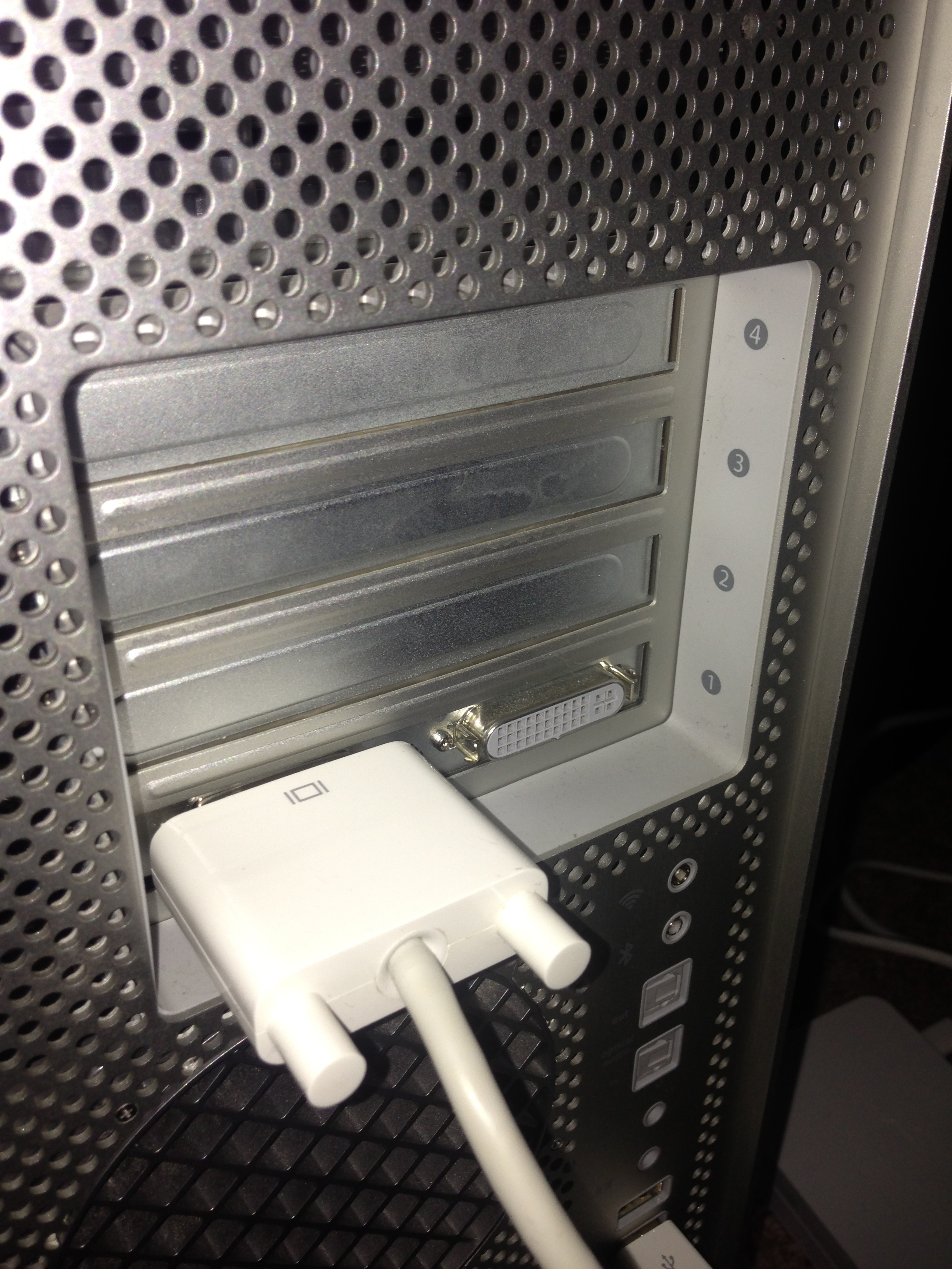

I bought a Power Mac G5 2.0GHz dual processor (M9032LL/A, A1047) off craigslist for $60. I also have an A1081 20" Apple display. The video card on the G5 has 2 ports: an ADC at port 1 and a dvi-i on port 2. The monitor has a dvi connector.
When I connect the monitor on the dvi (port 2) and power the computer on, nothing displays on the monitor.
I've never used either of these devices before, but the computer boots into target mode when connected by firewire to my macbook pro and I can take screenshots and view them in target mode.
I do not know if a monitor needs to be connected to the adc on port 1 for a SECOND monitor to work at port 2, but I only have the one monitor that connects to port 2.

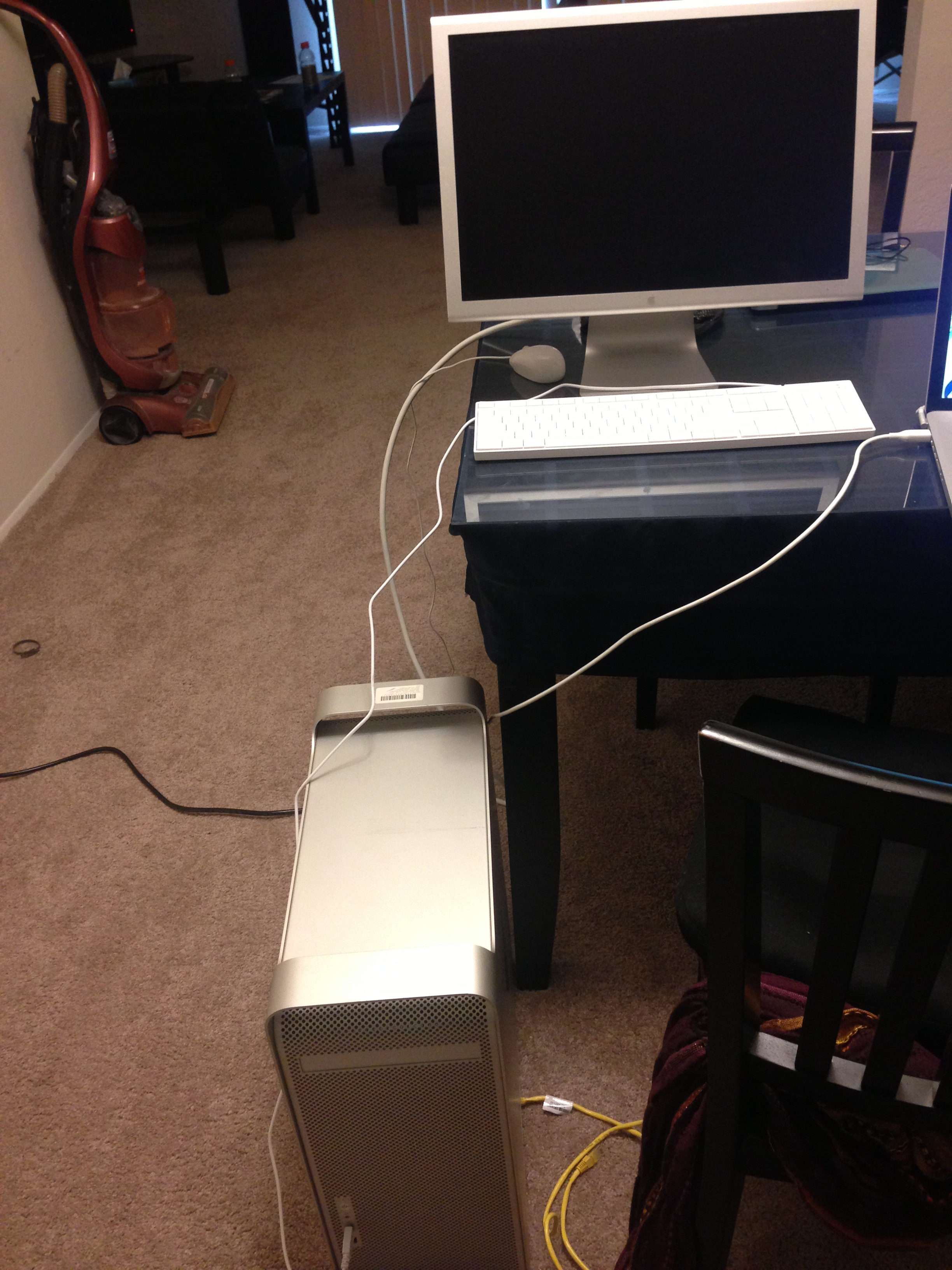

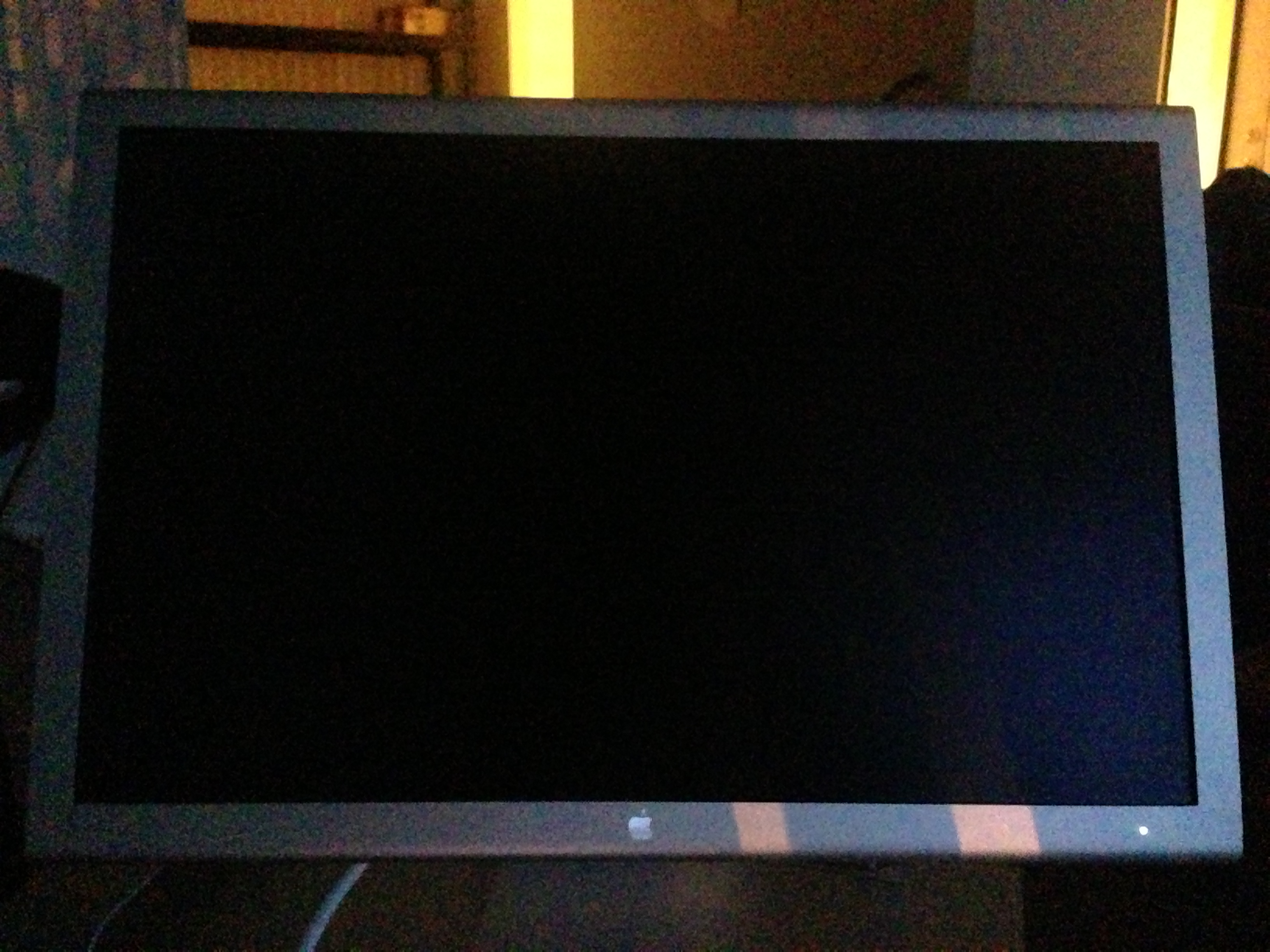

Stupid question: is display connected to power supply? I can't see it on picture, and its status LED is off.
If ACD is working OK, computer boots and you can take screenshots (as you've described) – graphics card it's shot – at least its DVI port.
It's powered on
The monitor has a cable which has firewire and usb, both of which are plugged into the mac, and a power cord that goes into an adapter which goes to the power outlet.
The monitor power LED is on.
When I power on the G5 I hear the boot noise. If I press shift + command + 3 on the G5, I hear the camera shutter and I can take several pictures of the desktop (although I can't see what pictures I'm taking in real-time).

I would try connecting the monitor to both ports on the graphics card before declaring anything shot.
I would also try reseating the graphics card - they do come lose quite often. Secondly, stupid question, but are you sure the graphics card is original to the PC? Sometimes craigslist sellers will take out the original card and stick an incompatible one in.
Nothing short of a $25 adapter is going to connect that display to the ADC port on that video card.

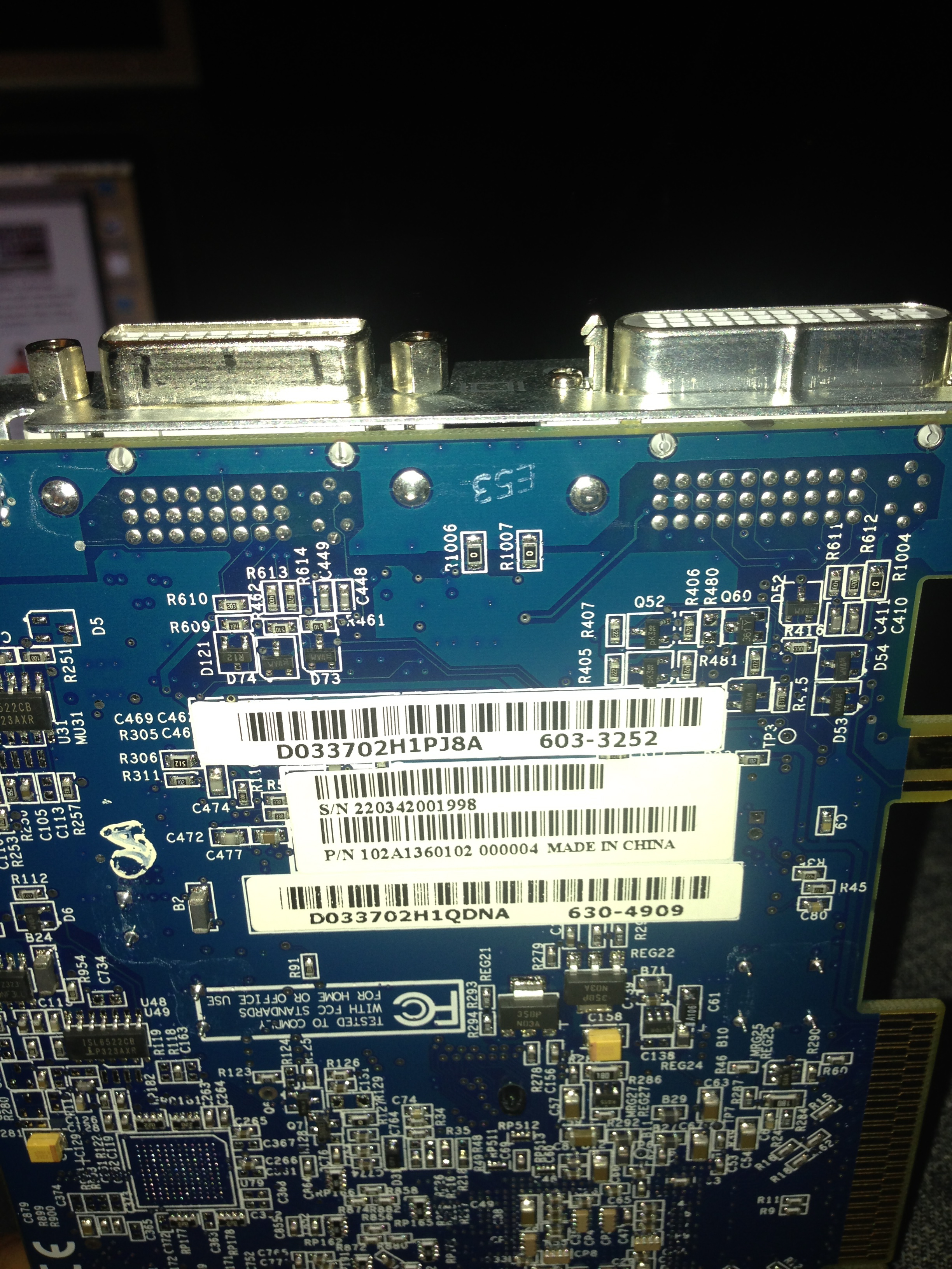

That's the ATI Radeon 9600 Pro card. It's the second slowest card offered on the G5 lineup. You can get another one of those or something faster. You can even cheap out and get the slowest card, the GeForce 5200FX.
