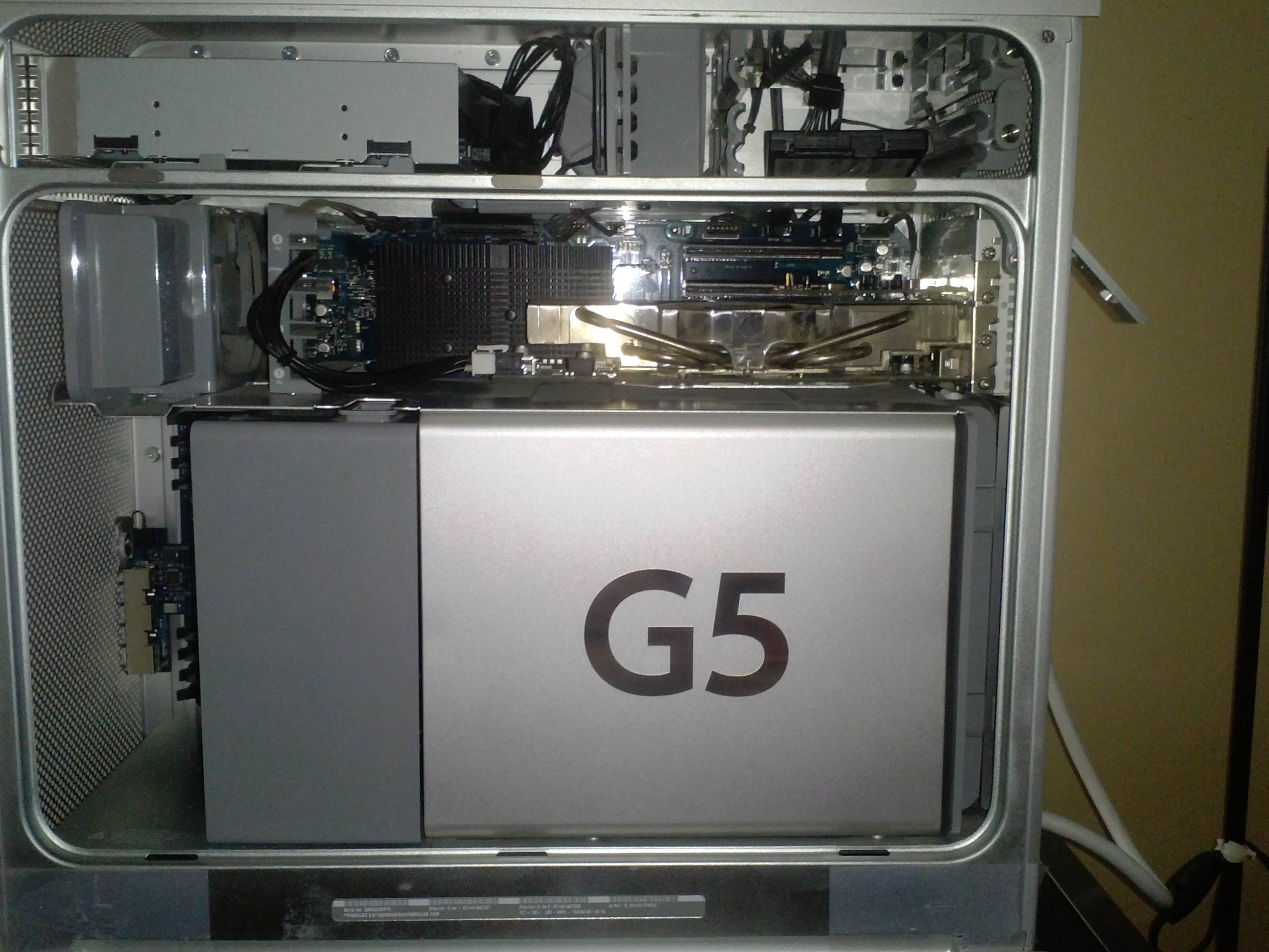

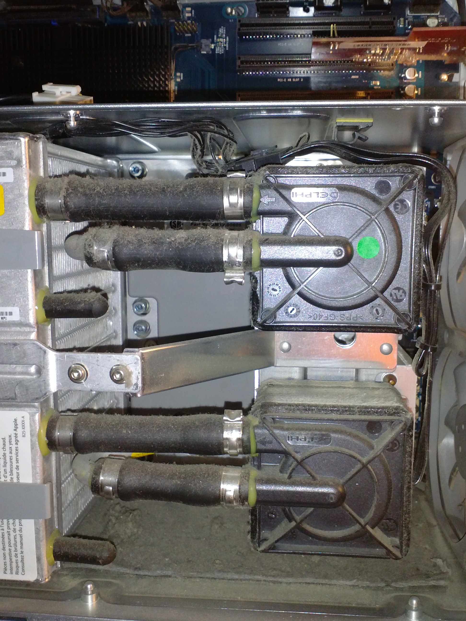

I got the side cover off and all I see is a ton of dust.
Again I don't see how this can be a problem if the computer is booting? I will proceed to the next step regardless.
Here are some pictures.
Ok now I am not so sure if it's worth removing this whole liquid cooler seeing how I could damage the CPU pins.
I really don't see any signs of damage.

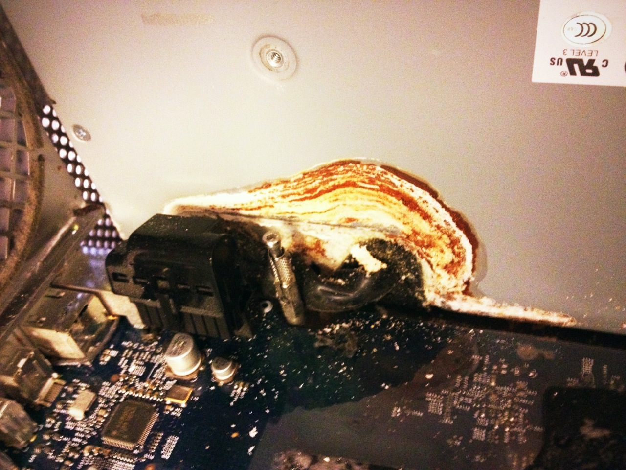

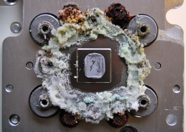

Get proper tools, study service manual from link I posted before, google "G5 LCS leak" and you'll discover that you have most prone to leak dual pump Delphi LCS. If leak is small enough to do not damage your computer yet, good for you. But you can't see it through LCS plate, can you?
Small leak (invisible through plate):
Bigger leak (still invisible through plate):
Big leak (visible through plate - too late 🙁):
