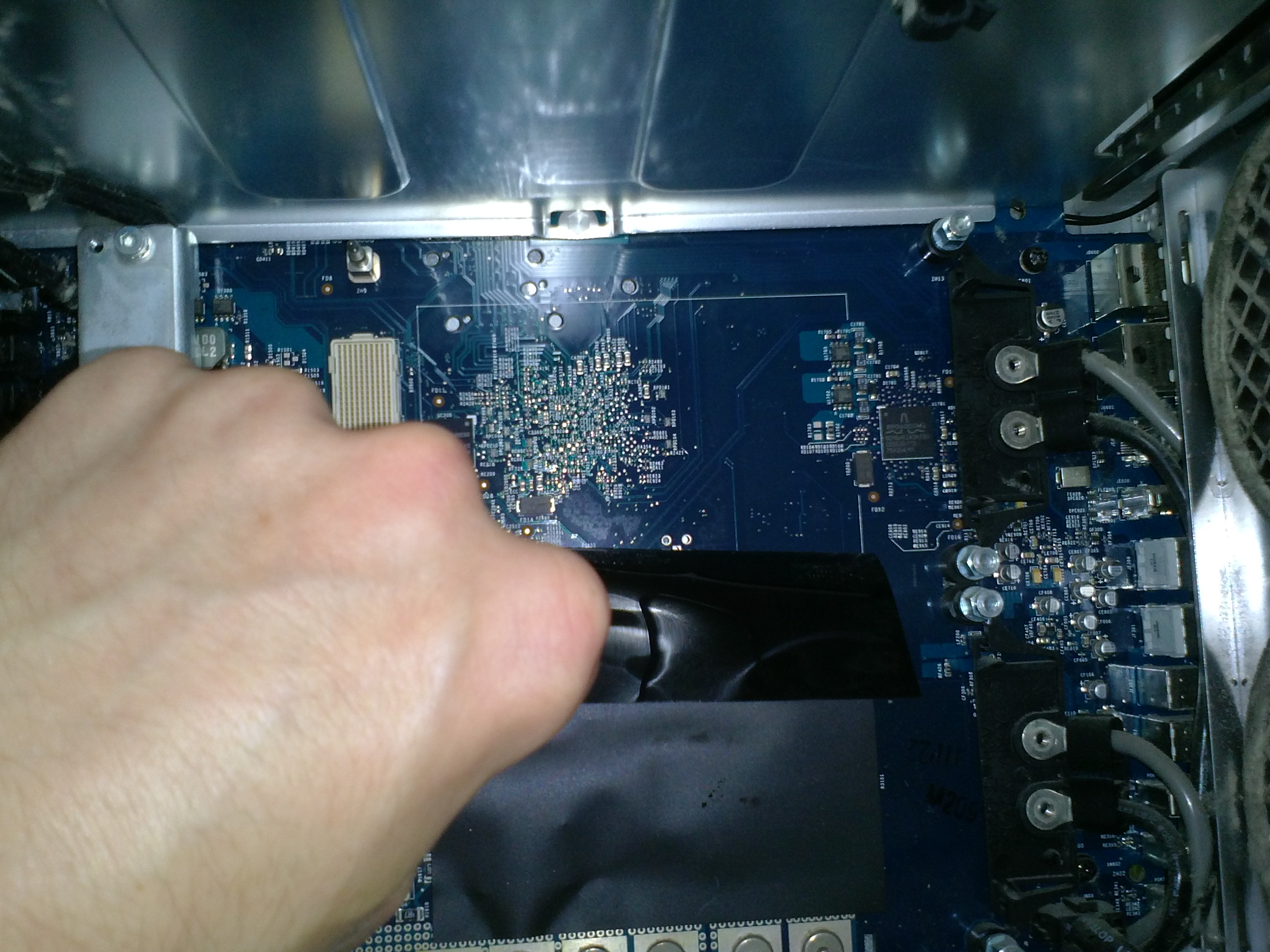

Well here's an update for you guys.
My Uncle had the tools to remove them. I am not sure why people are saying these screws are magnetized because they aren't. We used magnetic tools. It's really not easy getting in there.
There is no damage at all on the logic board. It is extremely clean, it wasn't even dusty under there.

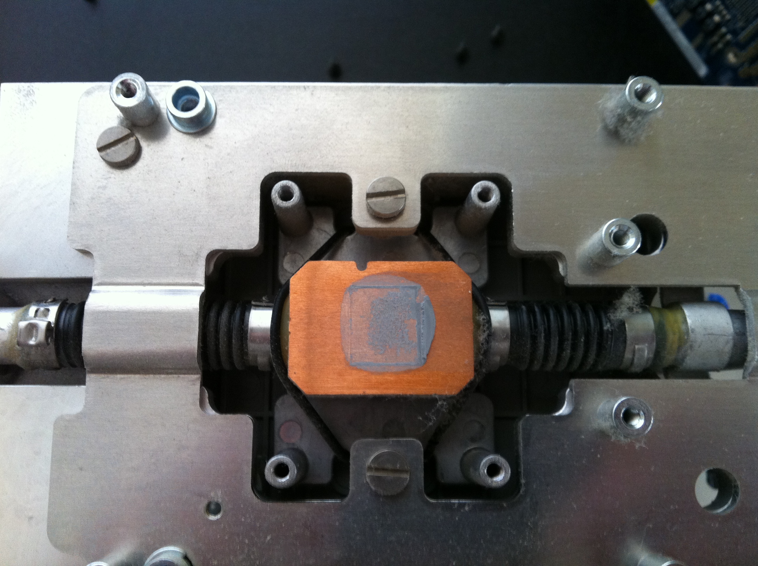

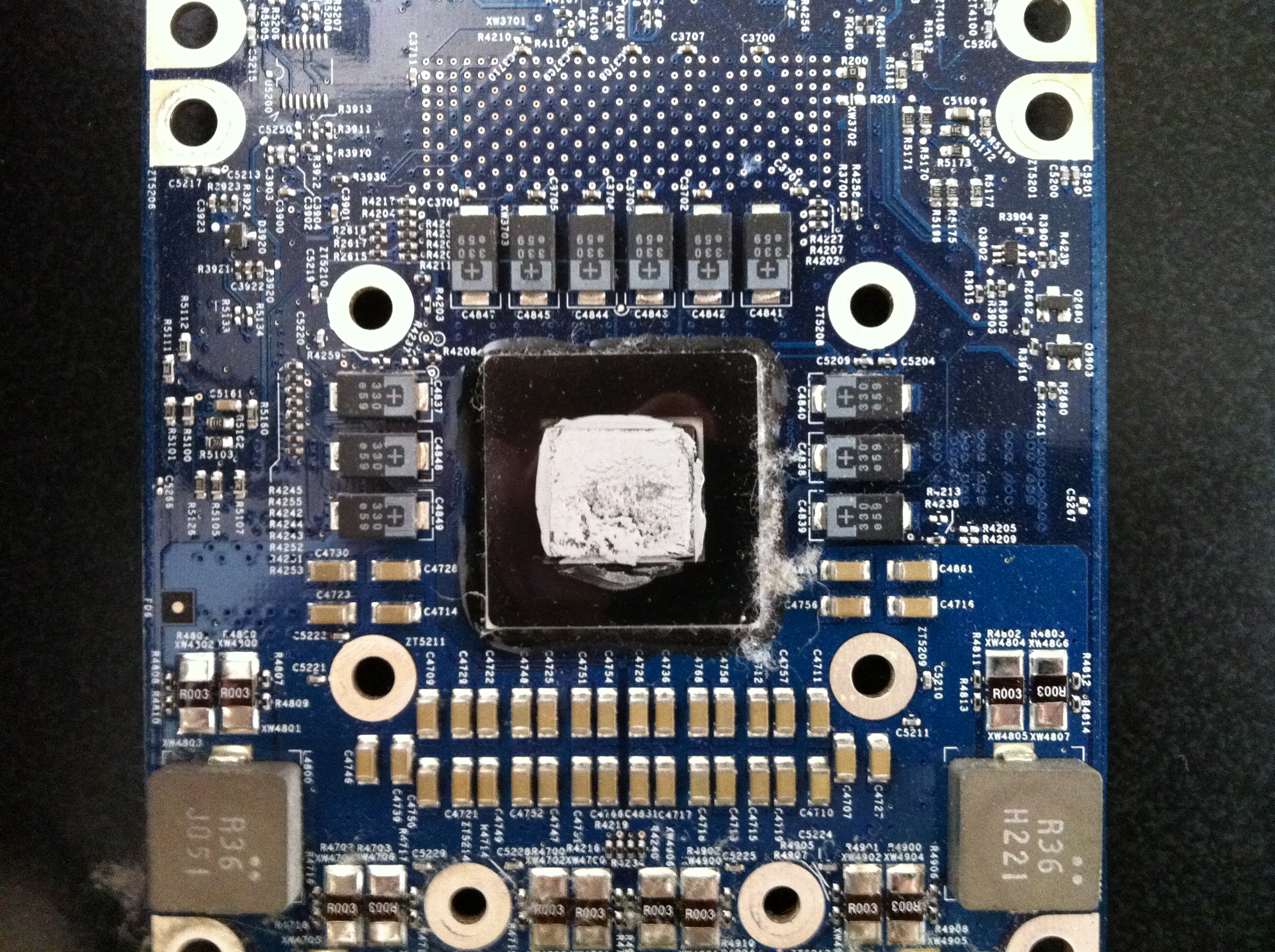

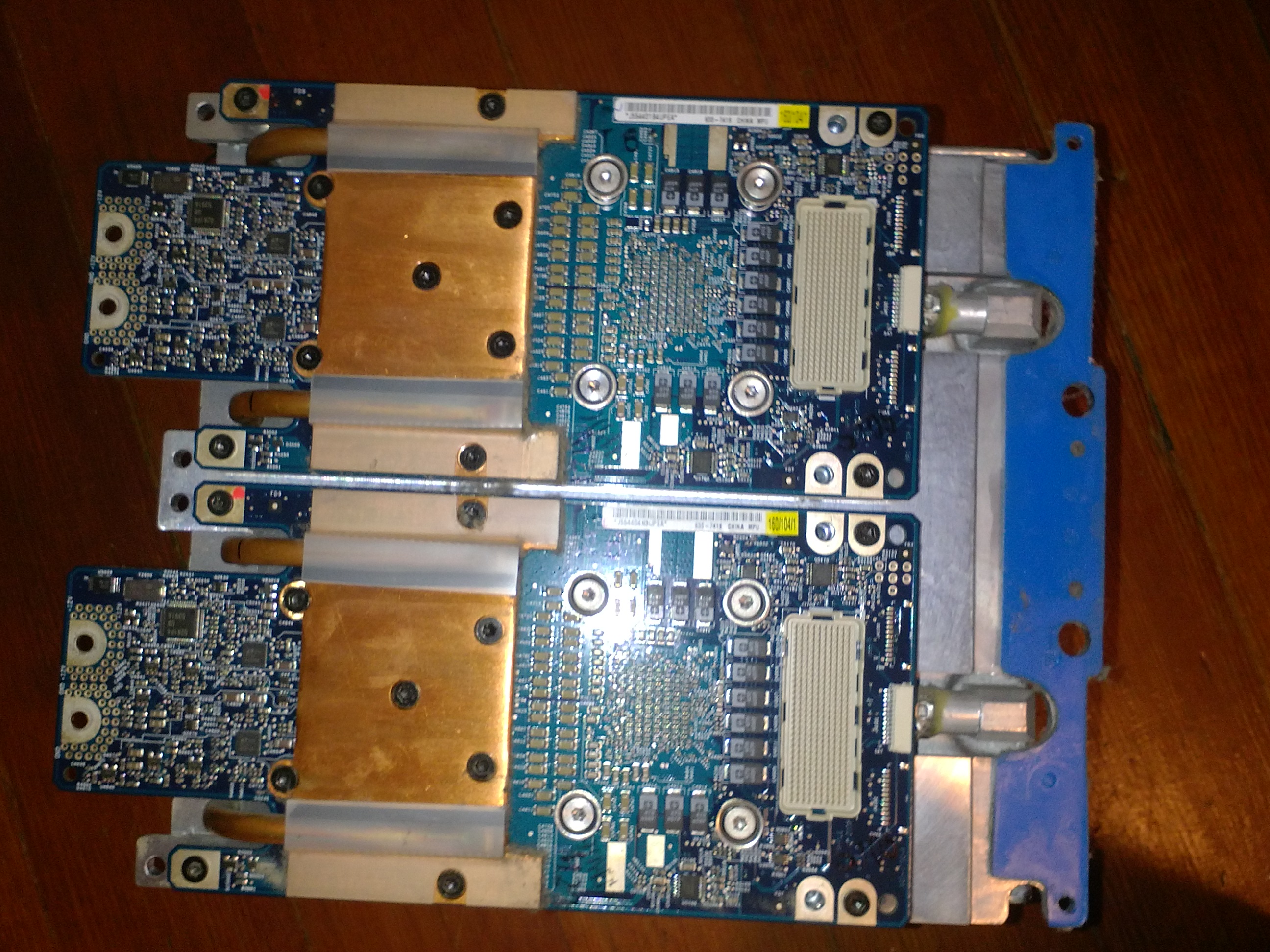

I have removed one an it's in excellent condition. Here are some pictures.
I will remove the other one and see if there's any leaks but I doubt it. This computer was used 24/7 from the day it was purchased and then for a good amount of years. Other than some scratches on the outside and a ton of dust, everything is looking good. Why won't it boot!

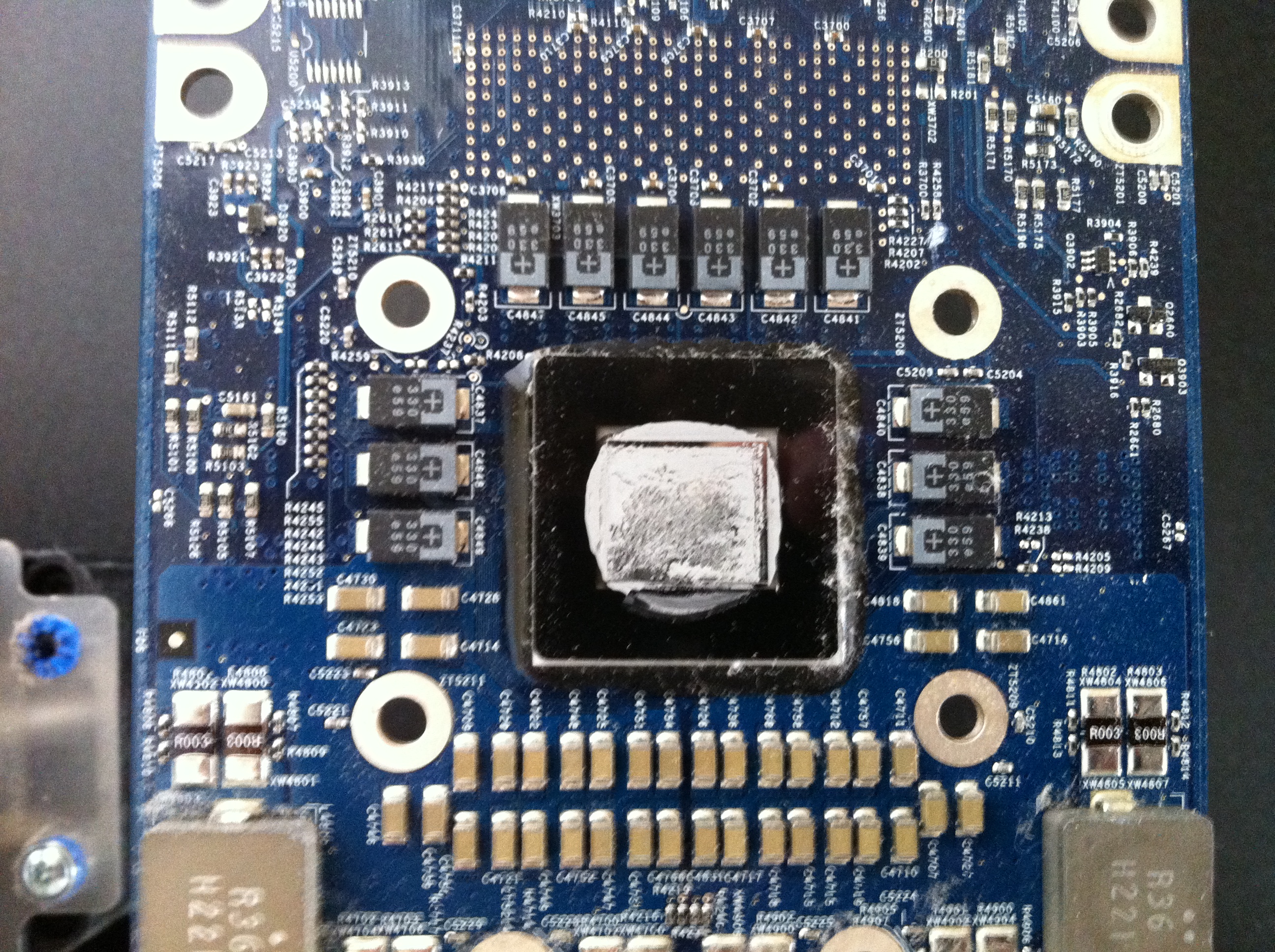

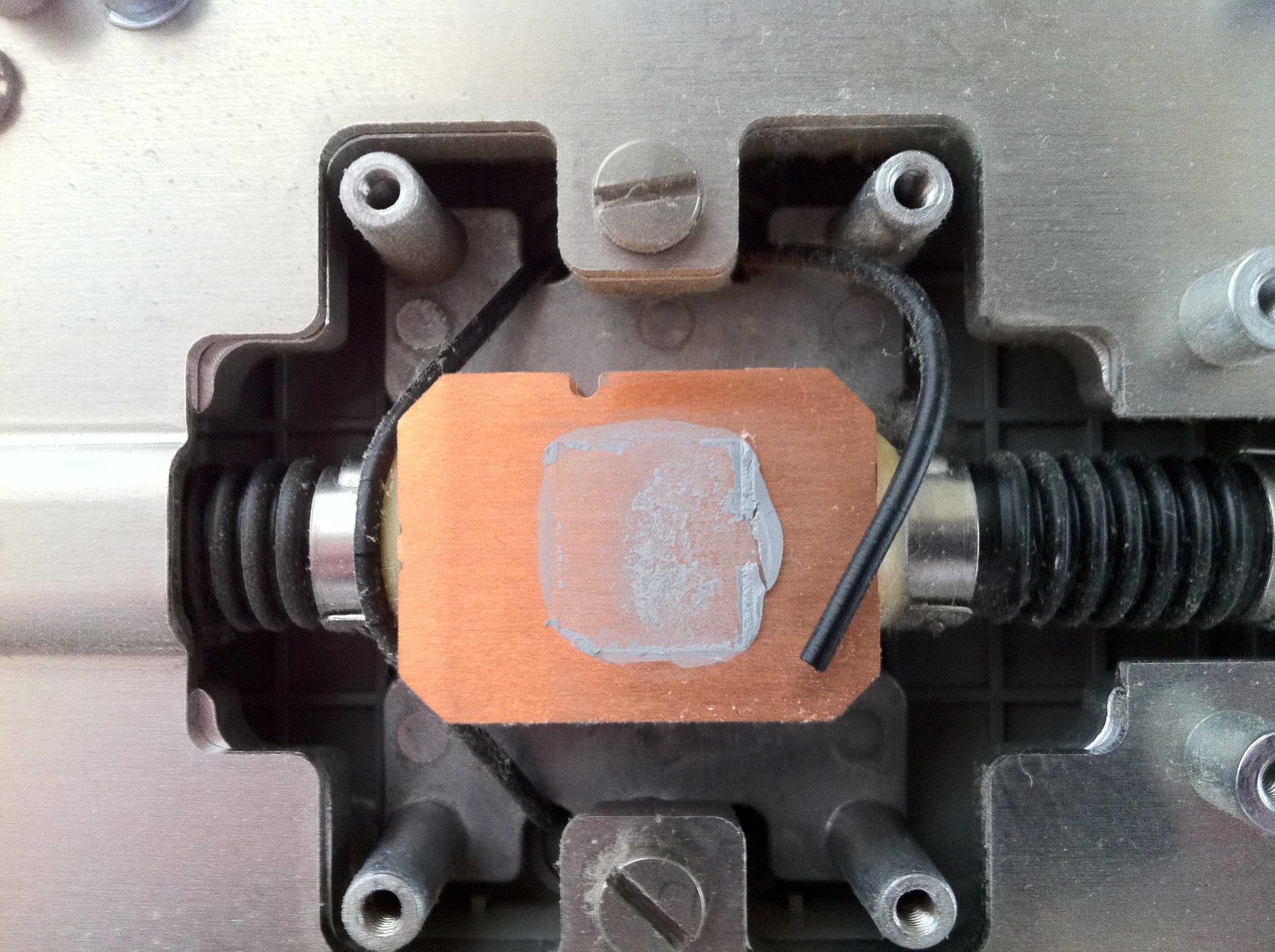

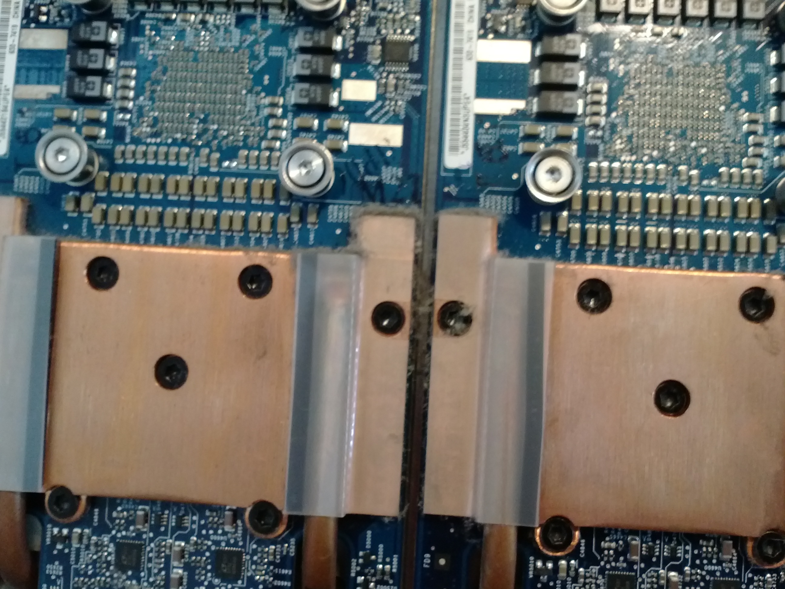

Second CPU. Everything looks good except one thing...
Is that black thing a wire or just a cable holding down the metal plate? Because this one is broken off and I noticed on the other CPU they have hairline fractures.
It looks to me just like a cable to hold down the plate.

I want to hear about this wire or cable thing though before I put it back together.

Well I will test them again when everything is reassembled. No one responded to my question. Is that just a cable holding the plate down or is it a wire? Because it's broken and the others have cracks.
