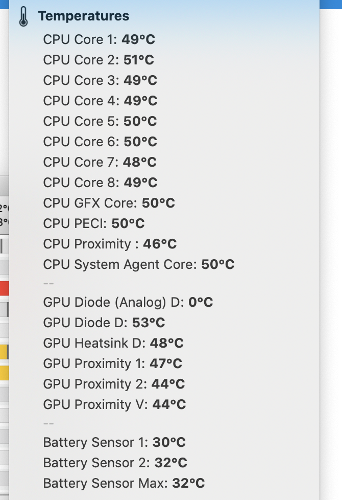

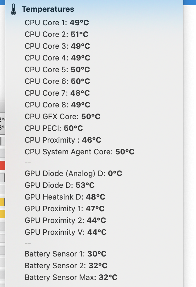

Got this from Max Tech. They can't yet measure the wattage of the Radeon High Side, iStats isn't reporting it. But he sent me his temps while browsing for an hour and plugged into an Apple 6K XDR
No word on fan speed, but I take it that it would not be loud at those temperatures.
Of course, that's for browsing the web. Gaming will most certainly rev up the fan. Even Max Tech said in his video "the [MBP's] fans were definitely louder" and "the eGPU has the advantage of being outside the MBP with a much better cooling system".
