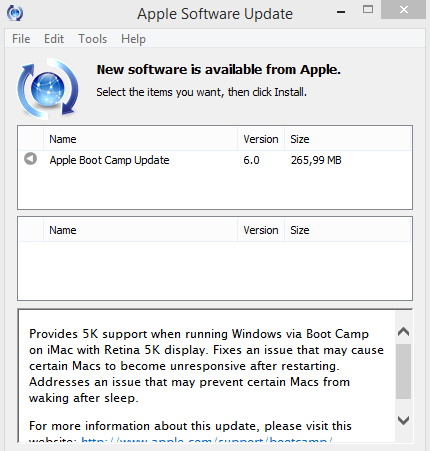

I did the update for bootcamp and it didn't do anything. It probably fixes just the 5k scaling on the new iMac, I'm still stuck with the same drivers, I keep refreshing the amd page to see if they put any new standalone driver there, either way, with enough tweaks I made the game playable at around 50-60fps on my d300 with high settings, its more than enough for me 🙂 and as long as in Mac OSX I get stellar drivers and graphics updated thoroughly, even with the base nMP model I can't complain :apple:.
