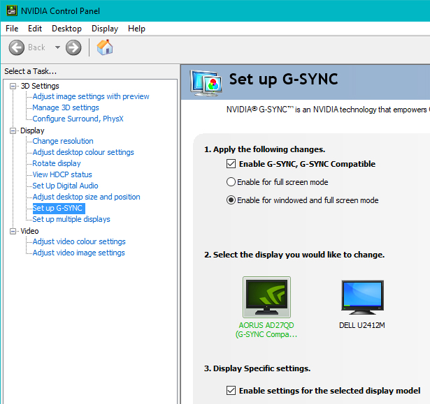

...however, in my Nvidia Control Panel, G-Sync is not even listed as an option. Now I don’t know if this is an old control panel or it’s updated.

If you've still got the HDMI cable plugged in it won't show up but it should be there if you use displayport instead.
This website says your monitor is compatible (most Freesync monitors are now).
The option is on this page:
Then he would lose HDR because it is 1.2 .
NVIDIA does not support FreeSync through HDMI 2.0 (AMD proprietary).
Time to try to return the monitor.
Or maybe one can use 2 cables and have each feature always activated on "each display".
Then DisplayPort for FreeSync and 10-bit SDR.
HDMI 2.0 for 4K 60Hz 4:2:2 HDR.
But one would still miss 4K 60Hz 4:4:4 HDR which needs DP 1.4 .
1100 euro to add adaptive sync to HDR with NVIDIA.
I’ve not noticed this at all, I have a nice smooth display. So would this be for the future when my card is getting old in the tooth? Is this why I would want to turn on G-sync of free sync? I have yet to see what the difference is between those 2 terms are (g-sync, freesync).
G-sync was the first one but Nvidia charged a fortune to license it, so few monitors used it. Then AMD came up with their own version, Freesync, which is basically identical but anyone can use it for nothing, so it's in a huge number of monitors now. Nvidia essentially admitted defeat and adopted Freesync too, although they call it 'g-sync compatible'.
The benefit isn't so much about screen tearing, since that is most common when the game updates faster than your monitor, which isn't likely at 4K. With Freesync turned off the screen refreshes 60 time per second, regardless of whether a new frame has been sent by the graphics card. So if the game is varying between, say, 50 and 60 frames per second, you'll have some frames that stay on screen for one cycle (1/60 s), others that stay on screen for two cycles, and others that might miss their 'slot' and not get displayed at all. Which will manifest as visible choppiness or stuttering.
You can test it by turning off v-sync in the game's settings, then moving the camera across scenes of varying complexity. For example, you pan across the sky and it's very smooth, then you pan across a busy street and it's jerky.
Freesync sorts that out by updating the monitor only when there's a new frame sent from the graphics card, so if the game varies between 50-60 fps, the monitor will change frequency accordingly. It looks really good, it's compatible with pretty much any game, and it means you don't have to drop so many settings to stop the game stuttering.
Anyway, good luck with it! Some people are more sensitive to this stuff than others, there are plenty who prefer to just turn up the settings and have the game run at a steady 30 fps.
