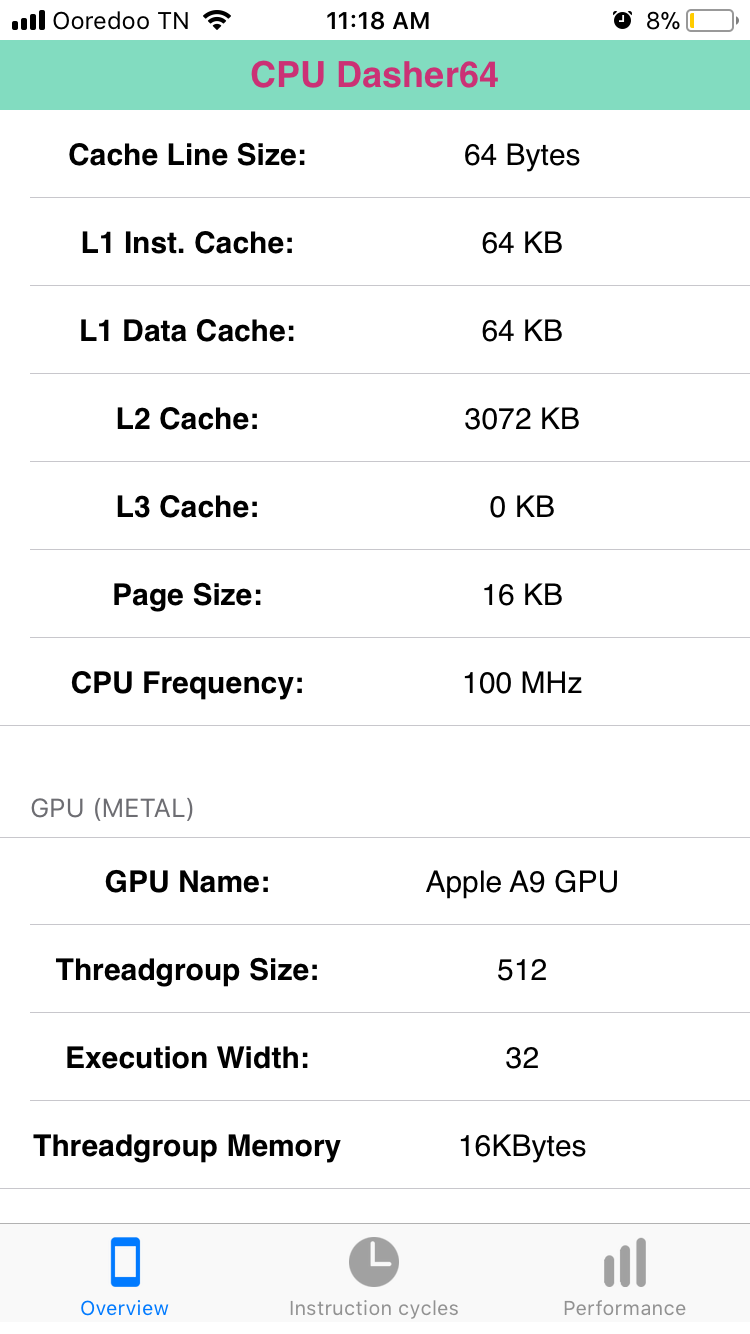

If you’ve got a 6S at 1848 that’s currently running well, you can easily prove to yourself that what I’m telling you is true. Turn on battery saving mode and your CPU will drop to 911MHz. You will be surprised how little difference this makes in most real world usage. Go ahead, try it!
At 911MHz (CPU dasherx): I’ve got 50 tabs open in Safari and the animation while scrolling through the tab interface is nearly flawless, with some stuttering if I try to scroll super fast. My typing while I write this post is instantaneous, with suggested words popping up immediately. I’m sure you’re amazed at just how well your 6S is still running, aren’t you?
The fact is 1848MHz is such overkill for most of what people do, that dropping to 900 is barely noticeable. Of course games and other demanding tasks can use all the CPU they can get. But the kind of typing lag you talk about has nothing whatever to do with a downclocked CPU.

Anyone who has an issue with words taking 30 seconds to pop up has problems way beyond a CPU being downclocked from 1848 to 600MHz. Sure, the CPU is operating at 1/3 the speed, but that won’t affect typing input. Otherwise words would still take 10 seconds to pop up when the CPU is at 1848, right?

My 6s has 199 cycle battery and 90% wear ! Cpu maximum clock is 911 mhz, and 600 mhz just after 70% ! All this, doesn't really matter for me, but what it does, is the below 10% of battery, cpu fall down to 100 mhz ! And make the phone unusable, you can't even tap the passcode and phone calls are like parasites where you can't even make your voice heard ! This unaccaptable
