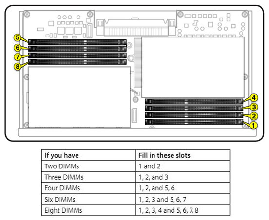

[doublepost=1468047865][/doublepost]Here is what Apple says about these machines:
Each processor’s memory
controller has three
memory channels. DIMM
slots 1, 2, 5, and 6 have
their own channels; slots
3 and 4 share a channel
and slots 7 and 8 share a
channel.
For optimal memory
bandwidth, all six memory
channels should be used,
and memory should be
balanced across the six
channels."
See "https://manuals.info.apple.com/MANUALS/0/MA918/en_US/Mac_Pro_2009_2010_Memory_DIMMs_DIY.pdf".

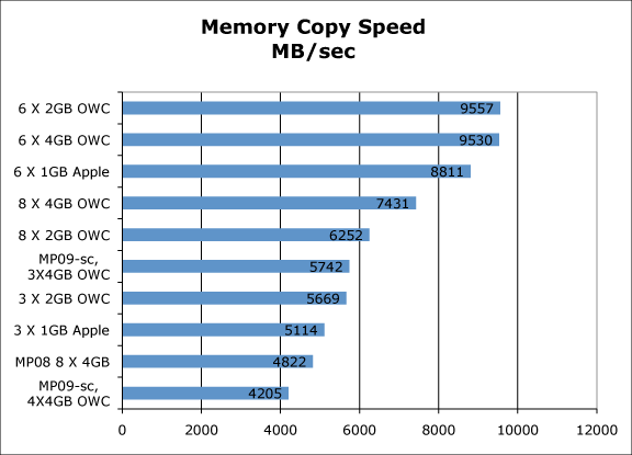

[doublepost=1468048177][/doublepost]Also have a look at this comparison test of balanced vs. proper triple-channel setup in terms of memory bandwidths:
http://macperformanceguide.com/Reviews-MacProNehalem-Tests-Memory.html
Quote: "
Memory copy speed is 52% faster with six modules instead of eight (triple vs dual channel);
Double-sided modules are about 10% faster than single-sided modules;
Six modules is 68% faster than 3 modules (this might not matter if only a few cores are in use, but consider the 4-core Mac Pro with only 4 memory slots);"

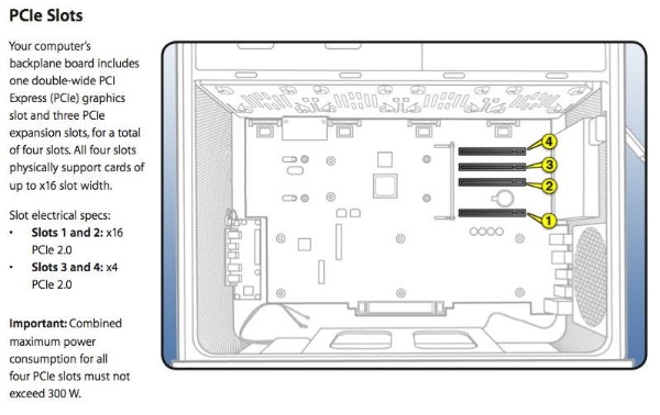

The 4.1/5.1 has 2x16 slots and 2x4 there are no x8 slots so not sure where you are coming from on that one re GPU performance.

It seems that you are quite new to Mac Pro, or Mac.
1) There is no tools to OC the CPU, regardless in Windows or OSX. Unless you can develop one, there is no way to do that, no matter safe of not.
2) How do you know the chipset is 5500? You remove the NB heat sink and check the chipset model? And no matter what the chipset is, there are 2 x16 slots and 2 more slots which share x4 bandwidth, but physically support x16 PCIe card.
3) My test shows that a HD7950 has about 2.4% performance penalty by installing in the x4 slot. That's inline with your result. I put my 2nd 7950 in slot 3 for much better cooling. However, if no specific reason, it's always recommended to put the GPU in slot one. That can avoid the graphic card blocking another slot.
4) GeekBench is just a benchmark, that may be much to do with the real world performance. Not optimising the triple channel can take a performance hit, some background process can cause lower score. As long as the score is within 10% variation, I will say that's a good enough proof that your Mac can perform normally. No need to chase the highest score.
5) 45C and 36C looks quite normal to me (depends on the ambient temperature), I doubt if you can make any significant improvement by re-applying the thermal paste.

Would splitting up my memory sticks right now from only using 1-4 to using 1-2 and 5-6 make an impact right now? I will have to wait until next month to get more. I spent all my available money already getting what i have right now.
Maxx Power
Cancelled
Apr 29, 2003
861
335
Here is where i got the chipset from:
https://en.wikipedia.org/wiki/Mac_Pro#Specifications
I am fairly certain it would result in an increase in memory bandwidth, I think. Apple actually recommends that if you have only 4 DIMMS, spread it across 1-2 and 5-6 in the user manual.
E.g., like this according to Apple's memory upgrade manual:
What I am not certain of, is how this will change the Geek Bench scores. Presumably it will go up...

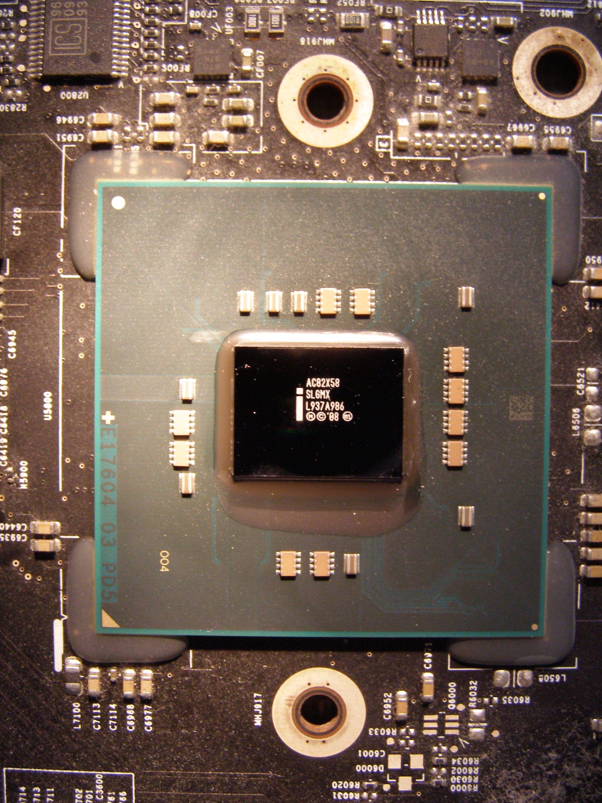

There was a guy here who actually remove the NB heatsink and took pictures of both the single processor and dual processor cMP, from memory, end up the chip are different. And the picture clearly show the chip model number. May be the search function can help to locate that thread, and we can have a more accurate info than WiKi to work on.
Reactions: Zaithe
Maxx Power
Cancelled
Apr 29, 2003
861
335
The single processor and multi-processor chipsets are indeed different. I think the single proc uses the X58 chipset while the multi-proc uses the 5500 series (could be 5520, which has more PCI-E lanes that are x16).
Found it for you (multi-proc 2009 MP):
p3164535-jpg.621459
Single proc 2009 MP:
p3134526-jpg.621003
p3134526-jpg.621003[img]
Reactions: Zaithe
p3164535-jpg.621459
p3134526-jpg.621003
Thanks! This is exactly what I want to find. And 5520 has 36 PCIe 2.0 lanes, so, that perfect match the cMP's config. 2 independent x16 slot + 2 slots share the rest x4 lanes. Which obviously the 5500 cannot do with just 24 lanes.

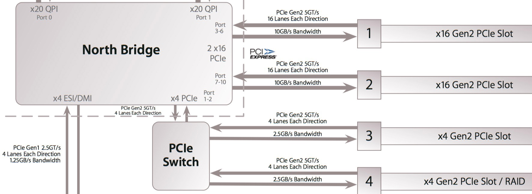

Thanks! This is exactly what I want to find. And 5520 has 36 PCIe 2.0 links, so, that perfect match the cMP's config. 2 independent x16 slot + 2 slots share the rest x4 links. Which obviously the 5500 cannot do with just 24 links.
Has anyone checked the multi-CPU chipset for the 5,1 model? 2 x16 slots plus 2 x4 slots would be 40 lanes. Take one of those slots away and you have 36. So theoretically it seems the chipset can't support all it's slots using full capacity let alone a PCIe expansion kit to add more slots.
h9826790
macrumors P6
Apr 3, 2014
16,628
8,558
Hong Kong
The chipset is 5520 as per the picture. And if you read my post carefully, I said twice, slot 3 and slot 4 SHARED the same x4 PCIe lanes. So, only 36 lanes required in total.
Slot 3 and 4 are connected via a PCIe switch. Slot 1 and 2 are independent, but 3 and 4 are not.
