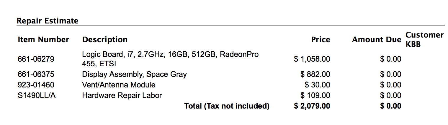

Hi,
Just want to let you guys know. If you are experiencing such strange noise. Try to put your MBP under-load, and film the popping sound. For example, running games or pushing 4k videos on 2 displays. My advisor didnot check much, he watched the video and book my MBP for repair right away. Here is the estimated fixing cost. Hope this can help.
Im also experiencing display click (sound) when opening, and keyboard. 🙁
Screen Shot 2018-02-05 at 4.08.39 pm.png (AUD)
Cheers
I had the same issue both popping and display click. Apple ended up replacing my display assembly, vent/antenna, & top case (w/2017 keyboard). So far there's no popping noise or display click so I'm hoping it'll stay that way. Why'd they had to replace your logic board?

Update:
After the first repair (Logic board the whole lot), still experiencing the same problem.
Second attend, replaced the logic board again (no idea why), and top case including battery, speaker etc, still experiencing the same problem.
I wonder, the problem can't be fixed maybe 🙁. Do you guys think they will replace my MBP or third attend to fix it.
