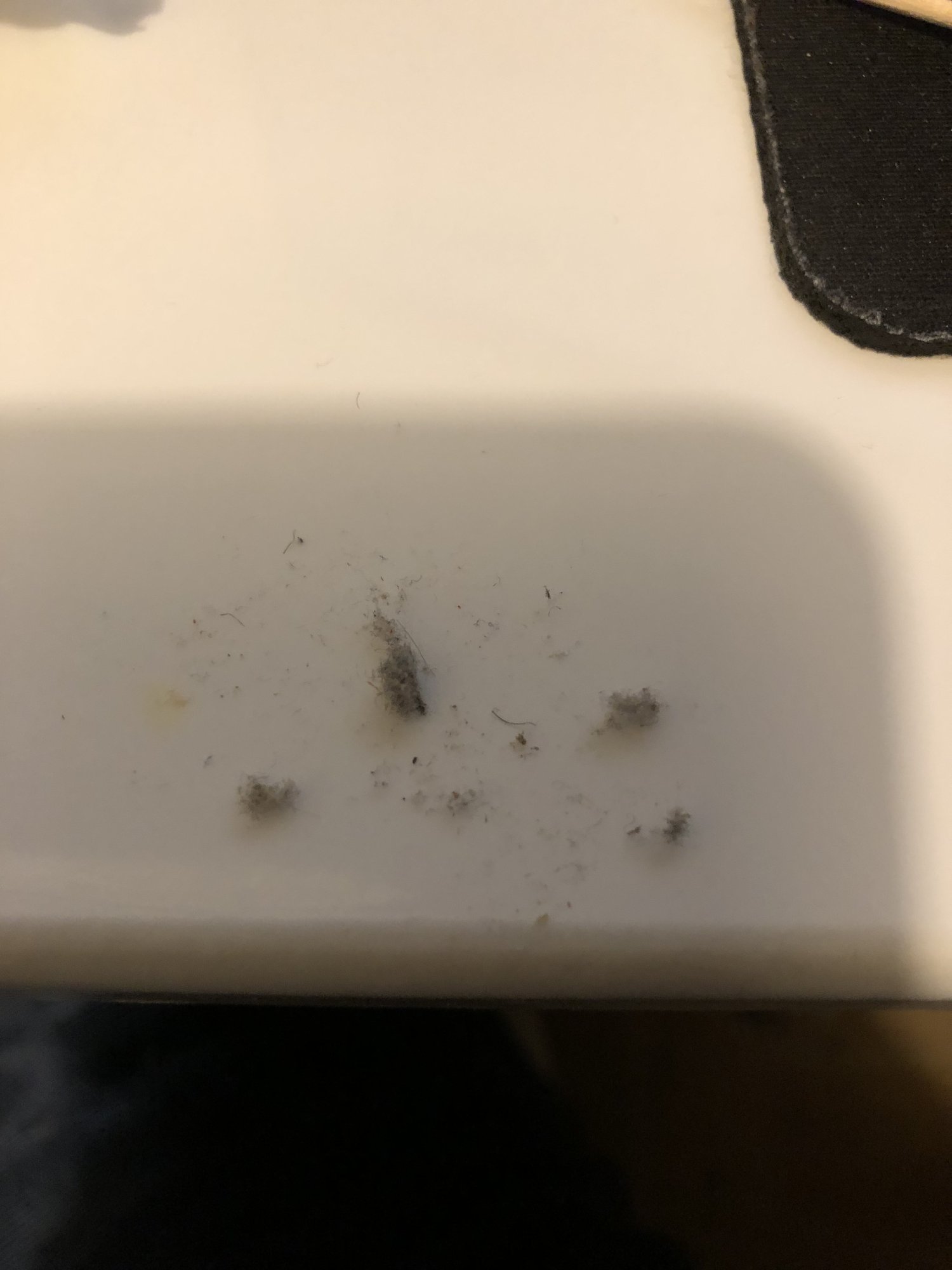

The toothpick cleaning seemed to work. I did this as gently as possible WITH THE PHONE BEING SHUTDOWN completely.
Usea plastic pick. Shutting down is unnecessary and doesn’t do anything.
However, next time If I plan on cleaning the lint from the connection port with a toothpick again, how do I exactly position and move the toothpick so that I avoid scraping the contacts or to avoid damage to the connection port?
I think you’re overthinking this. Just go a bit all over the place. The contacts are along one side; use a flashlight to see which, but they are in my experience very robust.

I recently had been charging my iPhone 14 Pro and noticed that when I move the phone around while the phone is charging the charging stops and then charges again. Then when I move it around again, no charging takes place.
Yesterday, I took a toothpick and very gently scraped off some lint from the charging connection port and quite a bit came out. Hopefully I’ll see an improvement.

Check the lightening port on the iPhone, it might be backed up with lint from your clothing. My iPhone X was doing the same thing, used a toothpick to clean it out and now it charges without issue.

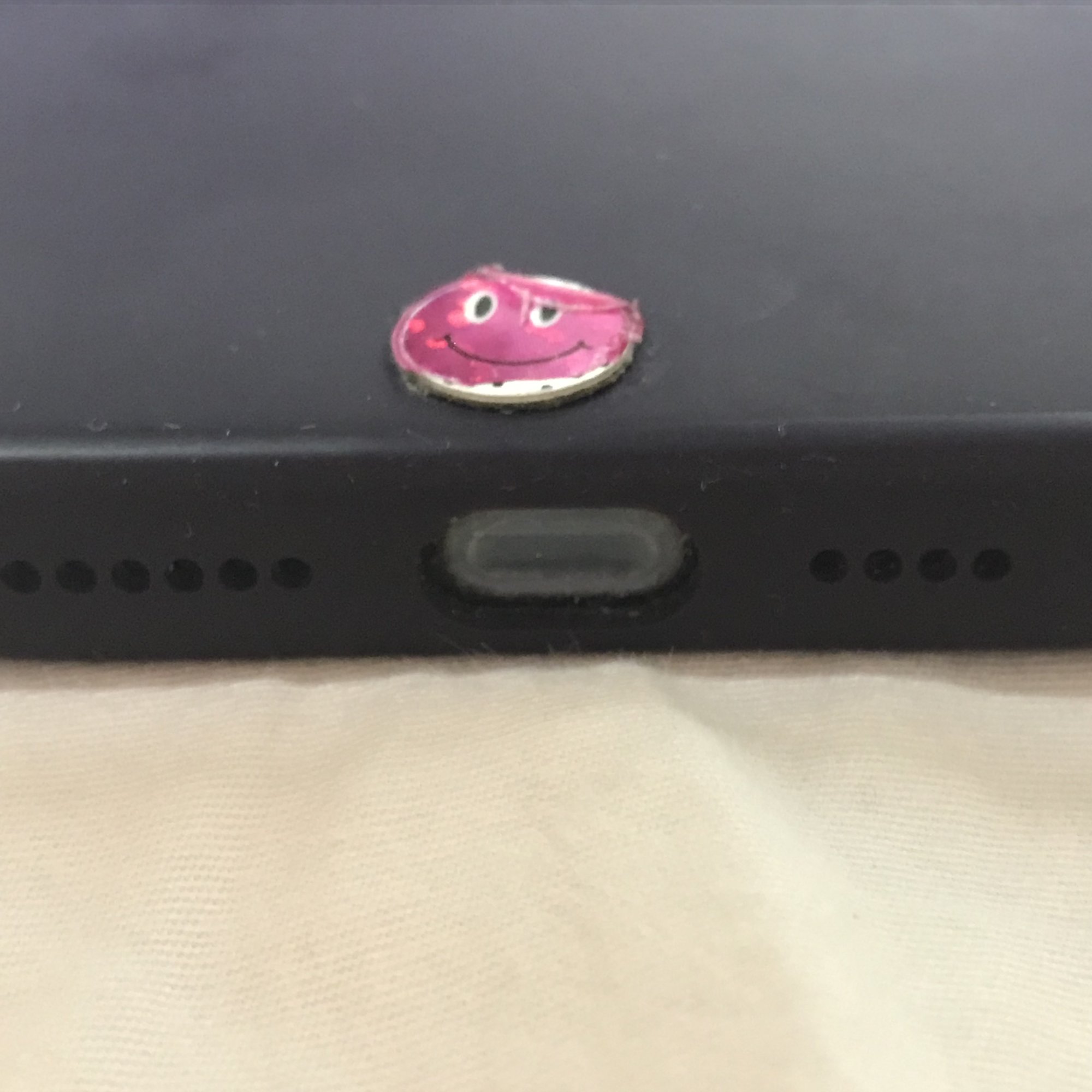

use a clear plug or translucent color. As you can see the Lint or garbage that was around it. And I don’t even stick my phone in my pocket. These things are just dust collectors regardless of where you put these things. I highly recommend using this plug. Also you can even buy other types that you can flip up One and is attached to the phone with a sticker while the silicone part sticks into the phone. all you do is flip up the silicone plug up while the other part is attached to the phone with a sticker. so if you want a charger cord in there you can use it without losing the plug. All the best to you.
