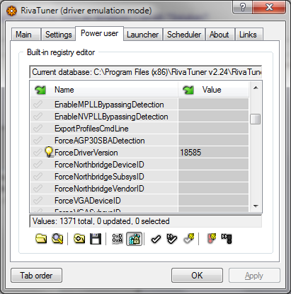

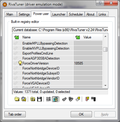

In Rivatuner, go to the Power User tab. Deselect the Hexadecimal Display button on the bottom. Then go to RivaTuner \ System > ForceDriverVersion and put in your driver version with no period (18585 for most recent). You'll probably have to reboot after that.
After rebooting, it will still say "No supported drivers...", but you will be able to click on the customize button now.
I don't know whether or not it actually works properly after forcing the driver. I haven't yet compared different settings to see if the clock speeds actually change.
Cheers, that did the trick dude 🙂
