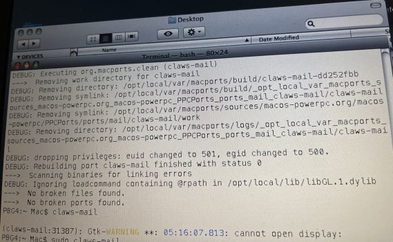

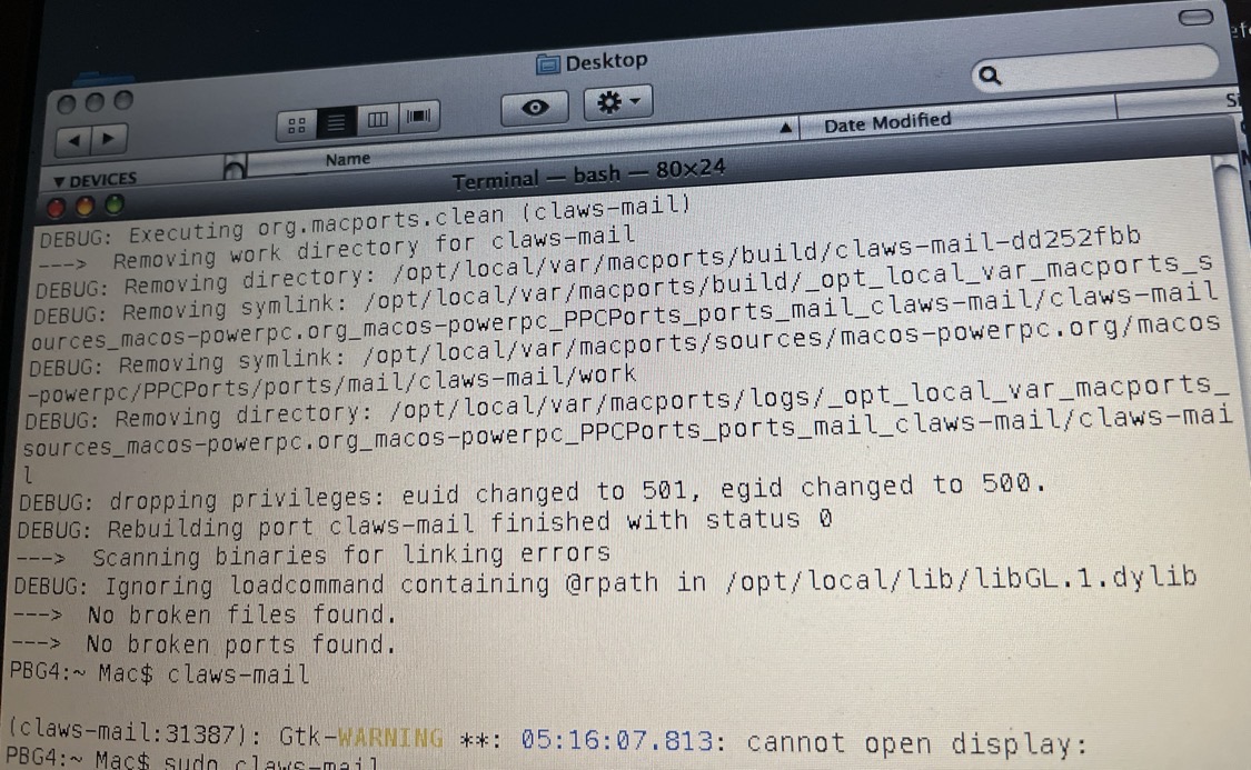

First of all thanks for taking the time to answer me. Idk why I feel I may even be missing on the basics, way bellow all that you wrote to me.
Here is the output on claws-mail, after installing the pack ready for 10.5...and having to deal with the sudo part like before
I didn't do port-sync this time
sh-3.2# claws-mail
** (claws-mail:663): WARNING **: 22:40:48.350: failed to open directory: /opt/local/etc/skel/.claws-mail
/var/root/.claws-mail/clawsrc: claws_fopen: No such file or directory
prefs.c:126 Condition pfile != NULL failed
traceback:
0: 0 claws-mail 0x001843f8 prefs_file_close + 80
1: 1 claws-mail 0x00183a7c plugin_load_all + 184
2: 2 claws-mail 0x001e3bd0 main + 5284
3: 3 claws-mail 0x0000d380 start + 68
4: 4 ??? 0x00000001 0x0 + 1
/var/root/.claws-mail/menurc: claws_fopen: No such file or directory
(claws-mail:663): Claws-Mail-WARNING **: 22:40:48.360: can't copy /var/root/.claws-mail/menurc to /var/root/.claws-mail/menurc.bak
/var/root/.claws-mail/addrbook/addrbook--index.xml: fopen: No such file or directory
/var/root/.claws-mail/addrbook/addressbook.xml: fopen: No such file or directory
/var/root/.claws-mail/toolbar_main.xml: fopen: No such file or directory
During instalation I saw some openjdk7 "errors" but it finished, if important I will re-do it
Before I go try to uninstall x11 or quartz (not even sure if I have them) may explain to me:
if someone has prebuilt port, how do I know/make sure the command is taking advantage of it and not compiling everything?
Giving my config should I add anything to any configuration file?
During the rest of the week I will do my best to give more feedback.
Thank you all
Sorry, if you are using some pre-compiled version on 10.5 (ppc) or a packaged installer, the questions should be addressed to whomever made that. I have no idea about what it is doing.

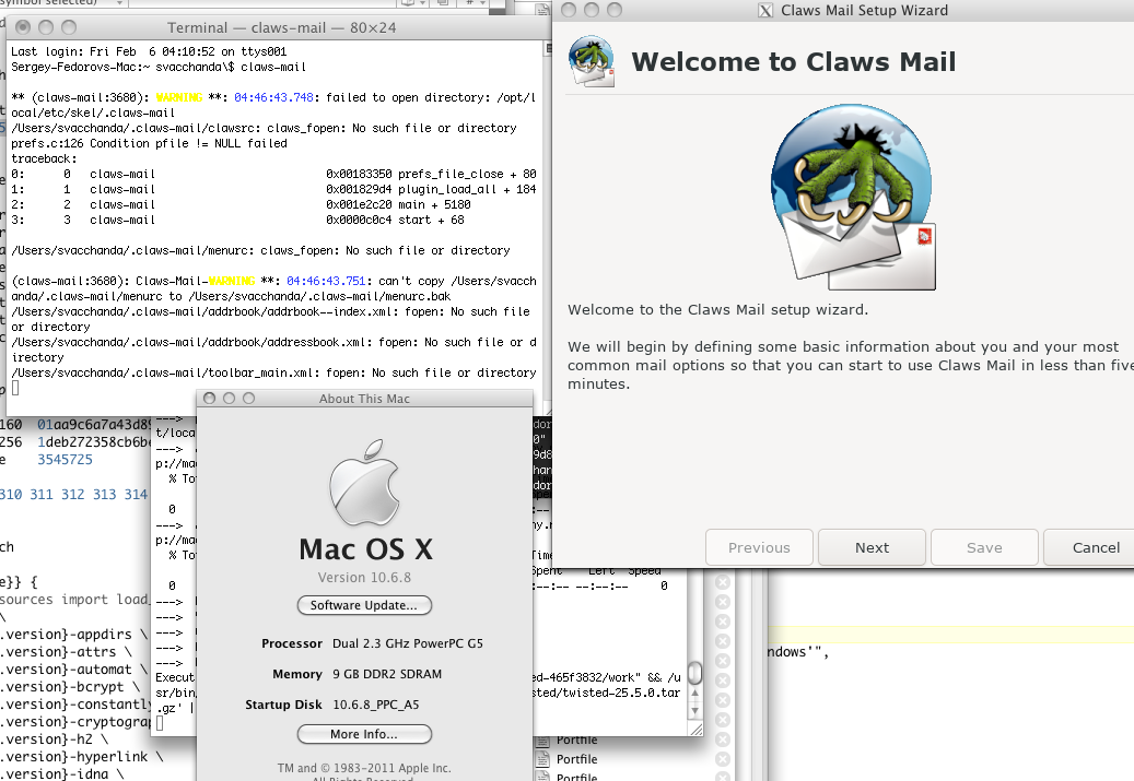

sh-3.2# claws-mail
traceback:
/var/root should be a directory for temporary files for the root user. Are running the app as root? Any special reason to do that?

Claws-mail build ok from sources
Now I get the error cant open display. I believe because I don’t have x11 installed.

Thanks.
It was ghostscript.
should it install from where ?
On modern powerpc systems: `sudo port -v -N install xquartz` or `sudo port -v -N install xorg-server-legacy`
On 10.4: `sudo port -v -N install xorg-server-1.18`
Then reboot.
