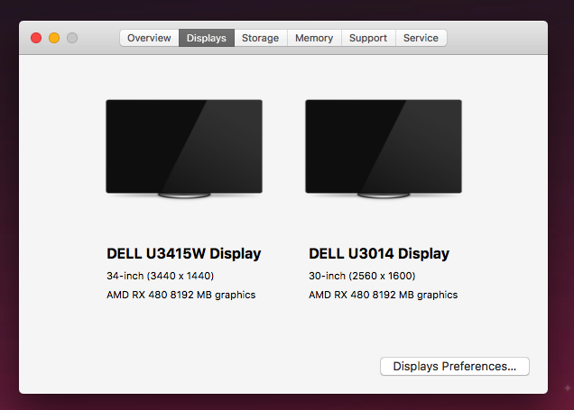

Well it started to work like awesome .. basically the problem was not with the graphics card but with the monitors . i had to turn off the DisplayPort 1.2 from the settings on both of my monitors and Voila , the card start to work with both of my display now the thing that remains is that how can i know that my card is running with it possible full potential

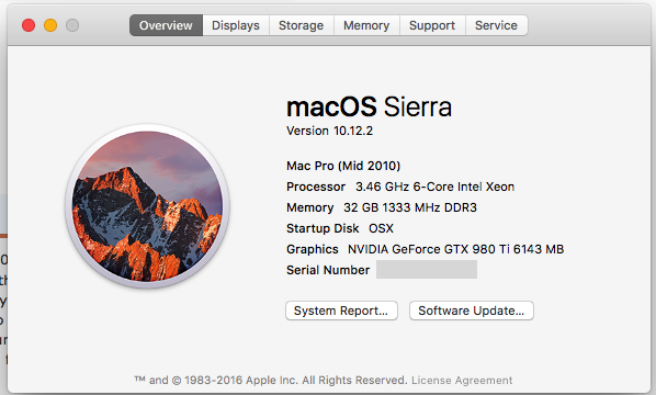

[doublepost=1484670386][/doublepost]btw m i the only one that i able to see the boot screen with RX-480 and 980ti ???
Reactions: h9826790
Glad to hear you figured out the culprit with the monitor. What you see is not really the Boot screen. It's only the last stage of boot.

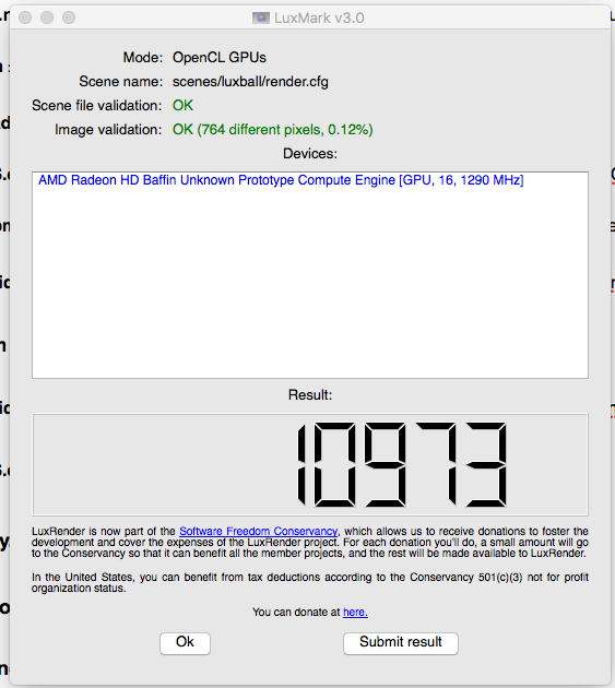

are these good enough scores ?

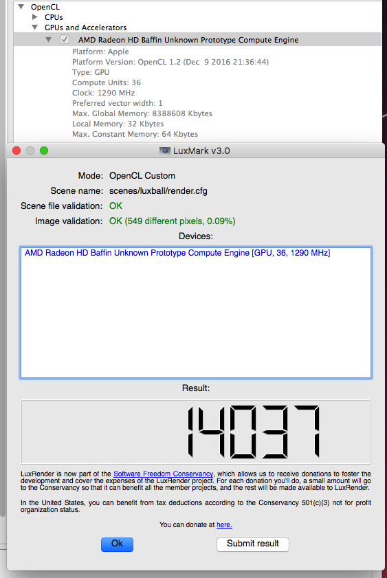

You can run the CUs unlock script to enable all 36 CUs on an RX 480. The OpenCL in Luxball will be in 14,XXX.
https://forums.macrumors.com/threads/amd-radeon-r9-fury-x-in-mac-pro-5-1.2024656/#post-24131168
