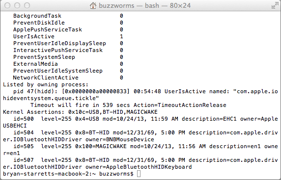

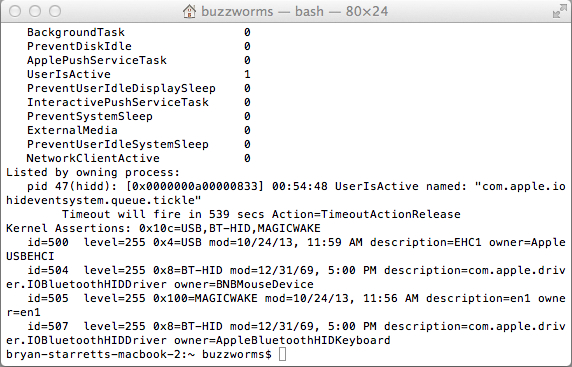

MacBook late '08 slow to sleep
This is Greek to me. Does anyone see anything here that might cause my MacBook to take 1m> to sleep? It's connected to a cinema display & bluetooth keyboard if that makes a difference.
