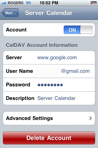

On your iPhone, go to: Settings> Mail, Contacts, Calendars> Add Account...> Other> Add CalDAV Account>
Now type the following:
Server: https://www.google.com/calendar/dav/you@gmail.com/user/
Note: if you are trying to sync a secondary calendar, use this URL
Server: https://www.google.com/calendar/dav/[string of numbers and letters]@group.calendar.google.com/user/
username: YOUREMAIL@gmail.com
password: ******** your Gmail password
description: Whatever you want to call your calendar - I just titled it Server Calendar

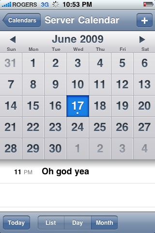

The results: when you post an event from your iPhone to the CalDAV calendar, it will be posting straight to the Google calendar on the server. If you happen to have that calendar also synced to Sunbird or some other calendar application, the event will sync to Sunbird. In this way, it's a good alternative to paying for MobileMe, since it acts like a push calendar.

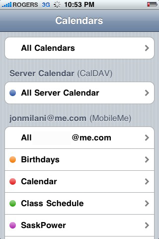

Screen shots to illustrate what I'm talking about:

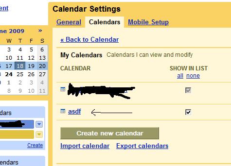

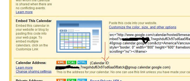

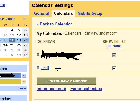

So there is this mention of a string of characters when you are trying to add a secondary calender. I do not see that anywhere in any settings. Where do I get this information from. I have my own hosted version of gmail and google apps. I successfully set up my own calendar but can't seem to add any of my colleges calendars. Why is this so damn difficult? I mean up into this calDav support the cal app on the iphone was like carrying around a dead body. You would think they would have made it just a little bit easier to set up. Oh and don't expect to find anything in Google's horrid help center....
I assume you've managed to navigate to Settings> Calendars>
Once there, click on the calendar you are trying to add via CalDAV. Once you're viewing the information for the secondary calendar, simply scroll down to toward the bottom and you'll find the ID.
I've attached a couple screenshots of my Google apps calendars (I just made a temporary one to illustrate the point).
